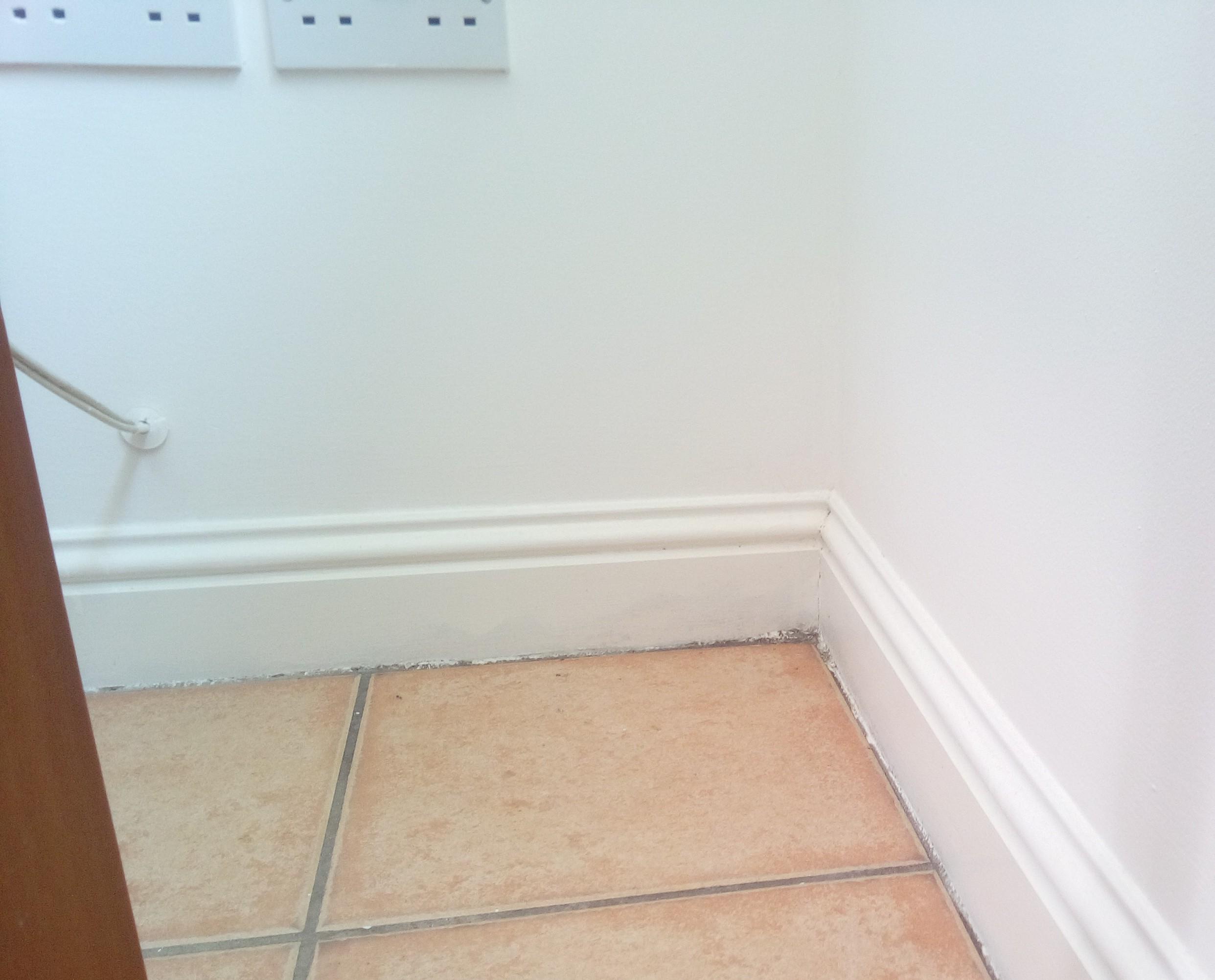

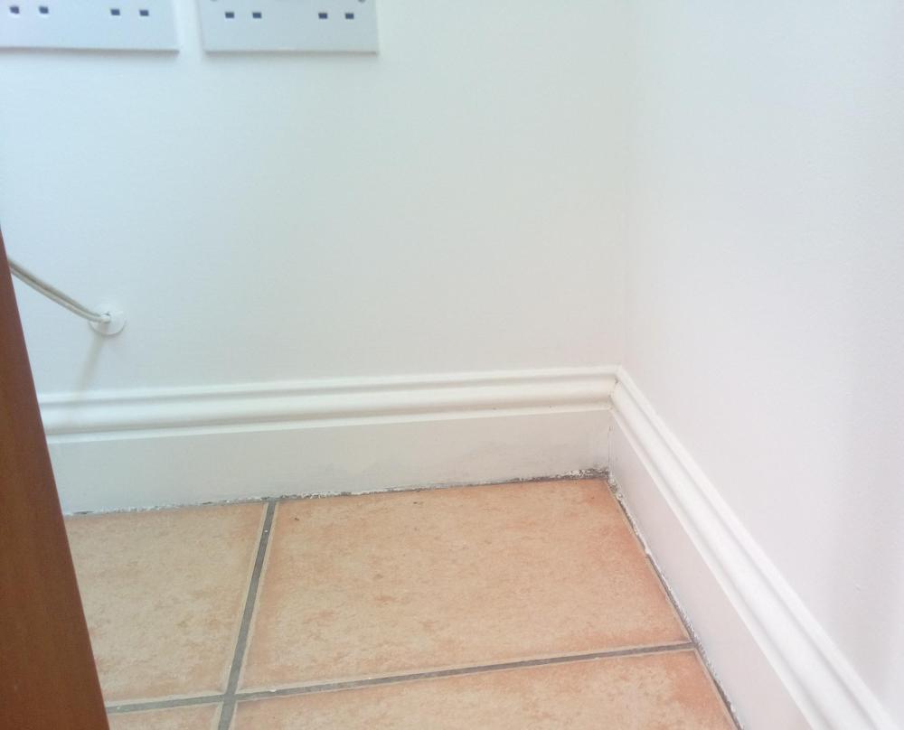

On the pic below a view of a corner where on one side the skirting board has been removed, Unfortunately not really space to add anything there.

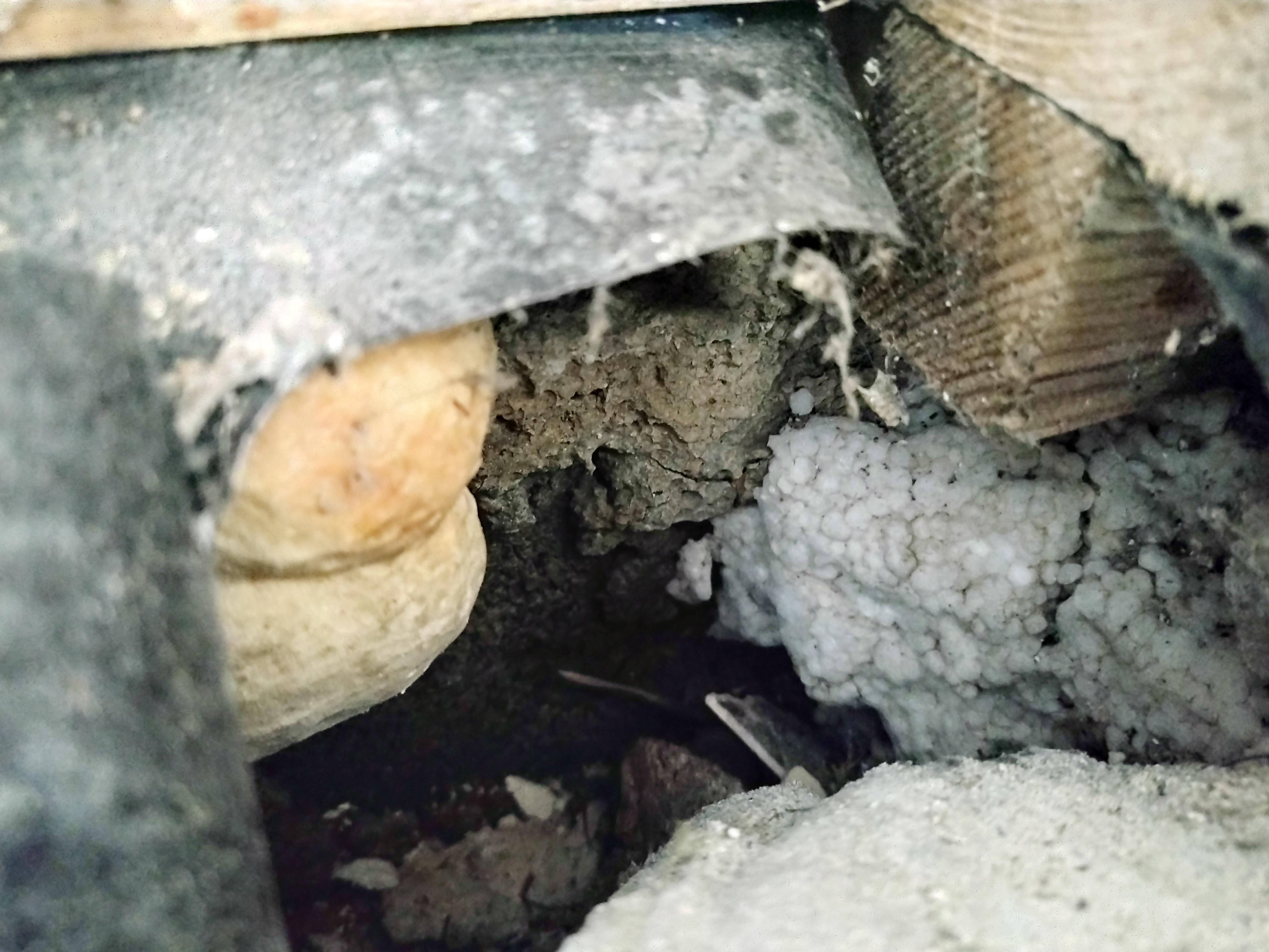

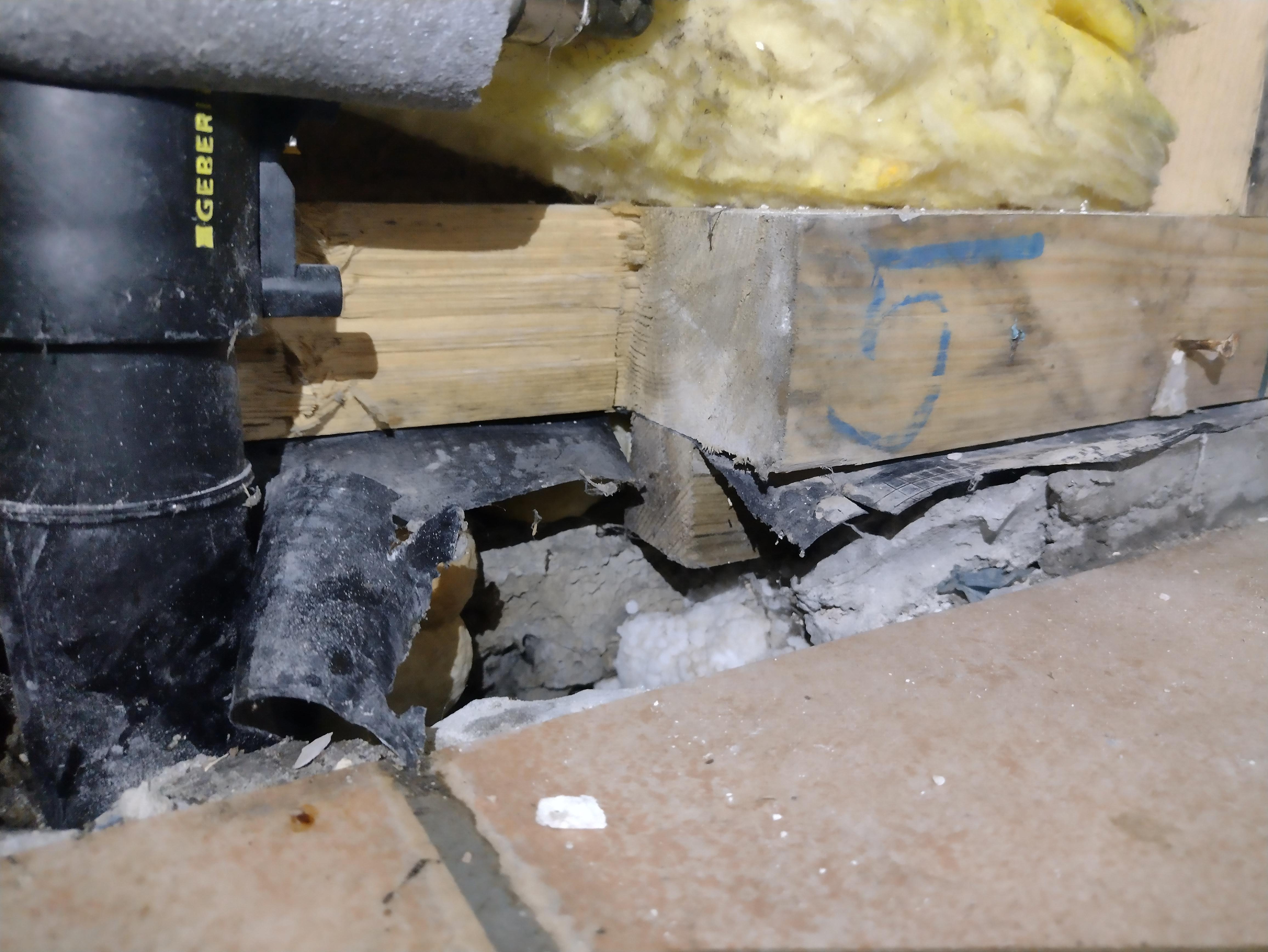

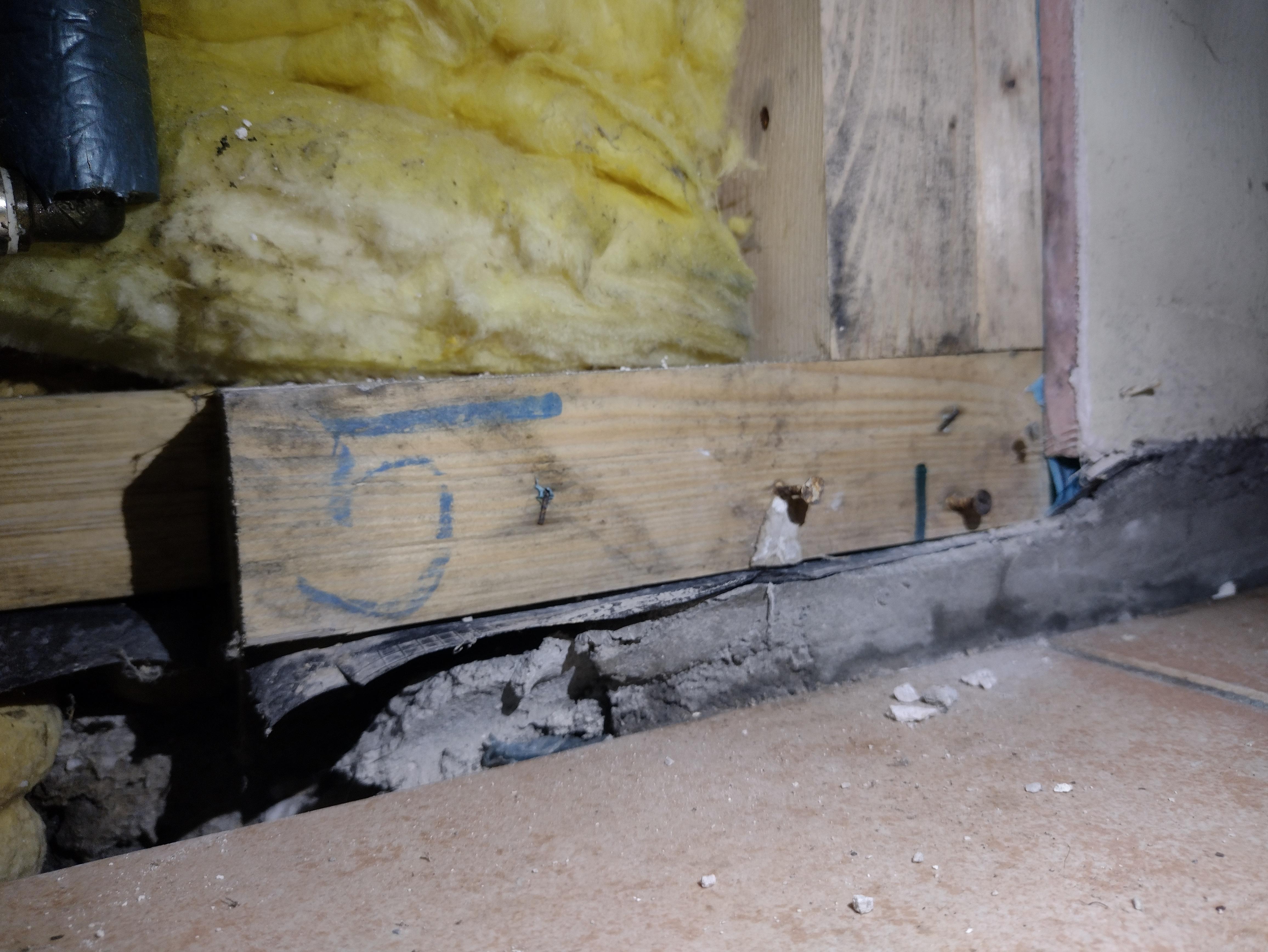

This the kitchen, where frame meets floor and where the pipes of the kitchen sink go out The outside gab is on the level where that small timber is (underneath the DPC and the big timber with the number 5 written on it)

Iceverge, great feedback, thank you. I understand your point. We will be getting quotes for the works and will see how far the budget will stretch. We were busy on the weekend having a closer look at the structure of the house, by breaking the interior plasterboard in one of the bedrooms and in the kitchen. The wall in the bedroom is completely dry not a sign of damage of damp! In the kitchen we had some damage to the plasterboard from a small old leak in the plumbing, no damage to the frame), but it gives a really good look on the foundation of the frame, I will upload some pictures asap

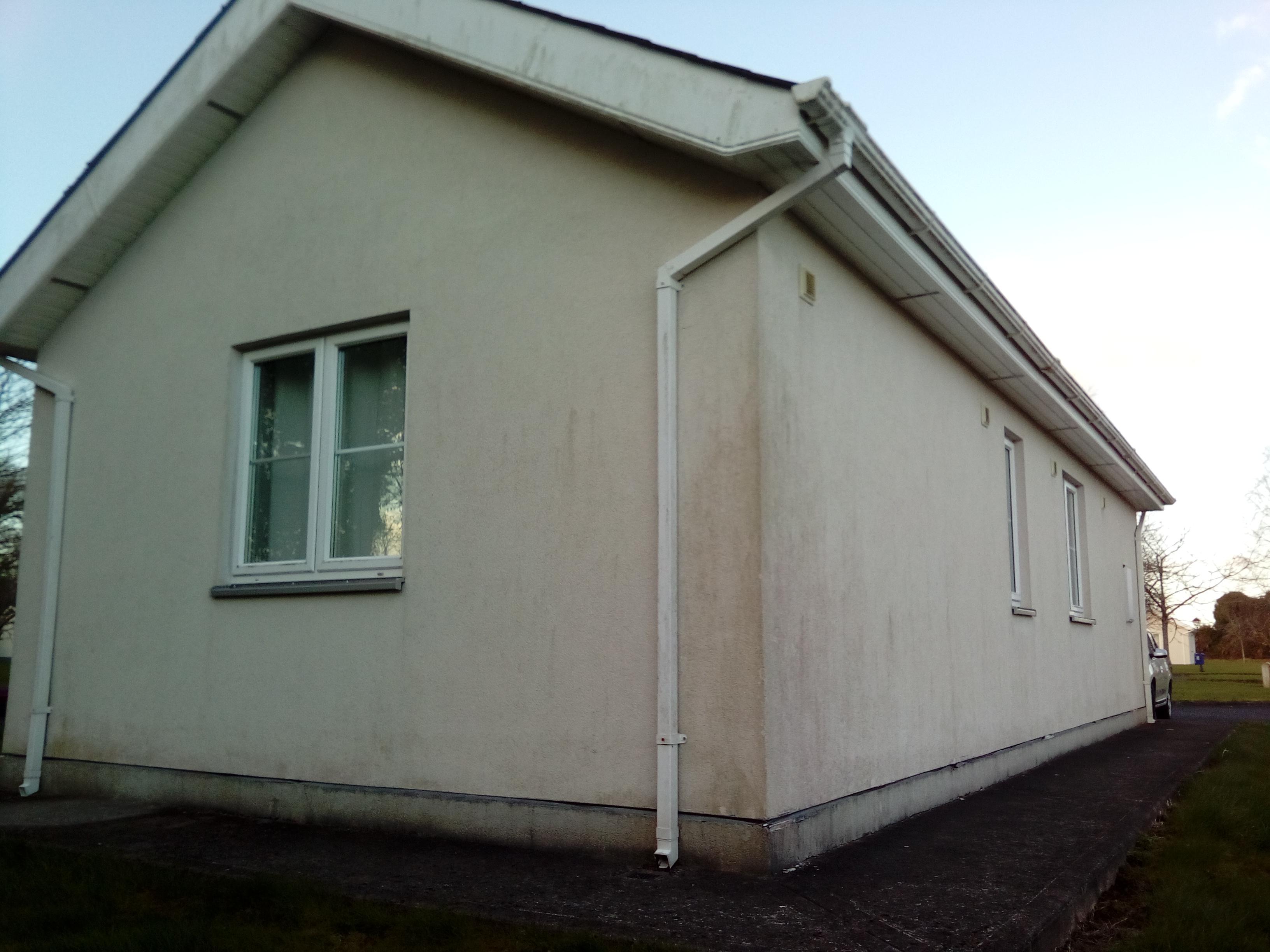

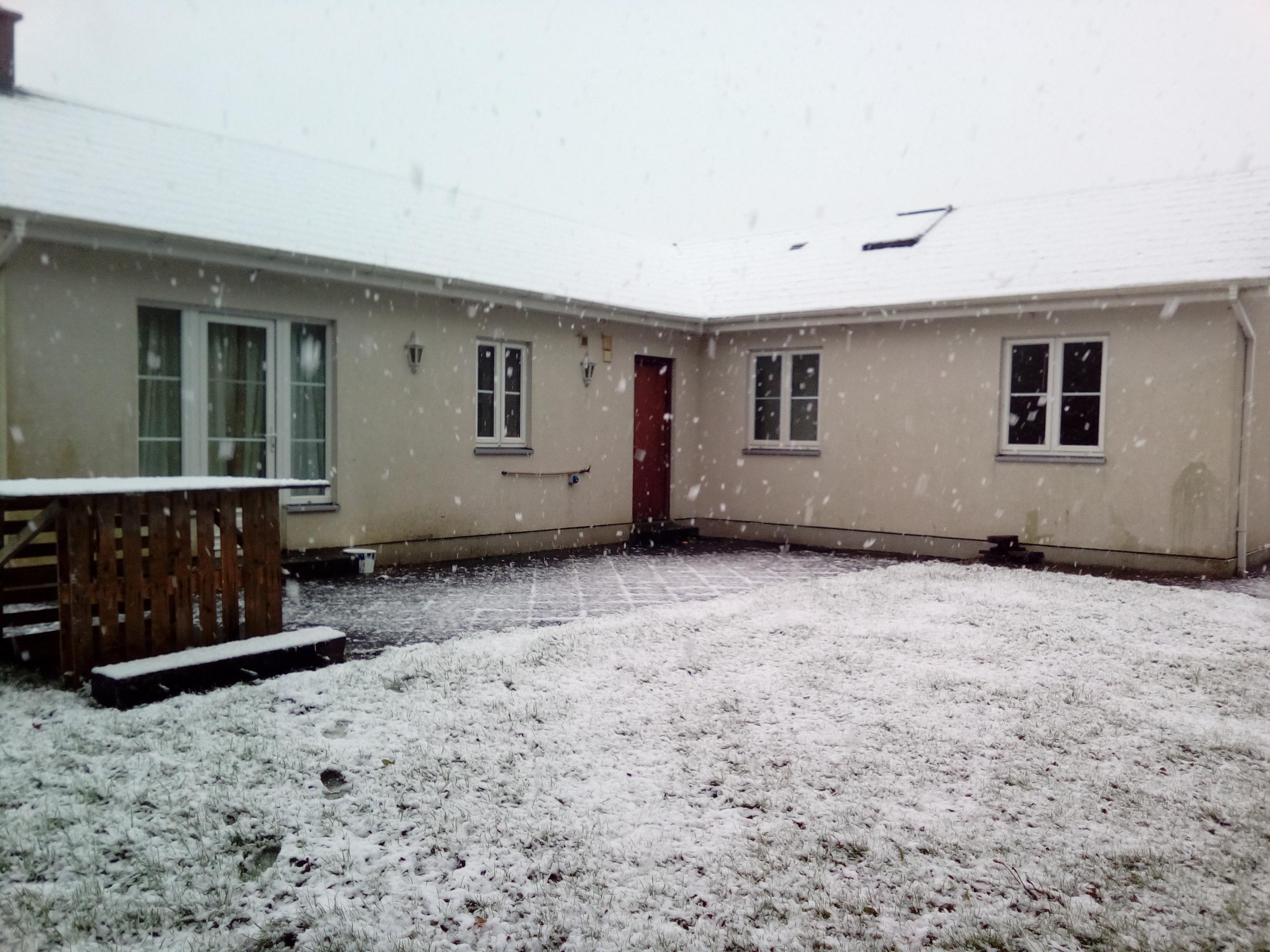

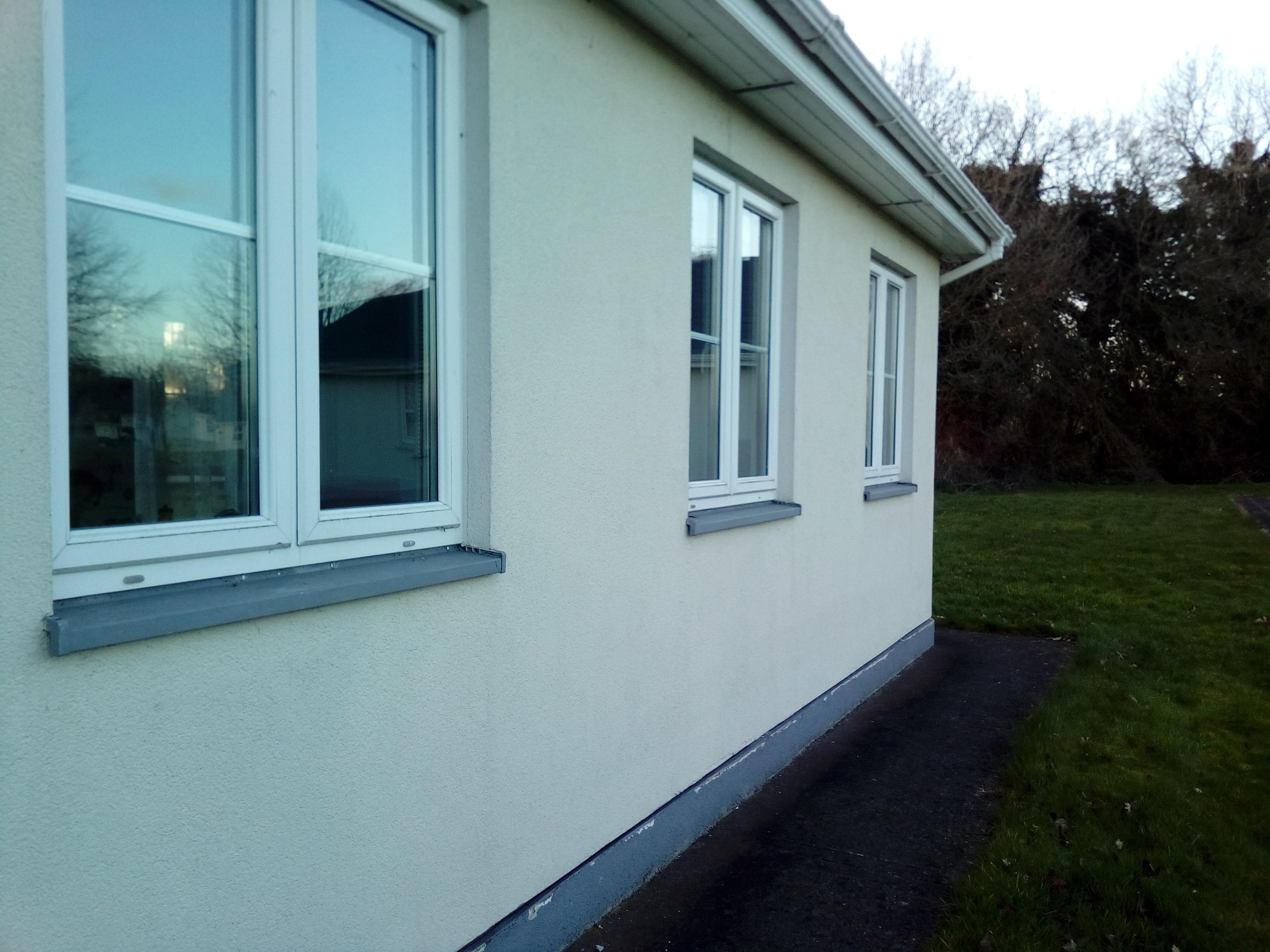

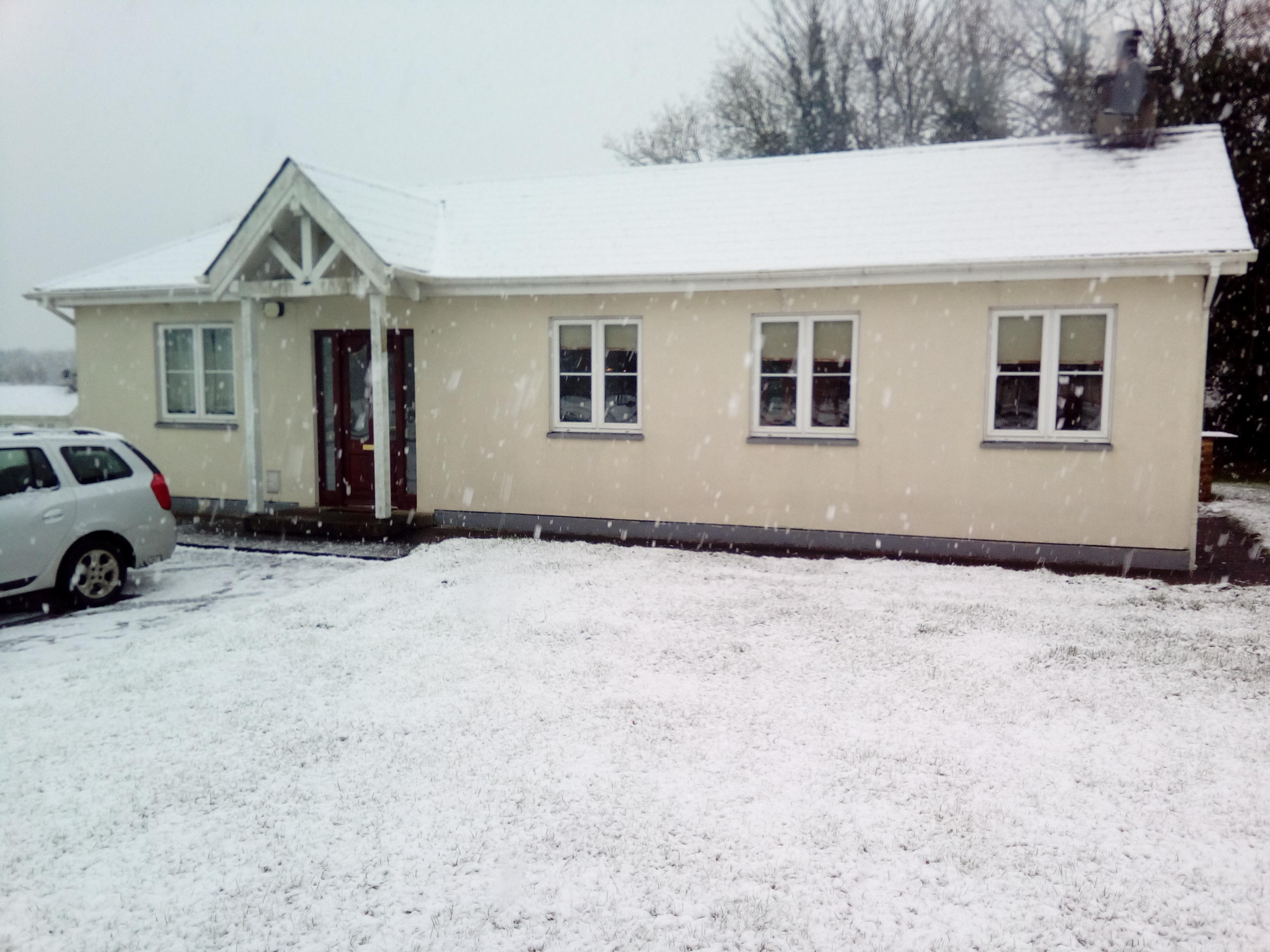

Iceverge, again thank you so much for your explanation. As on the pictures, we have around most of the house a concrete path, would we need to break it to get the insulation below the ground or would it be sufficient to let it go down flush with the path? Here are some pictures from back and front, I can get close up of the soffit if useful. Yes, we have to remain in the house during all works. As a next step we will investigate the walls further, I will upload some pictures asap

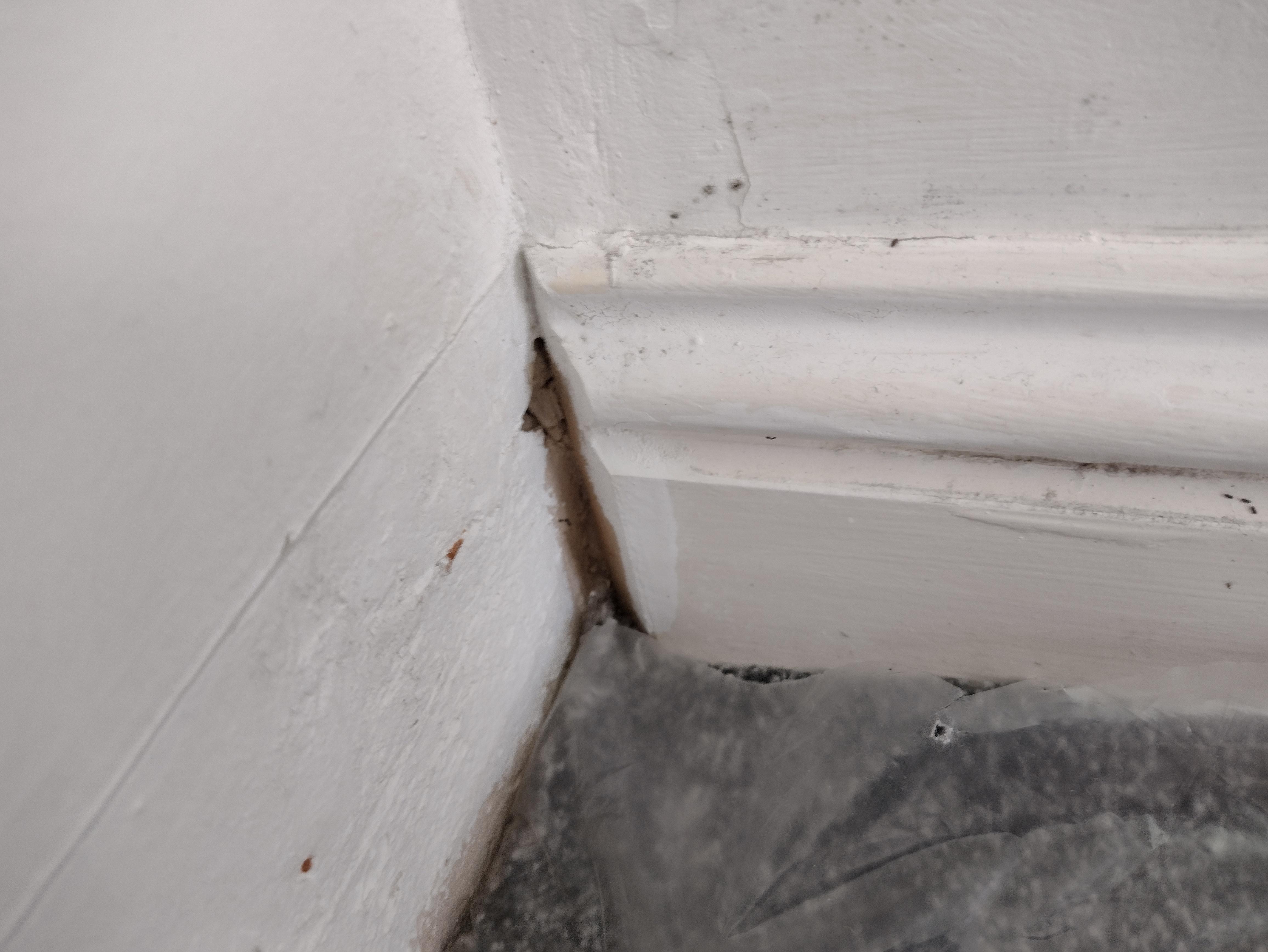

This is a picture of the skirting board in an corner with two external walls (all furniture have been removed to allow enough ventilation to avoid mood) We have carpet with underlay in some rooms which have the same issue on the external walls

As far as we have been told the concrete slab is insulated with some areoboard , I am not sure if there is any way to verify this now without causing too much damage. Yes, there are no direct leaks to the inside (as in holes or water dripping/running), only condensation I have uploaded a pic of the floor level at the front door

This a picture of our front door, showing the floor level on the inside in relation to the gap on the outside, I hope this useful (sorry had to take the last two pic in the evening)

We recently bought a small timber frame bungalow, which requires some repairs to the exterior render, as there is damaged to the section where the plinth meets the wall, I have attached pictures of the area. Unfortunately, so far we could not find anyone, who could offer use an explanation or solution to the problem. As seen on the picture attached the grey tape (which seems to be some sort of flashing tape) is broken and coming off on several areas around the house, exposing the metal edge guards and allowing cold and moisture into the walls, as on the interior the skirting boards are cold and when furniture are places directly on the wall causing condensation and mould. ( as a short term solution, We have now left a minimum of 10 cm between the furniture and the walls, which seem to solve the problem of sweating skirting boards and mould). Q1: Does anyone recognise what this exterior gab between the plinth and the wall is for?! is it just decorative or does it serve any purpose, like breathing of frame or expansion gab? Q2: can this gab be closed and the house completely covered with an additional layer of acrylic render? Q3: if the gab needs to be kept, how can we repair the damage? Any help and advice is greatly appreciated! PS: As far as we can tell the house is built up of the following layers, starting on the inside: plasterboard, yellow insulation wool, OSB board, insulation board, acrylic render with embedded mesh and sits on a concrete foundation.
