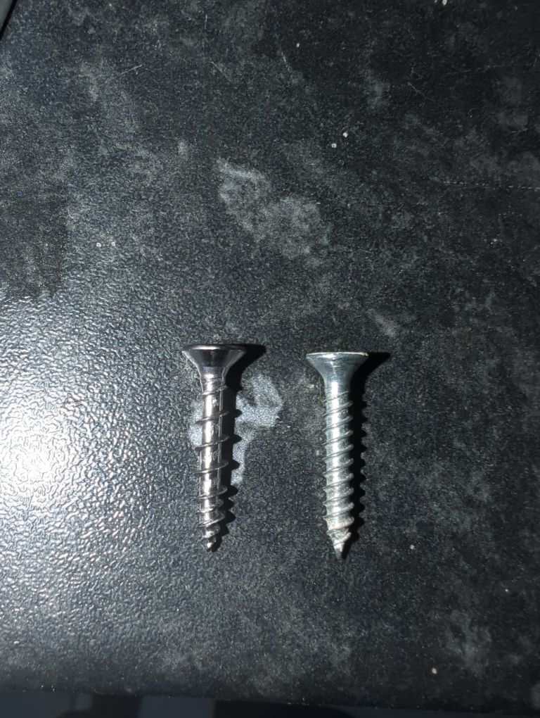

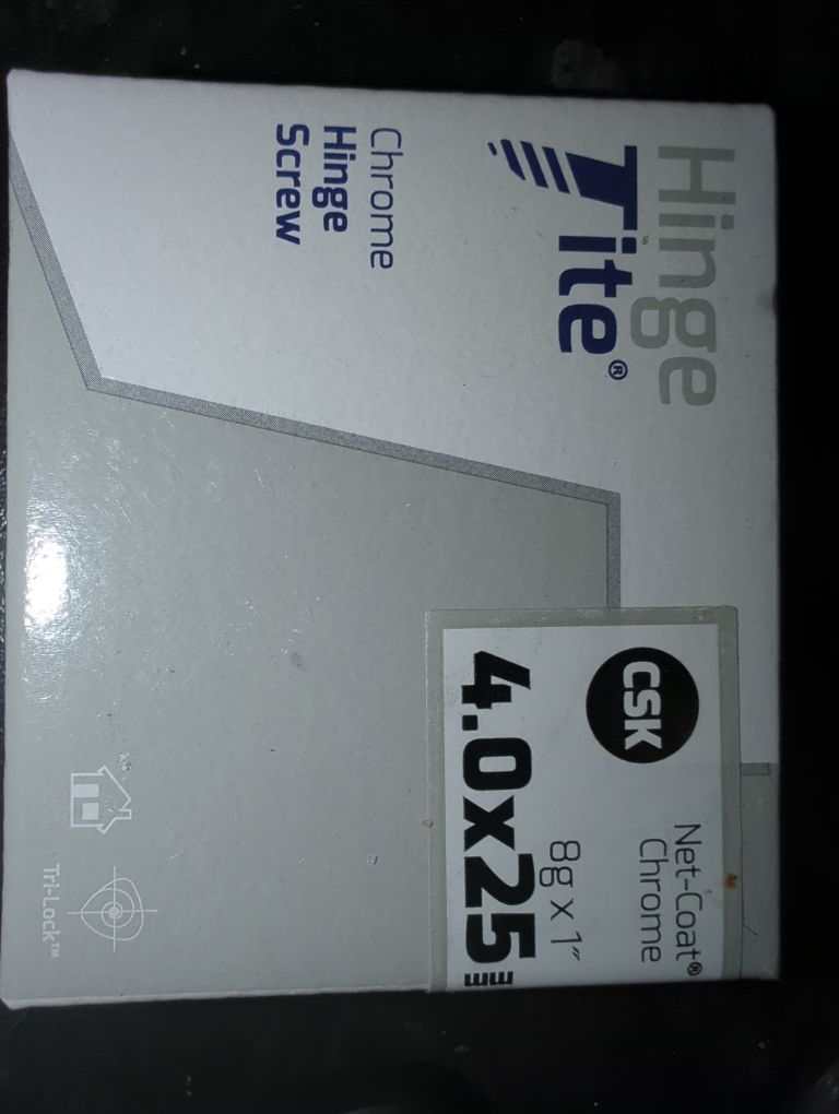

  11. I bought these hinge screws but the thread is different to the original hinge screw on the right side. I think these HingeTite are to cupboard doors.
  12. indeed "machine thread" is the term I was missing
  13. Hi All, This is a silly question but what screws are for regular interior door hinges? I think it is M4 x 30mm but I think the thread on those is a bit different? Please advise. Thanks
