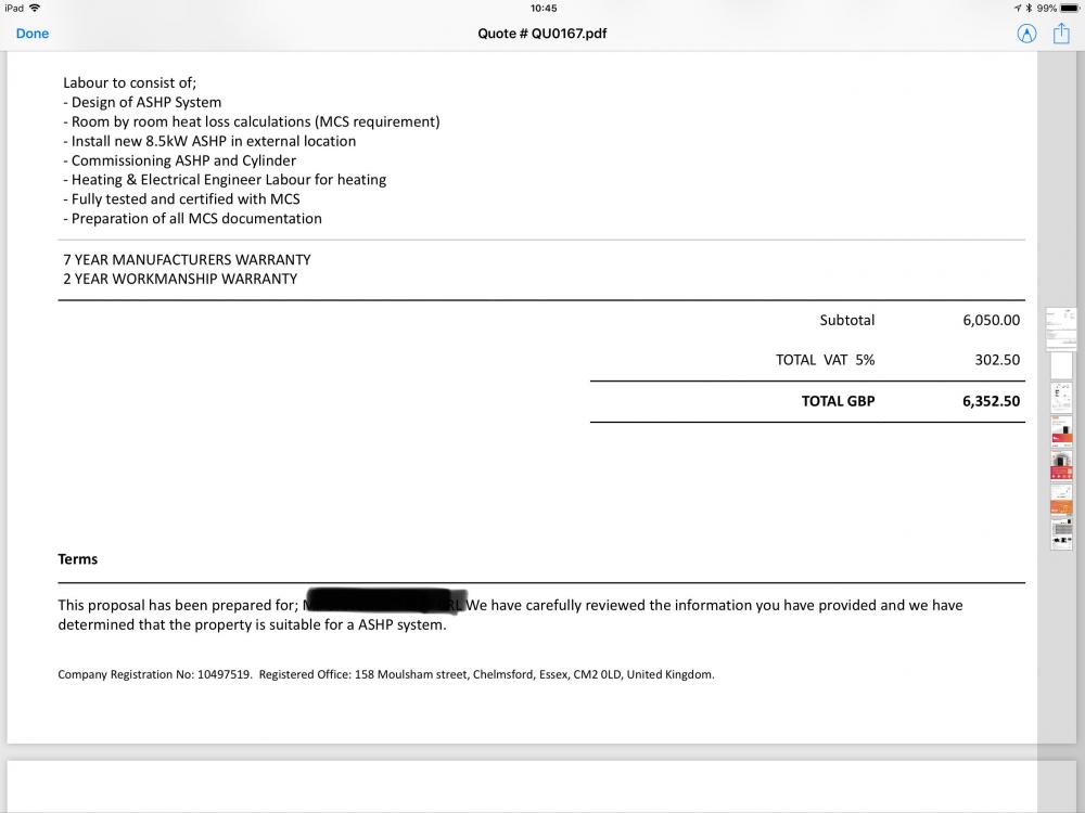

Thanks. Bottom line is that they need working heating before the winter........any money back would be a bonus ! -
Does this make sense & sound ok please ?
Lynford replied to Lynford's topic in Air Source Heat Pumps (ASHP)

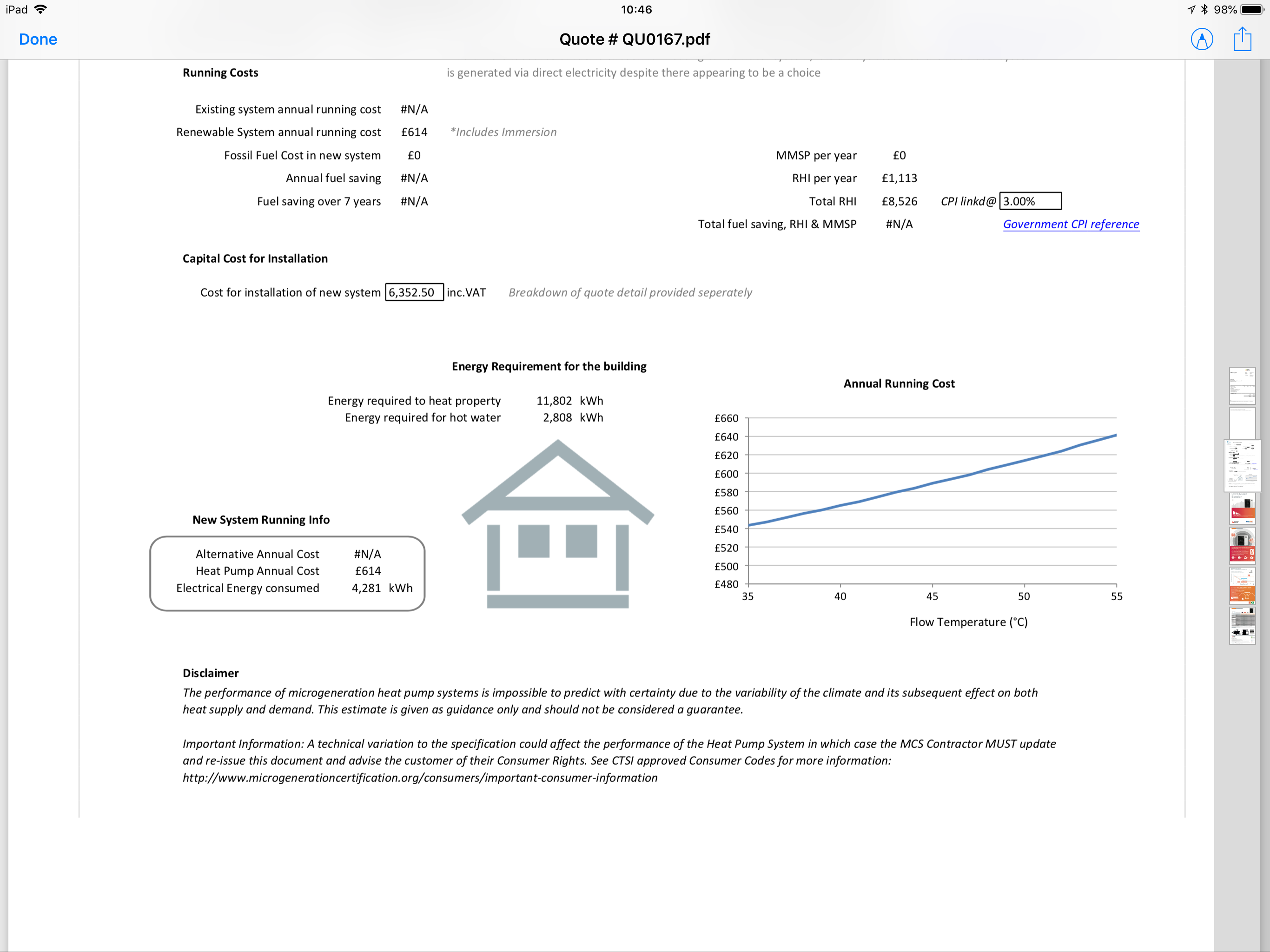

Sorry, just seen it on the quote / info ! £1113 a year. -
@newhome, yes I believe they are applying for the payment on my in-laws behalf. How much could they expect. -
Thanks chaps. @Stones, yes as part of the attempt to get the old system going (and as the old one was rusting around the joints)the cylinder was replaced so it’s known good quality and around a year old. -

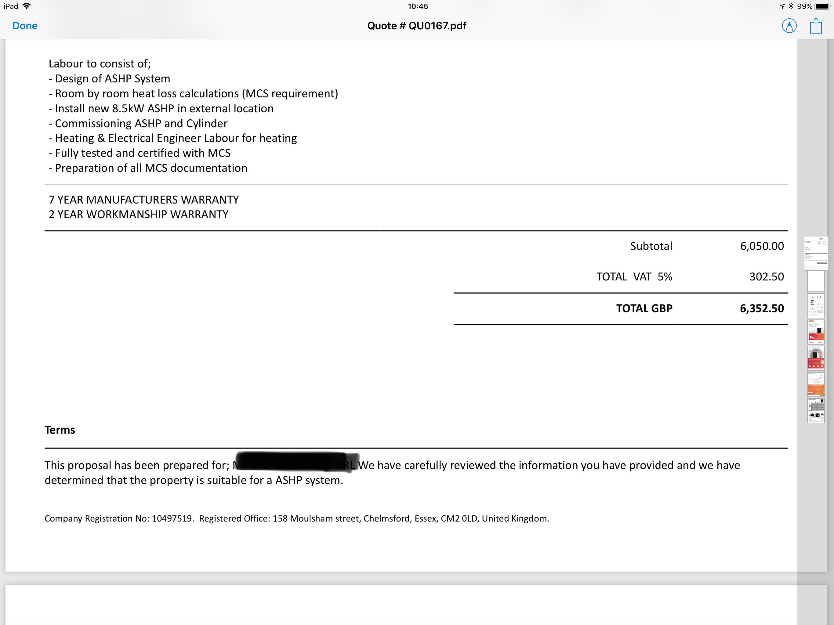

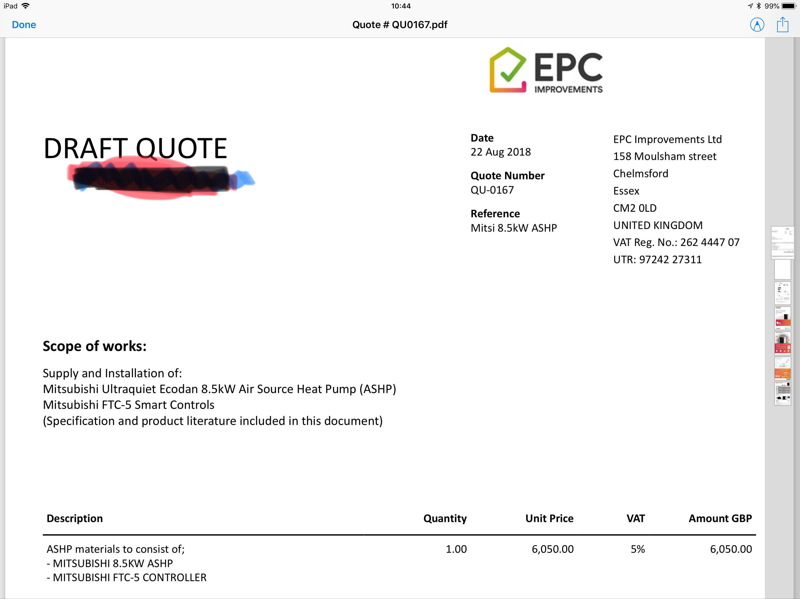

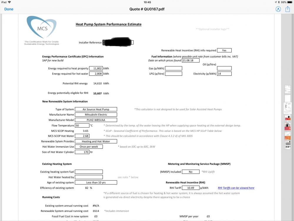

After the running saga with the Kingspan ASHP detailed on this forum, my in-laws have given up and have eventually found someone to quote them for a new system. Its Mitsubishi which makes me feel a little more confident. If anyone with experience in these things cast an eye over this quote and see if it makes sense please, I have no idea what I’m looking for ! Also, anything else they should be requesting or questions they should ask ? Cheers.
