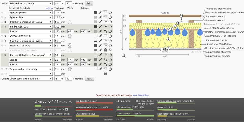

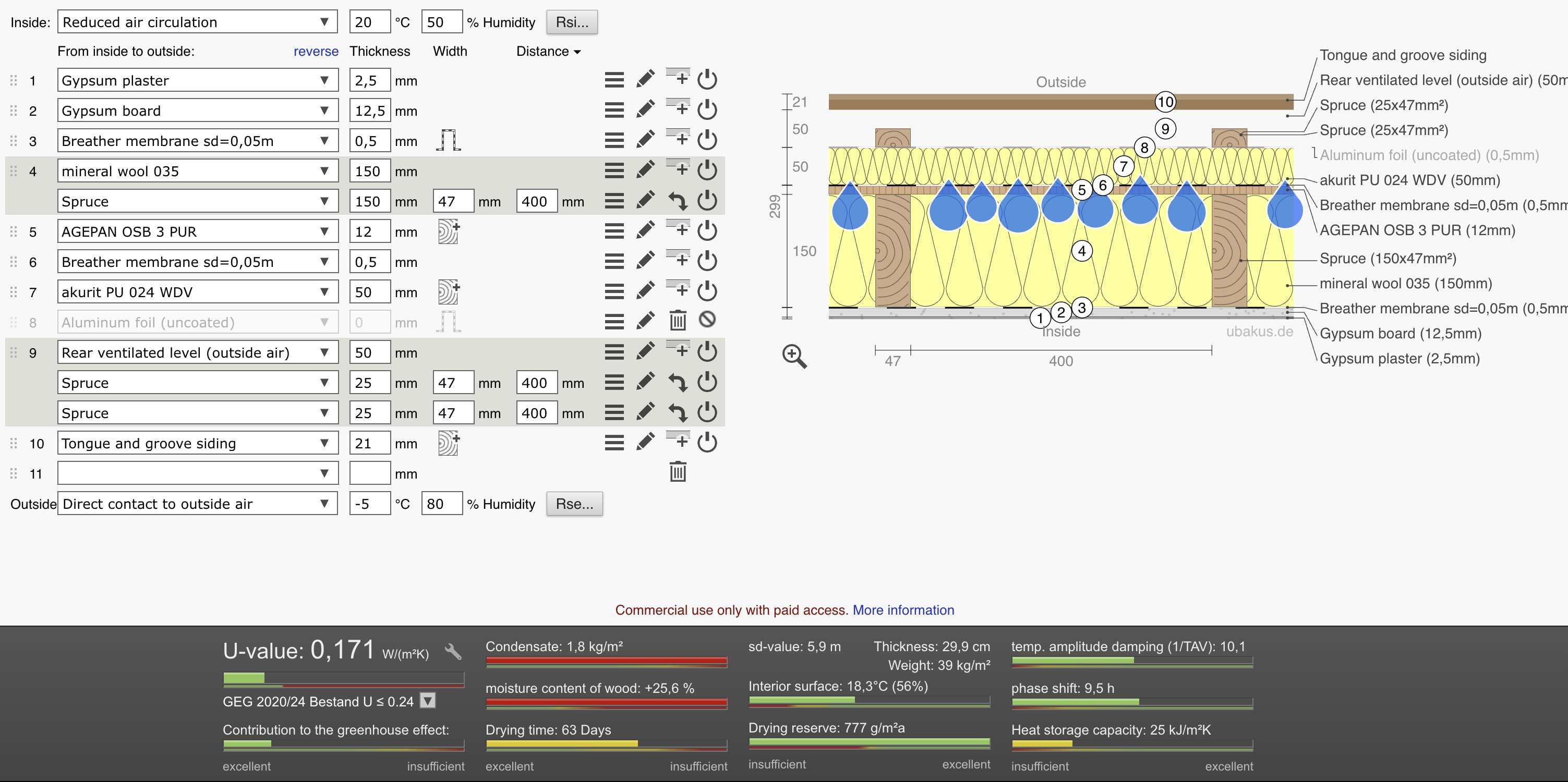

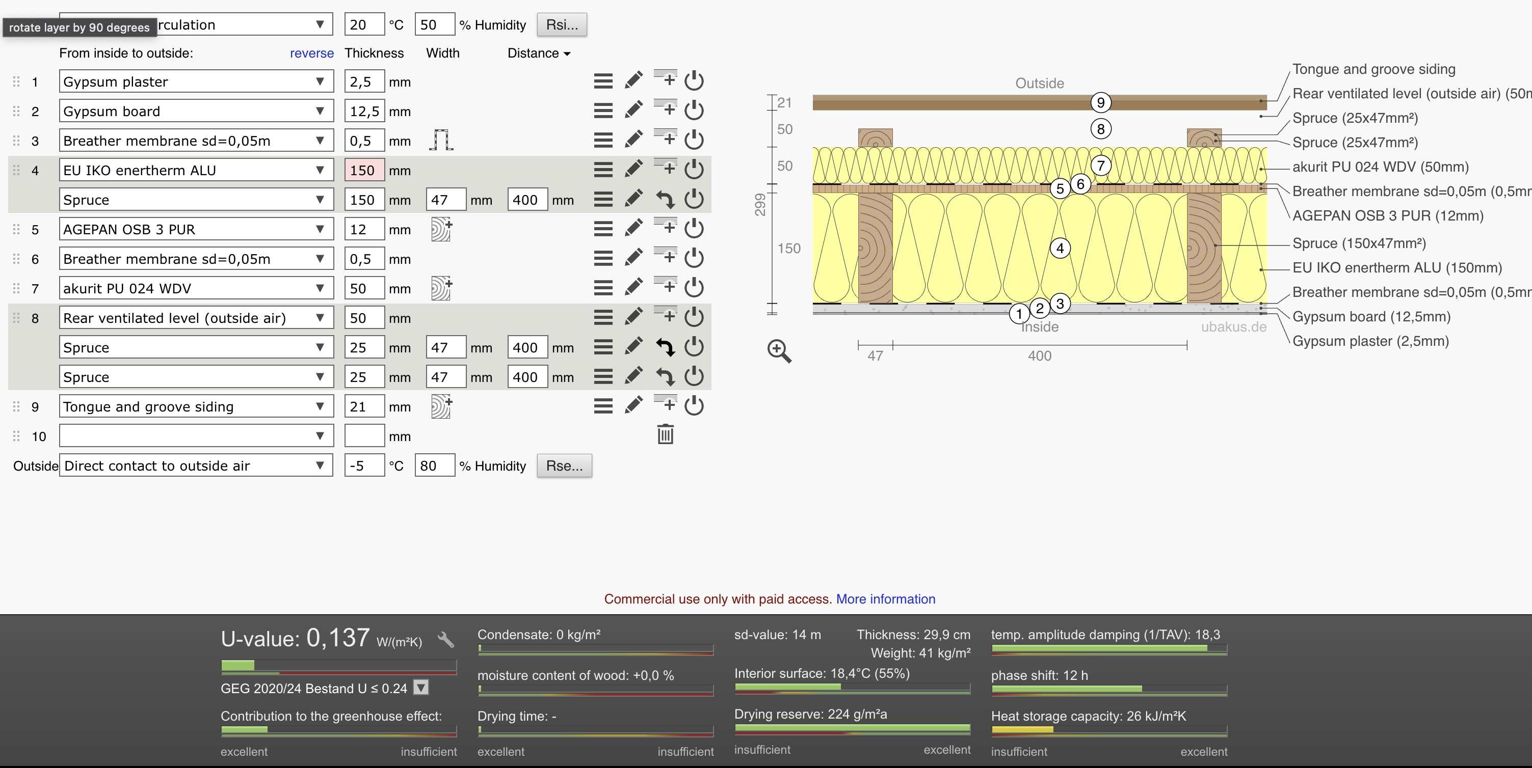

Thanks @Iceverge I have been playing with the make up but with PIR boards and mineral wool. but it seems like mixing pir and mineral wool gives me a big condensation risk. Unless Ive just set it up wrong. Mineral wool in between rafters and PIR over the top is what I was thinking of doing for the warm roof insulation, after reading other threads on here it sounds easier than getting the pir in between the rafters. -

Yes I could put some insulation on the outside of the structure. -

Yes you are right, there are windows above the ridge height, in reality I can probably safely raise the ridge height up once I have worked out the correct makeup for the roof. -
Hello, Im planning a single story extension, with a pitched roof that will be built of a steel portal frame with steel ridge leading back to the existing house. so I can have open vaulted ceilings in the extension. The walls and roof will be timber frame stick built onsite. I would like to have a warm roof if I can as this sounds like the best option but maybe I am making it more complex for my self than it needs to be for the benefits. I will be doing nearly all of the construction myself. I have had the structural engineers drawings done, but I would like some advice on the best construction details to minimise cold bridging and making my extension as warm as I can. I have been reading through various forum posts and watching youtube videos but think I might have confused myself a little bit. I have attached the plans from the engineer and where I have got to so far with my model. At the moment I am not sure the best way to clad the steel pillars and wether the roof details are correct for a warm roof with standing seam roof. Any advice on this would be really appreciated. Thanks
