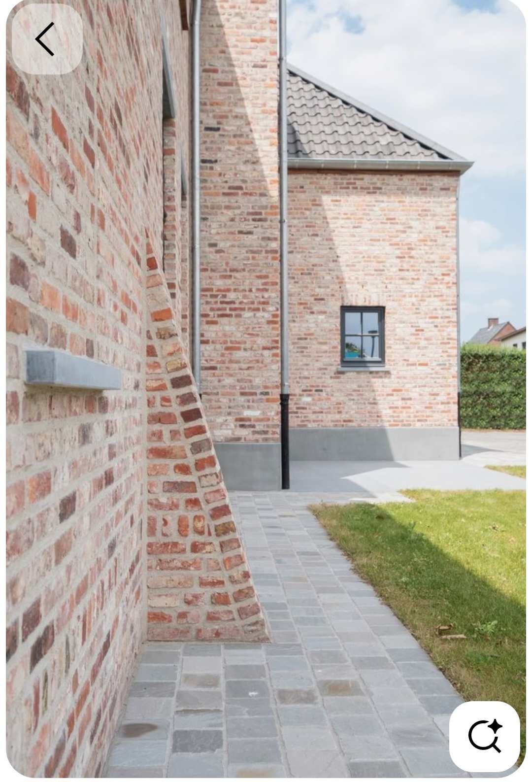

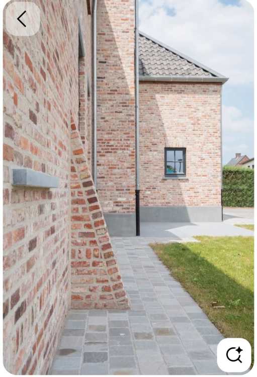

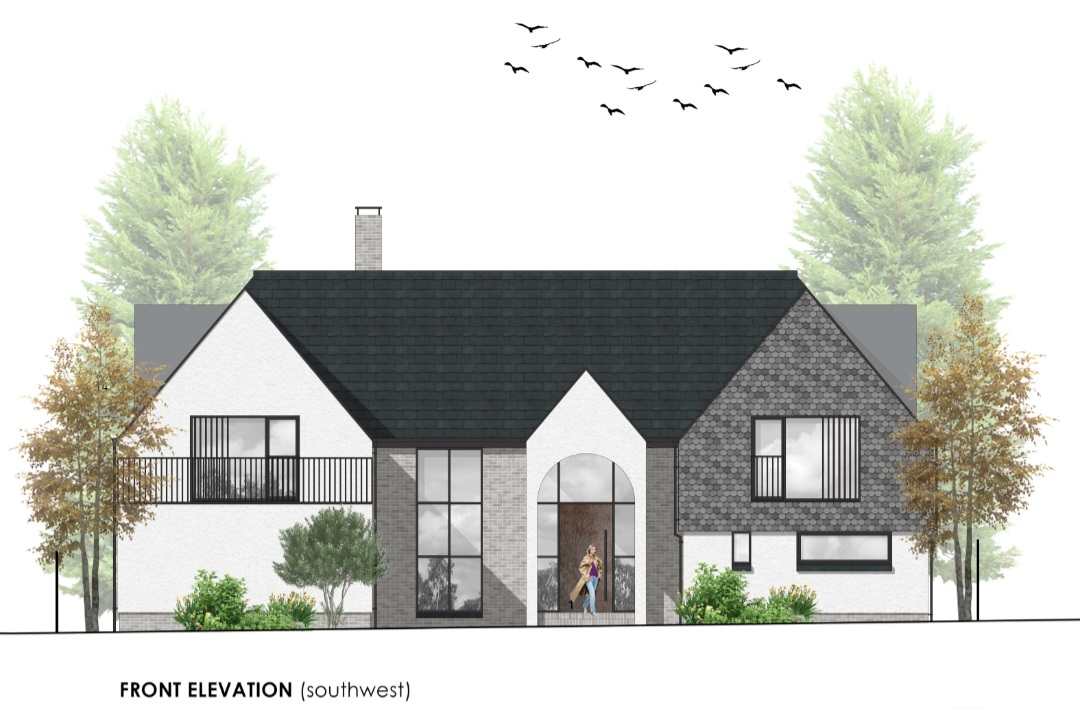

Thanks. Thats really helpful as always. In the pin board I originally had this picture with buttresses but I am not sure how they would work against the redered wall. Please also note the concrete base for the selection of the wall but again not sure if its going to be too many things in the design or can change the roof colour to dark grey to complemet the concrete base course. This might be a European way as I have not seen this in Uk. Thats a great idea keeping in view the practicality aspect. Would the timber cladded low wall be as good (with timber cladded garage door) or brick low wall with soldier course complimented by base course below render also a soldier course? Or may be a glass railing? Just want to keep enough contemporary and arts&craft combinations so the design appears to bring together both elements.

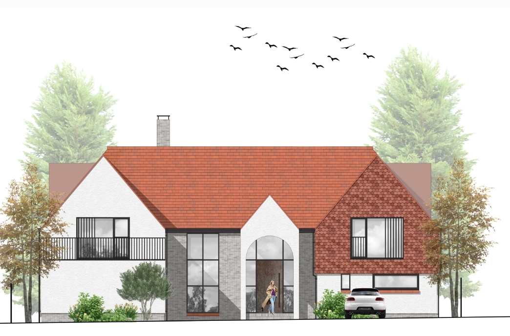

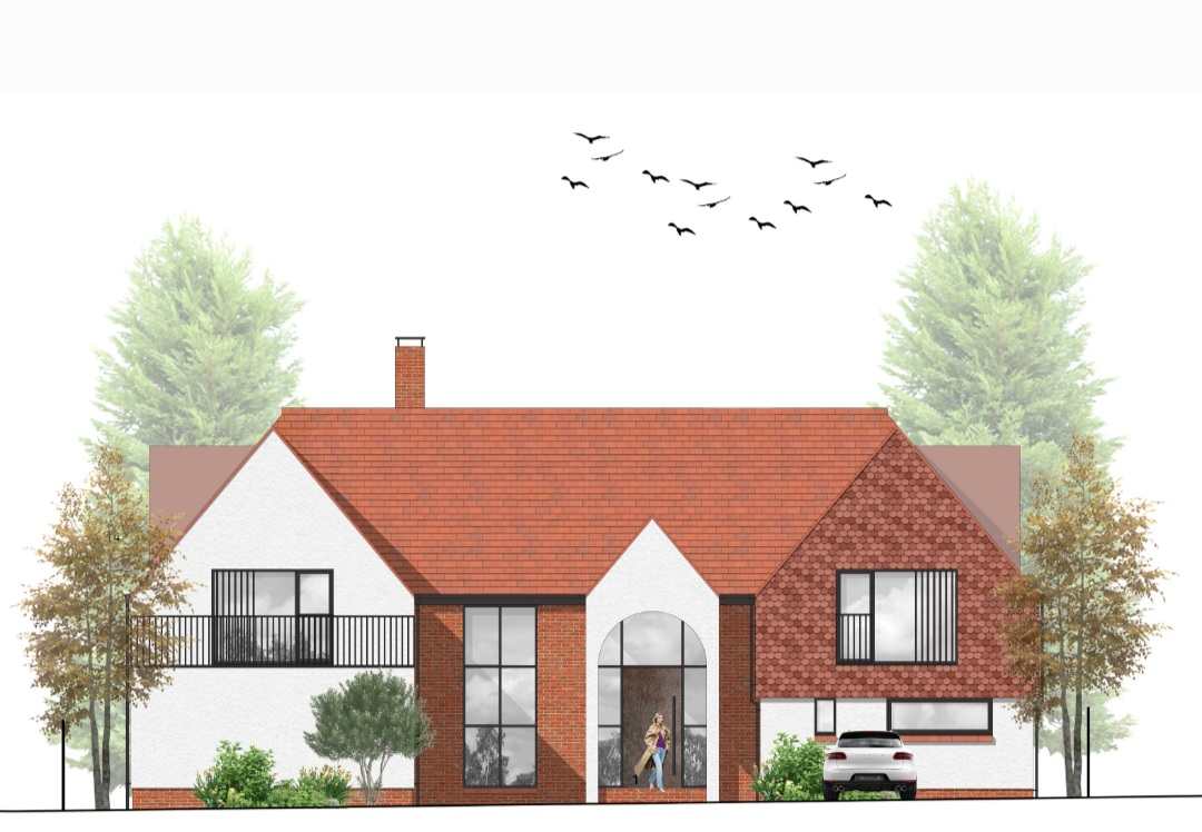

Here are the updated drawing. Please provide helpful suggestions to improve it if possible. Thesee are the three options of the initial sketches for the revised application. What are your thoughts?

Hi. Back again. I have had the updated drawings which I will post. Unfortunately that has resulted in 2m reduction in the height and removal of bedroom from the loft, the loss which is significant. Interestingly my architect quoted the first picture/example among the inspiration.

Also please could the helpful readers provide the feedback on the option of using combination of charred timber plus zinc/aluminium shingles on the left v only charred timber based on the pics below. 3d render of charred timber all round seems better but it might be just because it's 3d view but it reality the addition of shingle might give a bit of character. Please also note the difference in porch glazing in the two pictures. I am also considering the idea of cladding only on thr front and might cover the sides with render or brick due to cost conisderation. Thoughts on that would also be welcome.
