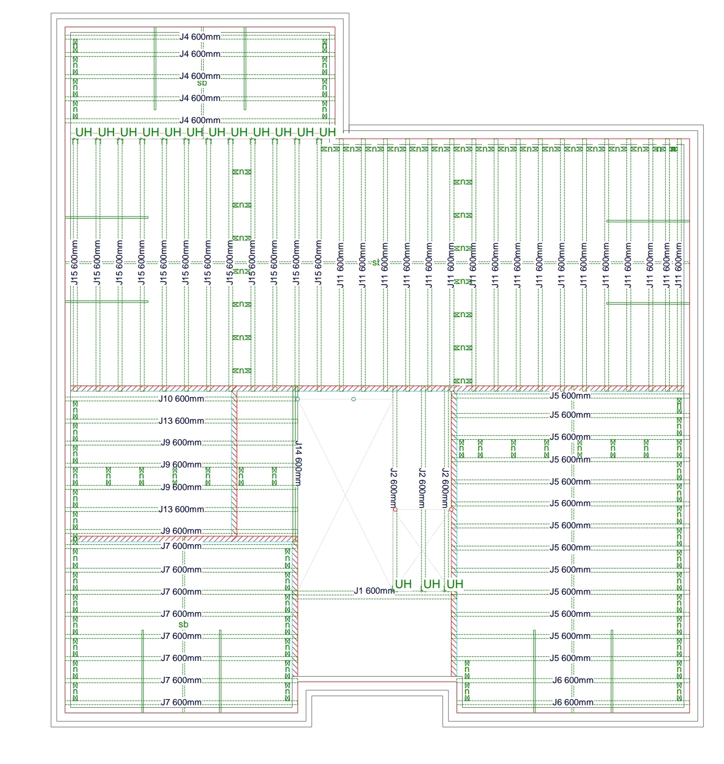

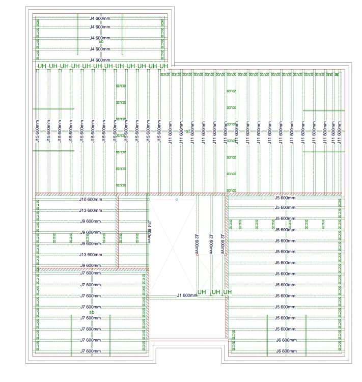

  15. My build has started and bricklayers are on site, finally! For info it's a standard brick/block build and joists are 300mm posi @ 400 centres. I've been discussing with the builder the Tony Tray idea but need a few things clearing up; - Does the membrane only need to be fitted on the walls that the joists penetrate? I've attached an image of the joist layout. - Which brand VCL membrane is best and does this need to be bonded to the wall plate before joists are installed? Thanks, AD
