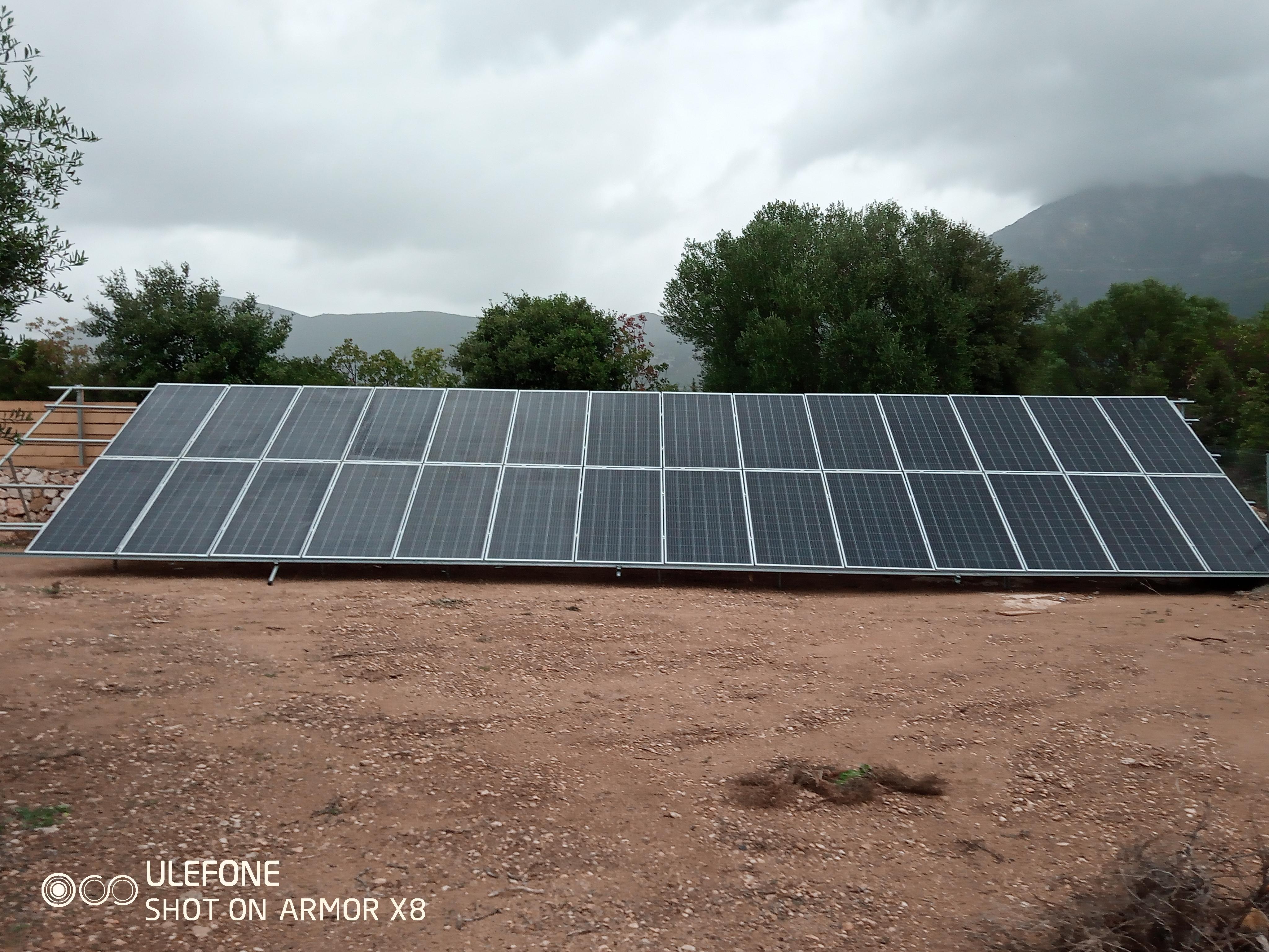

  1. I hope this update will be of interest? We have finished the build but for some small details 😃. I bought a modern stove from Kratki , it will wait for winter before connection , it is 35 C here ! I have 2x A/C units fitted so am working in a comfortable 25 C . I have installed a full off grid PV system which is running the A/ C and there is still a surplus of energy 😁 . In fact the growatt inverters shut down occasionally as we are not using enough of our generated power , (open to suggestions here ) The build was challenging for the locals ,who know not the world of Passiv Haus , but we have ticked most of the boxes . It took exactly 1 year to build , on a Greek island , so much more of a challenge especially during the covid situation. The house retains the cool temp overnight , it's a pleasure to walk in at 0800!
  2. I used a wall and put a fence on top which gave the perfect angle to mount the panels . Locally @ 37 degrees

  5. water heating by solar, lpg gas oven , woodburning stove for heat , passiv haus levels of insulation , triple glazing and of course when required a genny !
  6. I am in Kefalonia , Greece , 38°07'24.9" N 20°34'55.0"E - This is our solar input , my calculations were based on . A surplus of power all summer and sufficient reserve during the winter months . Quite right , Steamy Tea , kWh per day , based on current use . Average Solar Insolation figures Measured in kWh/m2/day onto a solar panel set at a 37° angle: (Optimal winter settings) Jan Feb Mar Apr May Jun 3.77 4.16 5.15 5.57 5.46 5.83 Jul Aug Sep Oct Nov Dec 6.01 6.20 6.01 5.19 3.72 3.20

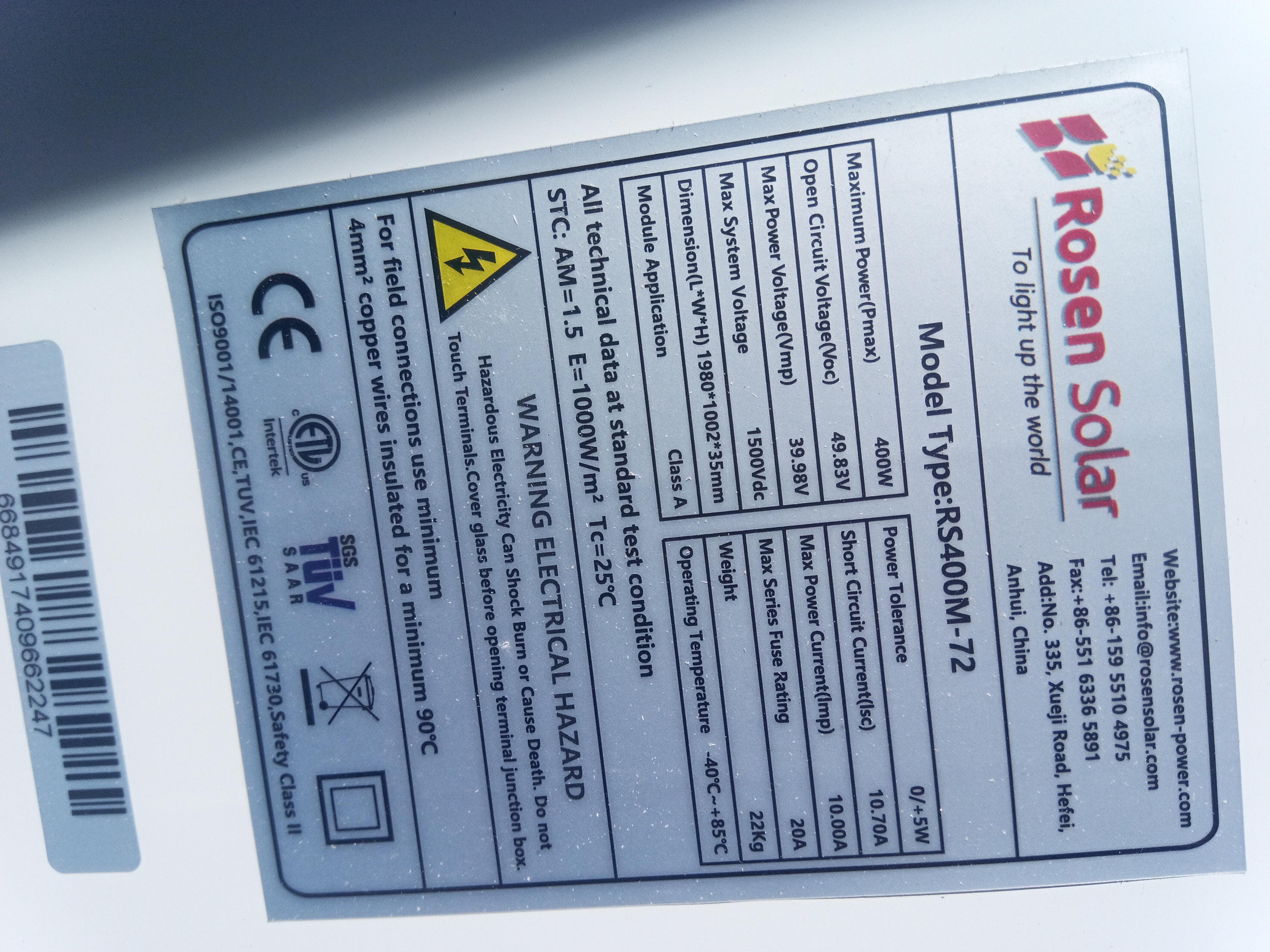

  11. Pictures of a panel specs:
  12. Thanks , for the feedback guys . I made all the hook ups with one panel disconnected. the system is 11.2kw from Rosensolar , it comprises : 28x 400watt pv panels 2x DC combiner boxes with breakers , switches 2x Growatt SPF 5000 TL HVM WPV P 5 kw inverters 1x battery combiner box 3x life po4 48v /200 ah batteries. I hope you find this interesting ? I am treading carefully here and really happy to hear your comments , thank you . The first question is can a solar rated 10 mm2 cable be used from the combiner boxes to the inverters over a 36 metre run ? Graham
