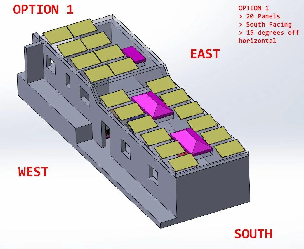

This is the layout I'm thinking about. I may be making life hard for myself in terms of wind lift, but I'd really like to use ballast rather than drilling a hundred plus holes through the roof membrane. You can see that with the existing roof and rooflights, leaving a sensible edge gap is not all that easy. Thanks for all the input folks, really appreciated. -

Thank you saveasteading I'd hoped there might be some solid formula I could follow, but maybe it's just down to my own risk appetite! -
I'm trying to get a new PV system installed, on a flat roof. I'm about to apply for planning permission, but can't find any solid info online about restrictions in terms of how far from the edge the panels must be. I assume this is a building regs thing rather than planning permission, but I'll need to be on the right side of both aspects I guess. Many websites seem to refer to a general rule of panels being at least a metre from the edge, which for my roof will massively reduce the area I can use. Does anyone else have any experience with this? Thanks in advance

The update to our previous electricity tariff has given me the push I needed, to crack on with getting solar on our house. I've made off grid solar systems before, but never done anything grid tied, and never anything of this scale. So I'm not completely clueless, but also realise I have a lot to learn. Please go easy on me! The system I am planning will sit on a flat roof. Panels sitting at about 15 degrees. Thinking I'll use 20x 425W panels. The reason for this being, it's the max I can fit on the roof. Then I was thinking of using 3x PylonTech US5000 4.8kWh 48v batteries, and a Victron Quattro inverter (either 10,000VA or 15,000VA). I realise I'll need to go the G99 route. I'd ideally like to do 99% of the work myself. I'd like to export, so I'm keen to ensure my actions don't preclude this. I would like to create a system that can be configured to export at peak times. I realise I may not be able to export at the full inverter load. We currently have gas for DHW and heating, but interested in switching to electric. We have 2x EV's. Current we are consuming about 20kWh per day, with 50-60% of that off-peak (EV charging) So my questions are: 1 - Is it possible to install a system like this on your own. Not in terms of technical ability, but in terms of regulations etc. 2 - In term of the system spec, do you think I'm heading in the wrong direction with any part of the spec? 3 - Any advice in terms of the G99 form? I contacted 2 companies that advertised they they could help specifically with this part. 1 replied, and said that I should be fine to do the application myself. Many thanks in advance!
