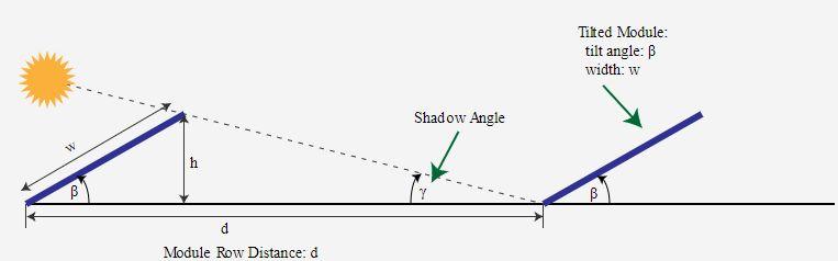

Hybrid Off Grid Energy Feasibility
Smallholder replied to Curtis's topic in General Alternative Energy Issues
I wonder if this would have resulted in significant shading? They would need a lot more surface area to spread out the panels to prevent shading at this angle. -
