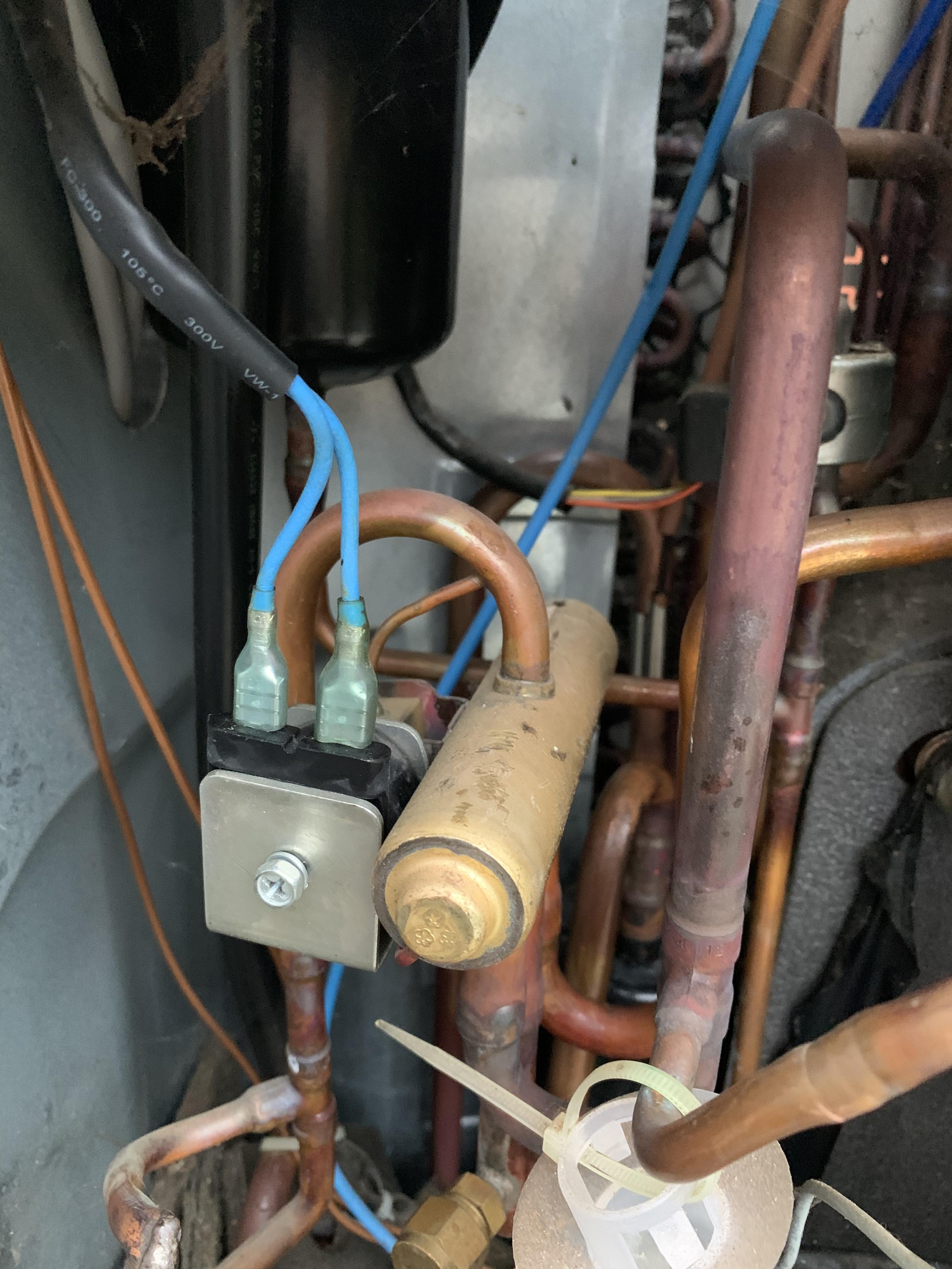

  5. Sorry to be a pain but where is the 4 way valve? Thanks is this it?
  6. Bit of an update. I noticed that when the fans kick in on the ASHP unit they are blowing hot air not the usual ice cold air! Seems that everything has started going arse about face for no apparent reason. Any suggestions welcome ?
  7. Well nobody has touched the system and it’s been fine so can’t see why it would all of a sudden start doing it unless there’s a technical issue?
