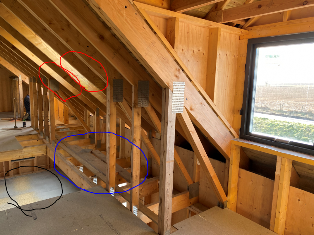

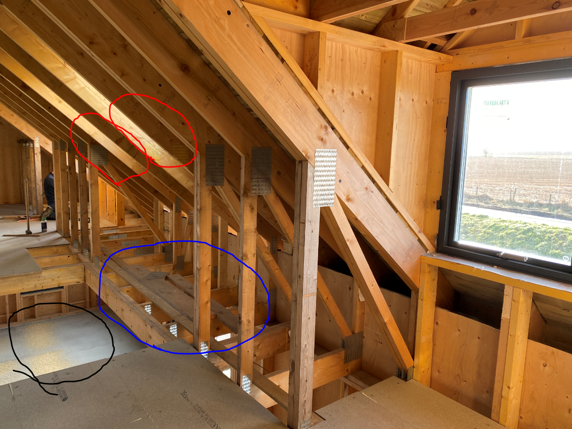

Evening, I have a small 'shelf' area in blue in the picture which sits above our front door and between the front door and the two veluxes in red. The void in black is where our staircase is going. Does anyone have any ideas for this space in blue? We can't box it up because of the velux's and can't actually access it as a space you could walk in. So our only idea was to turn it into a shelf and put something on it. Thanks Paul

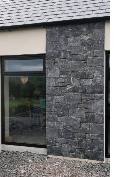

Can anyone recommend any good businesses that deal in stone panel cladding that will send samples out? Thanks Paul
