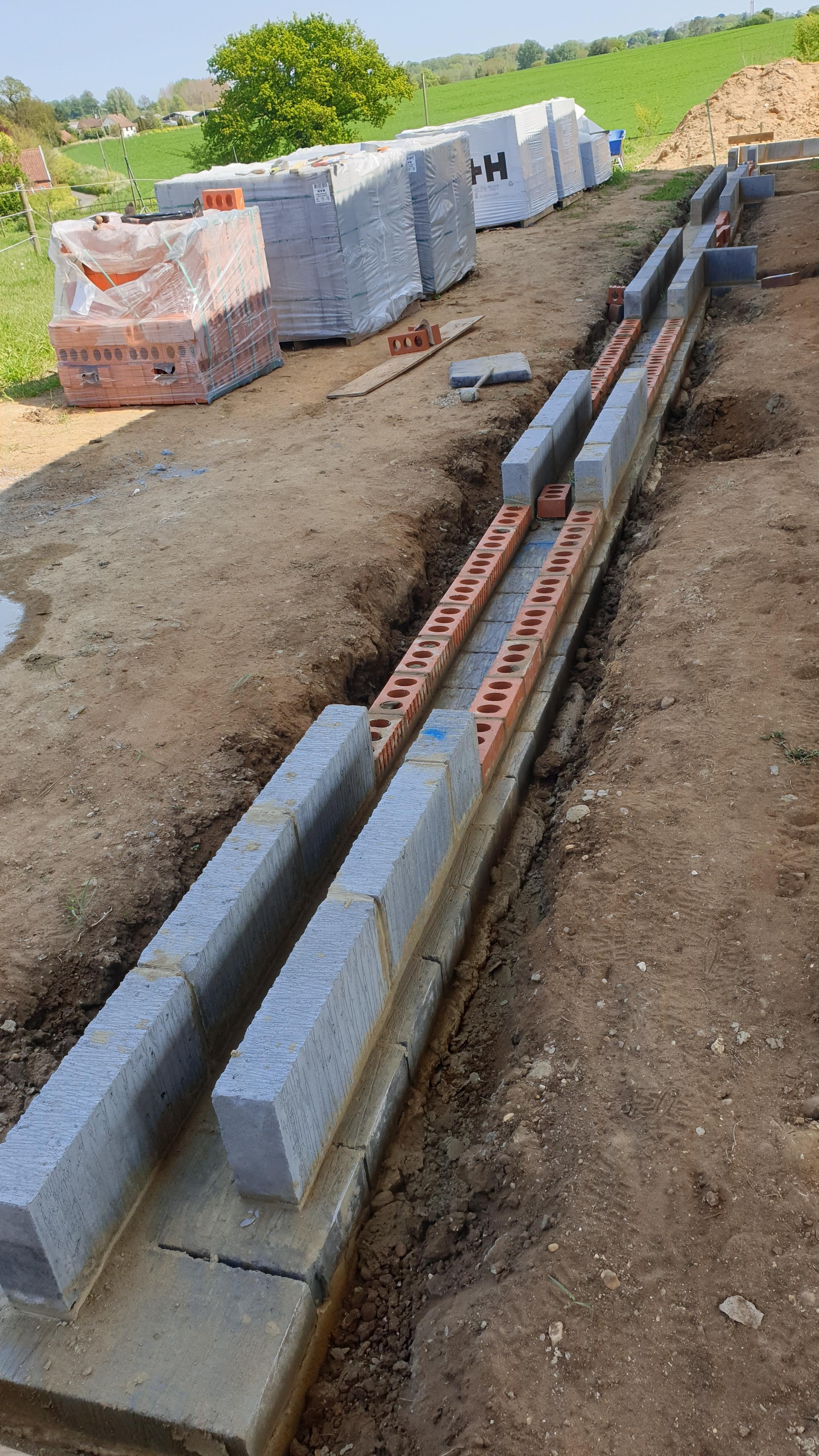

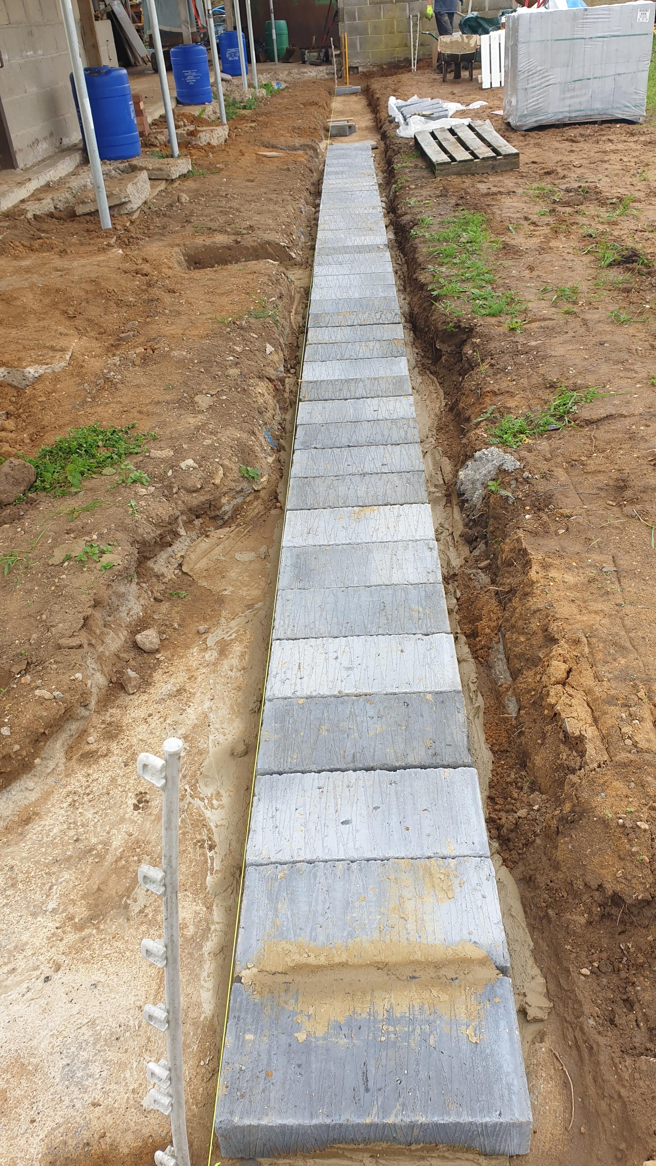

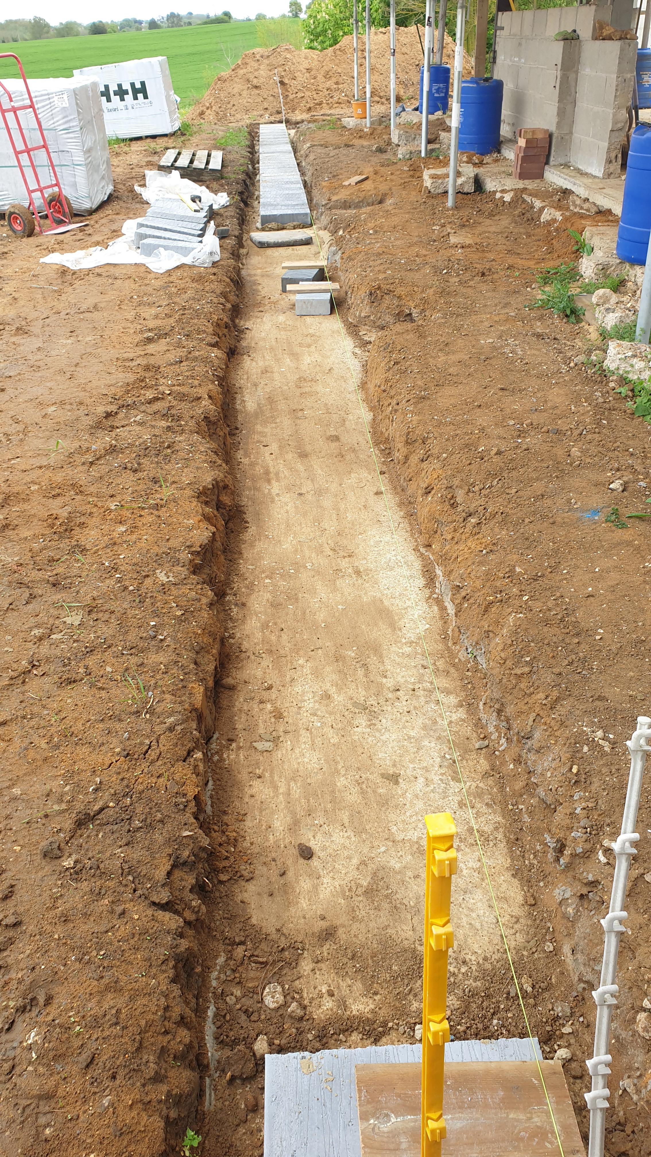

Trench filled

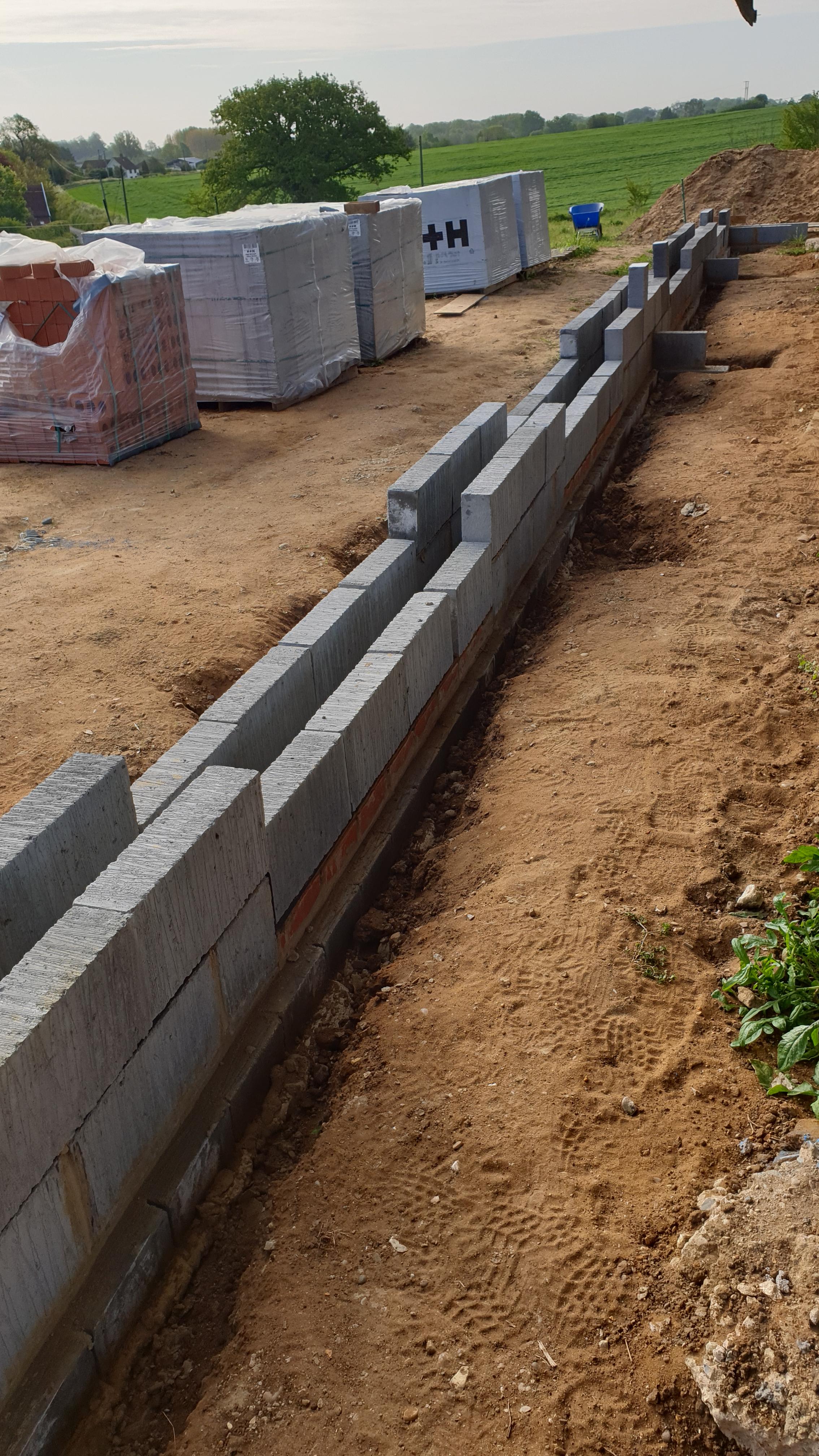

First layer of foundation blocks
2nd layer of foundation well underway with the brick level lower to allow for the level thresh-hold doors

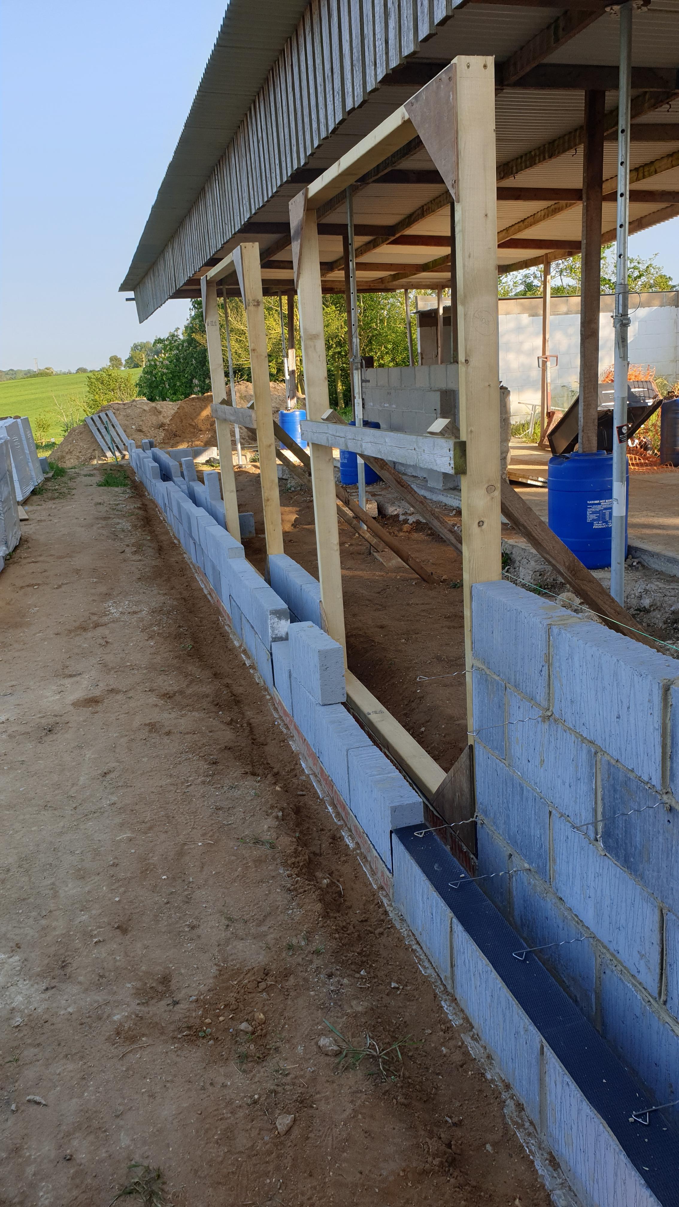

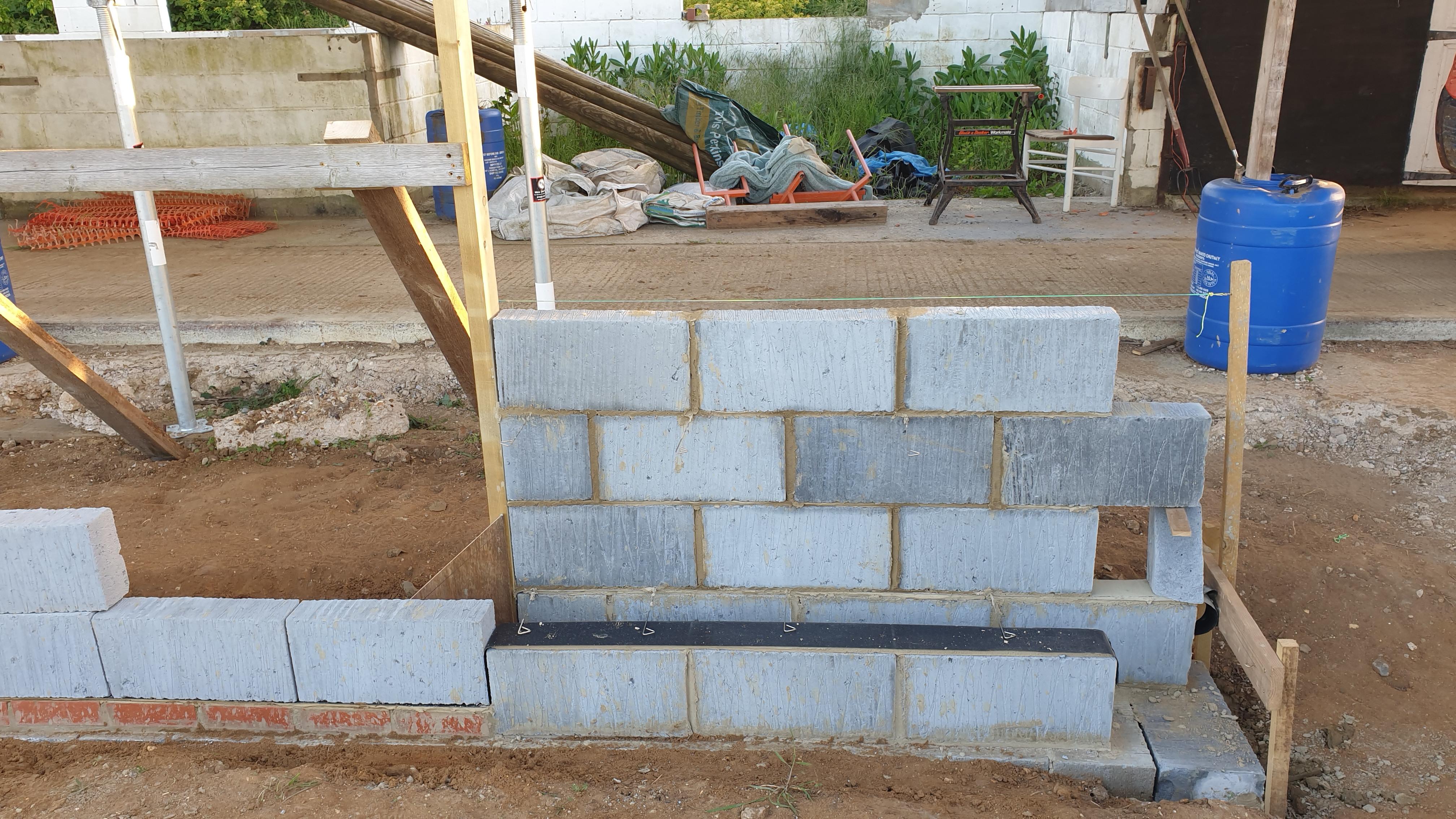

DPM put down , with blocks on to stop it blowing away as it doesn't stick to the mortar, another thing I didn't know that it's just held down by the wall above.
This one also doesn't show the 2nd membrane for the inside which is now there and rolled up.
Two of the temp door frames in situ, built from old wood from the barn

1 minute ago, Ghost of Dryden said:
Looks quality work. I've often wondered when bricklaying myself, how many years the DPM will last? I've worked on some old properties where the bitchumen DPM is still in place but I wonder about modern plastic? Anyone know?
There was some plastic DPM in one of the barn floors which is 60 yrs old and it was still okay, until we got near it 🙂
  • Like 1

16 minutes ago, Dave Jones said:
dpm looks very low compared to the floors, not dug out yet ?
no not yet, sorting out stabilising the walls first, just making sure we leave a big enough entrance for the digger and dumper.
