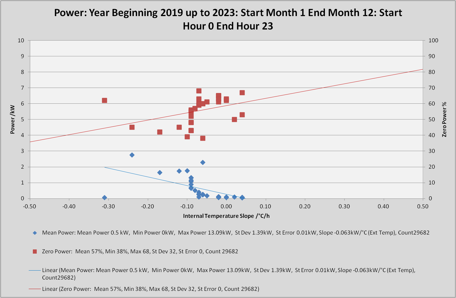

Power usage, which is a bit peculiar in a house with storage heaters, often show a warmer temperature in the mornings and it being cooler in the evenings.  As the data can be filtered by hour, the next three charts will show all times over the last four years, then after the heating has finished during the first two months of the year, up to near enough local noon, then local 14:00 to 19:00.
The x-axis is Internal Temperature Slope, the °C/h.
The above chart shows that as the internal temperature change reduces, less overall energy is needed to keep the house a a stable temperature. This is backed up by the times the house is using Zero Energy.  The Zero Power outlier on the left corresponds with an almost zero energy usage, and a greater temperature drop of just over -0.3°C/h, so the house was probably empty then.

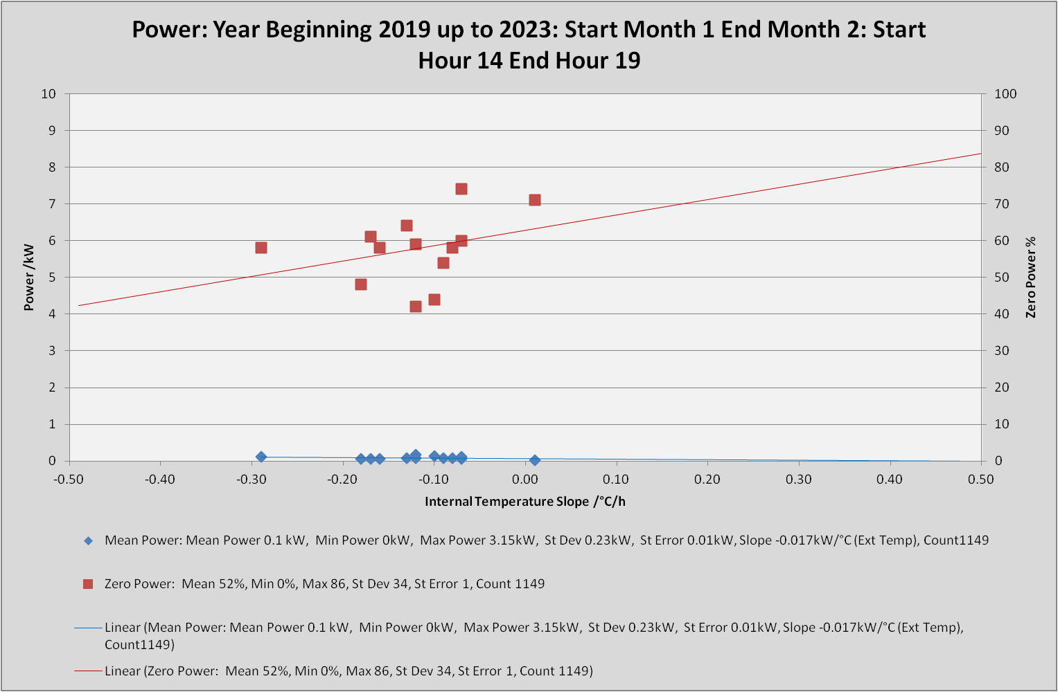

The 2PM to 7PM [6 hours] chart for the same period.
As the storage heaters have now not been recharged for at least 8 Hours and up to 14 hours, it is unsurprising that the house is starting to cool a bit more, with the energy inputs stretched out a bit more between -0.28 to 0.2°C/h, clustering between -0.18 to 0.07°C/h.  This is highlighted better on the next two charts which cover the same time periods.

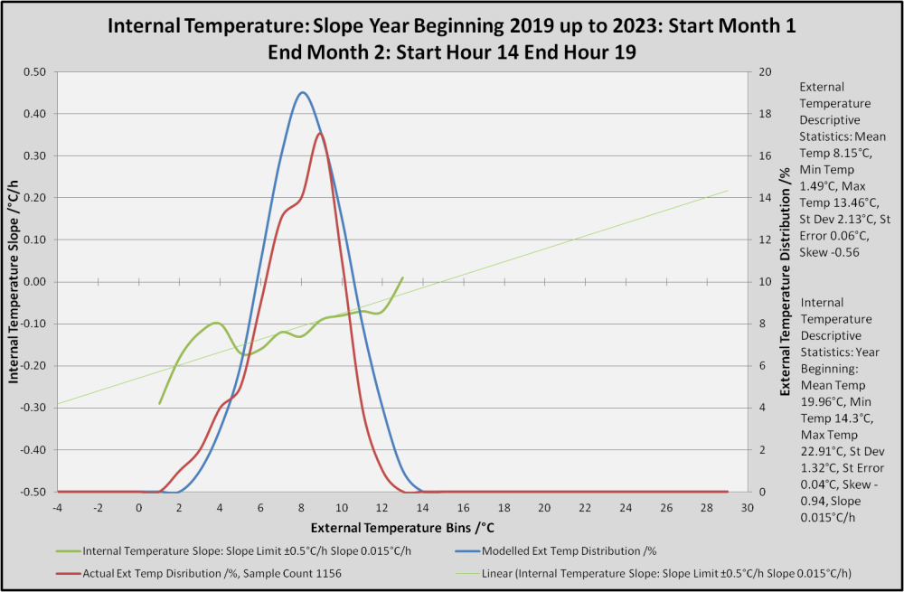

As mentioned above, because the storage heaters have not been charged up for many hours [between 8 and 14 hours], it is not a surprise that the house is cooling.
What is a surprise is that the relative cooling is so low at 0.015°C/h.  Part of this will be because the internal temperature has risen slightly to 20°C [my target temperature].  Allowing for the increase in the Standard Deviation of 1.32°C, up from 1.29°C in the morning, there is, in reality, no temperature change, and certainty not one that is noticeable.

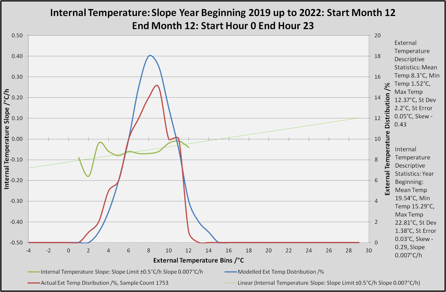

December 2019, 2020, 2021 Temperature Slope chart.

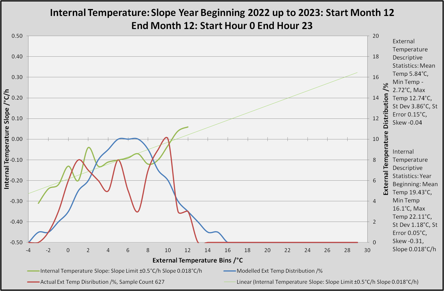

December 2022 Temperature Slope chart.
Pre improvements was cooler in the house even though the mean external temperature was 8.3°C as opposed to 5.8°C in December 2022.  The range of temperatures where much greater as well in December 2022.

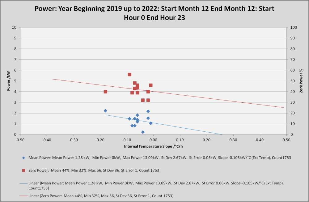

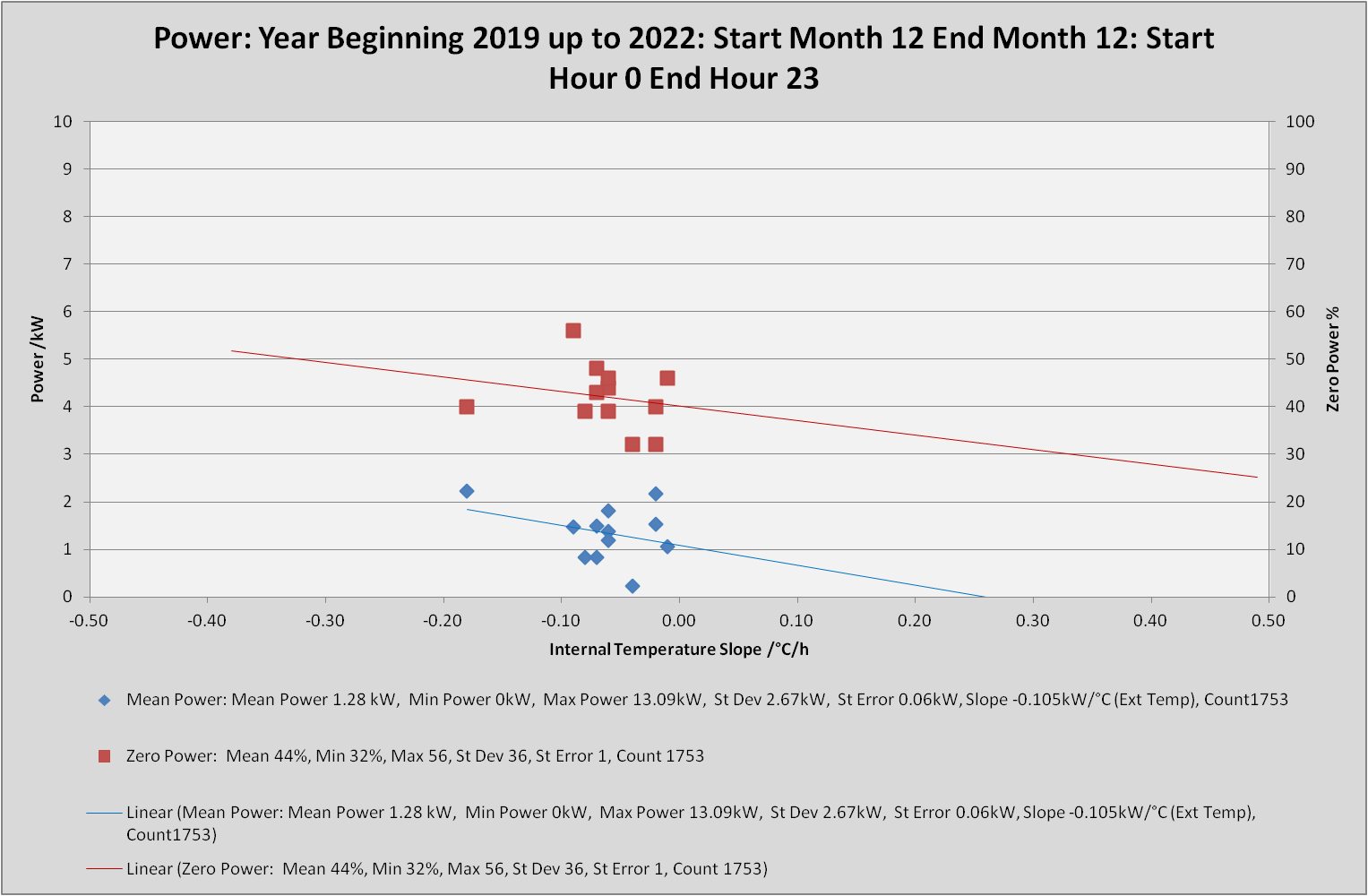

December 2019, 2020, 2021 Power Usage chart.

Mean power is now 0.85 kW, down from 1.28kW, a reduction of 0.43 kW or 320 kWh for the month.
The slope, on these power charts, shows the change in power needed for every °C change in external temperature.
That has gone from 100W/°C to 60W/°C.
Airtightness and insulation really work, and I am still getting the benefit of those improvements.
