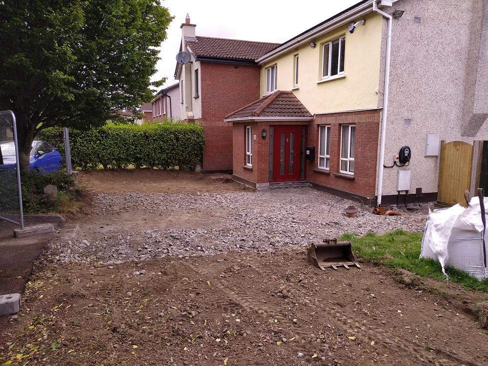

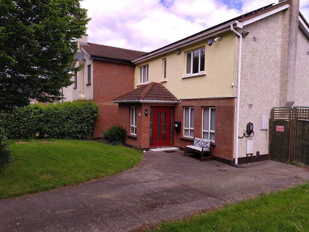

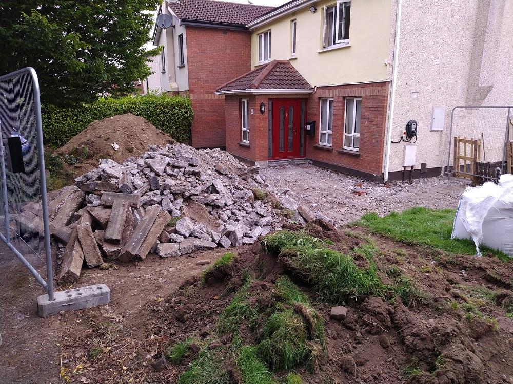

After following others journeys into the self build world for years, it looks like I'm finally about to embark on my own after several soft starts. The first major work is to realign the driveway and I've opted for paved over other styles and to do most of it myself. I got a driver & digger to take up the concrete driveway and grass and pile it up and hired a grab truck to take it all away. Less than two days later I was left with a barren front garden! Since then I've been figuring out a few details and grading the site to prepare for the required level of MoT. There was some damage done during excavation to be repaired which is underway. The current list of problems are:
- Get Earth Rod reinstated and connect house ground to it - Electrician
- Buy another wavin universal gully 110mm as the first was to replace one cracked during digging, this one is to replace the old one which doesn't have a swivel head and its at the wrong angle to the house and will make the paving cuts a lot harder to achieve and look wierd. The new ones let you turn the gully to different angles to run parallel to the house.
- Buy adjustable connector for linear drainage channel to connect to inlet of universal gully as they are nearly level but not quite.
- Trace broadband cable from house to a point where I can create an access point and run a pipe from there to my site next door (I tried digging to find it on the other side of the site to only find a gas main where it's not meant to be!). To dig this alternative position out tomorrow and see if it's viable.
- Decide if I'll keep the loose soil in the original broadband excavation hole or remove and replace with hardcore (I've asked this question under the driveways topic on this site)
- Hire concrete / kango hammer to remove concrete surround of manhole cover and replace with a recessed unit and gain access to drain on other side of house for linear drainage channel over there - the side of this drain has a mass of concrete beside it for an unknown reason.
- Dig out holes for more concrete posts to form new front boundary but mind electrical cable heading in same direction
- Assess how much MoT I'll need to build up 2 x 75mm levels on far side of site which was grass and will take the most vehicular traffic. The old concrete driveway sub base is still there and its nearly at the right level, won't need to do much to it except whack it a few times and it'll be good to go.
