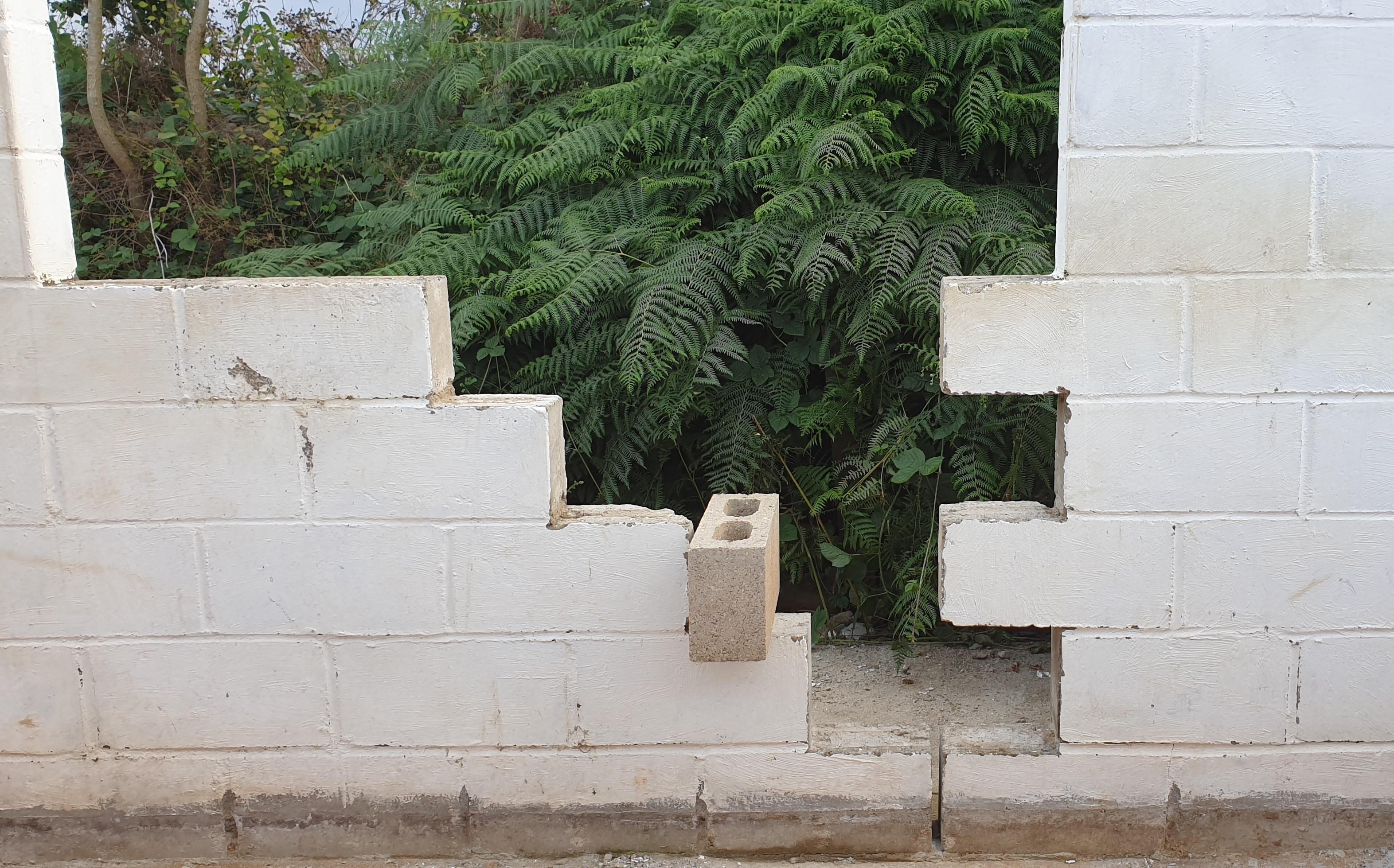

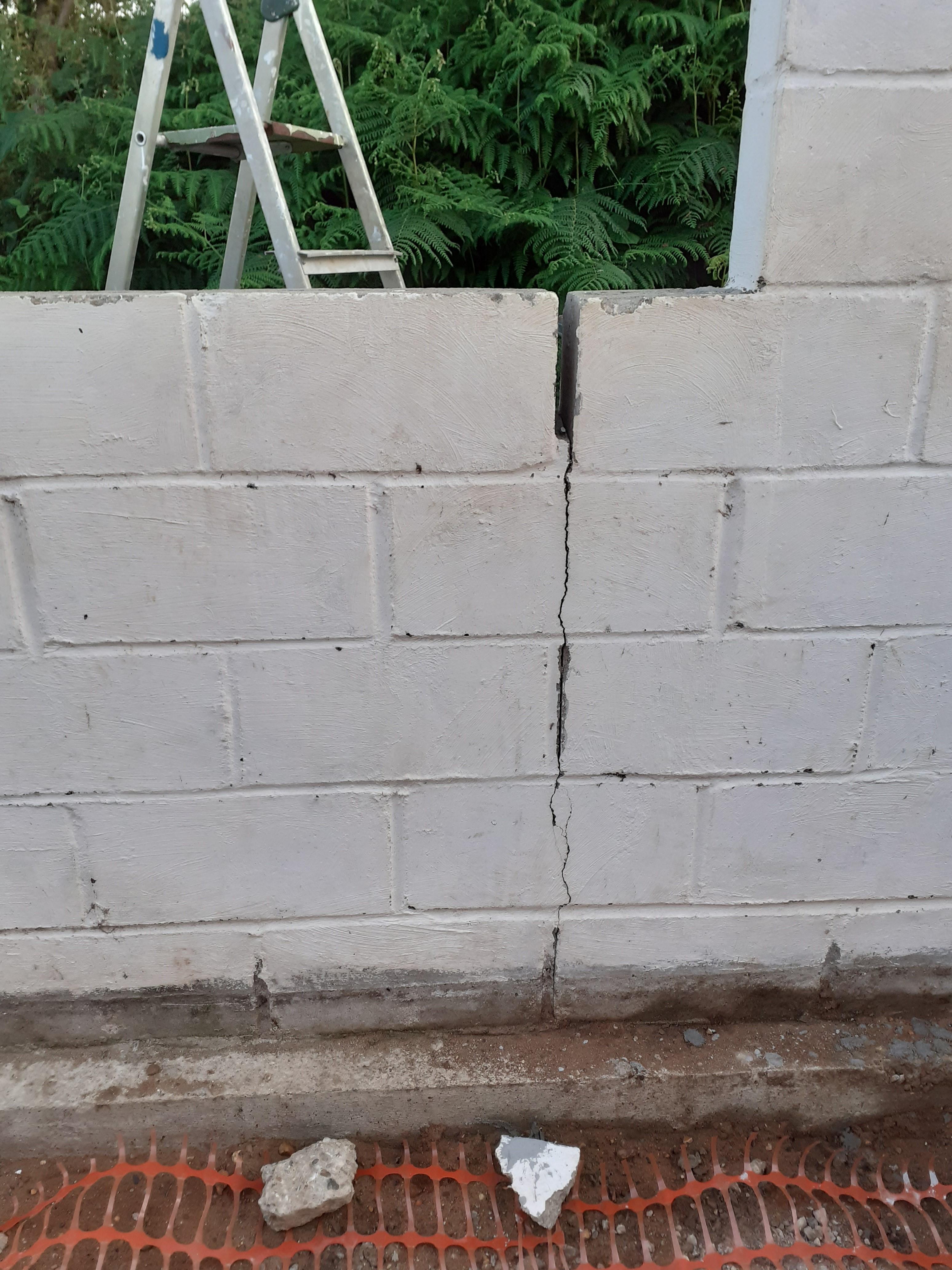

After looking in more detail when replacing some blocks we realised that the crack in the middle of the long back wall went from top to bottom and was not level, but luckily hadn't cracked the somewhat limited existing foundations.
Thanks to BH and advice we went from the plan to stitch to removing the whole section to replace.
So, from this
To this, and hopefully soon the gap will be no more.

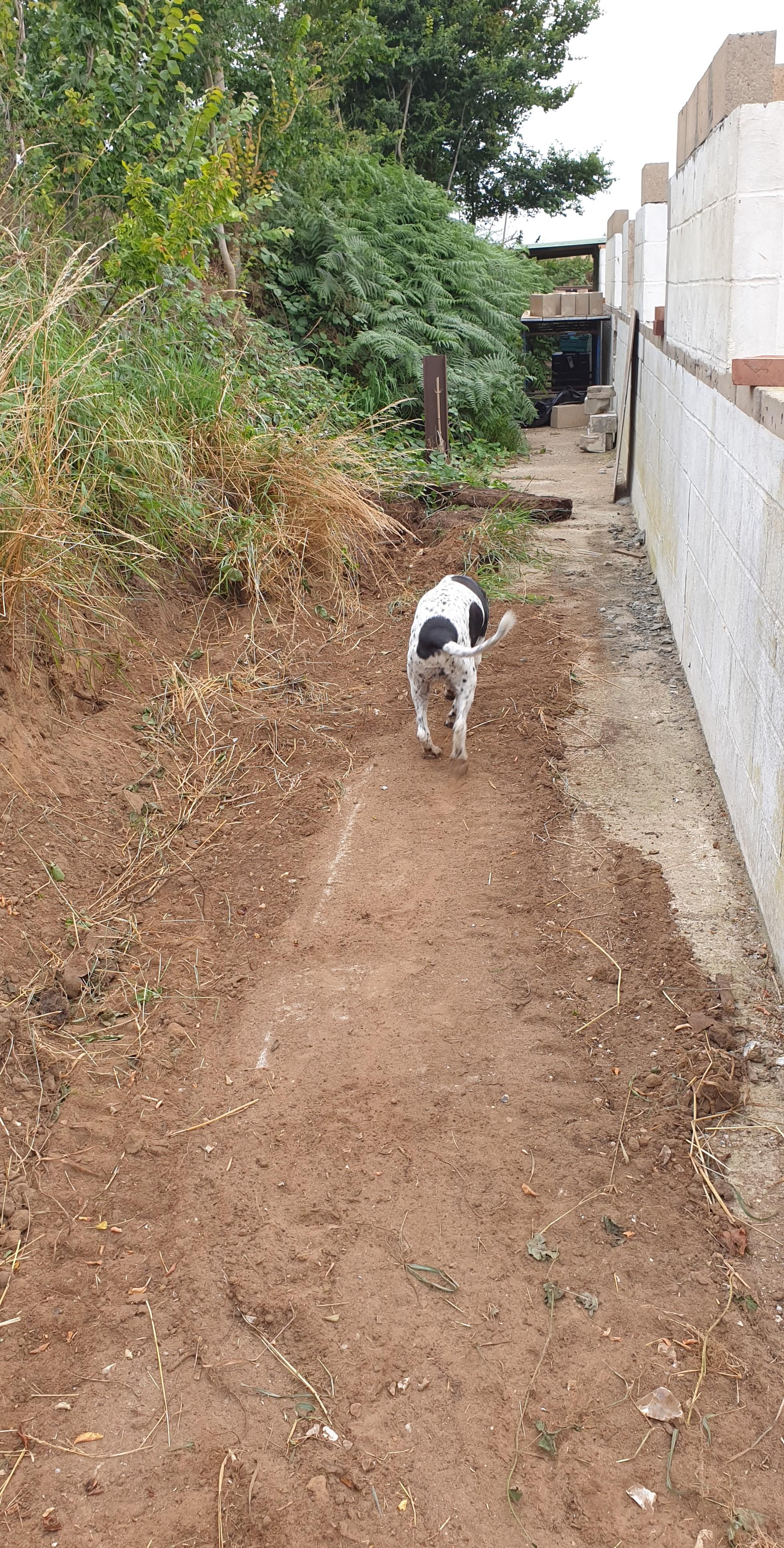

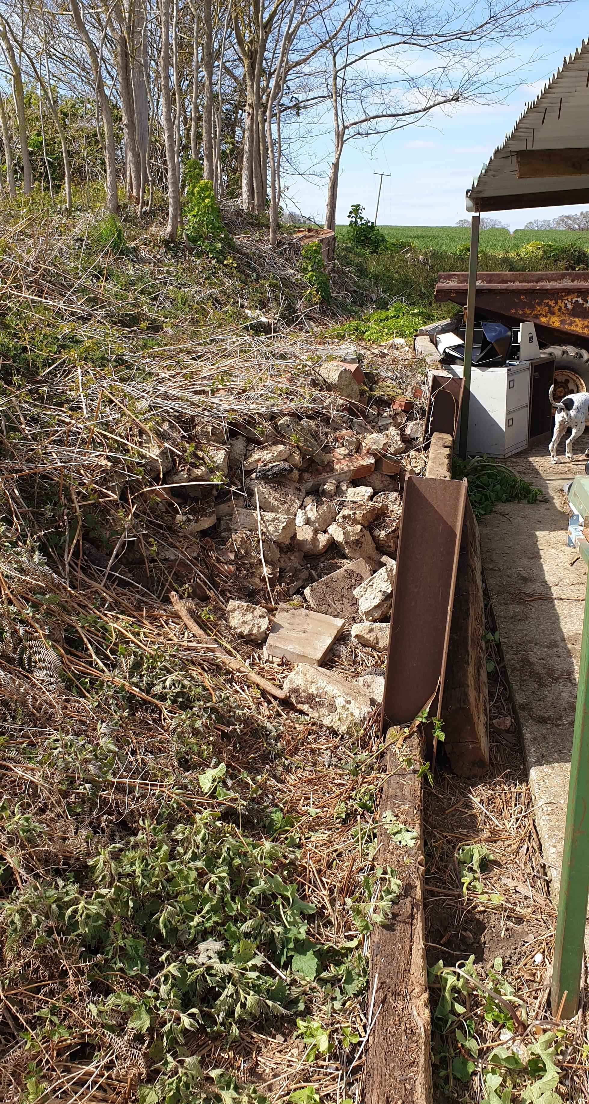

To provide access for drainage and just add more space on the back, which is south facing, we have been removing rotten sleepers and the steel girders which held them up.
This picture is back before everything started growing, now the whole bank has been covered in bracken as you can see in the picture above.
So again, from this
To this, which will ultimately be retained by gabions and cleared the whole length.
Getting out all the tree stumps, rotten sleepers and metal girders is quite a labour intensive task, thanks for diggers.
As of 2019 this stretch was completely impossible to get through with lots of weeds and tree branches growing through what is now our windows.
