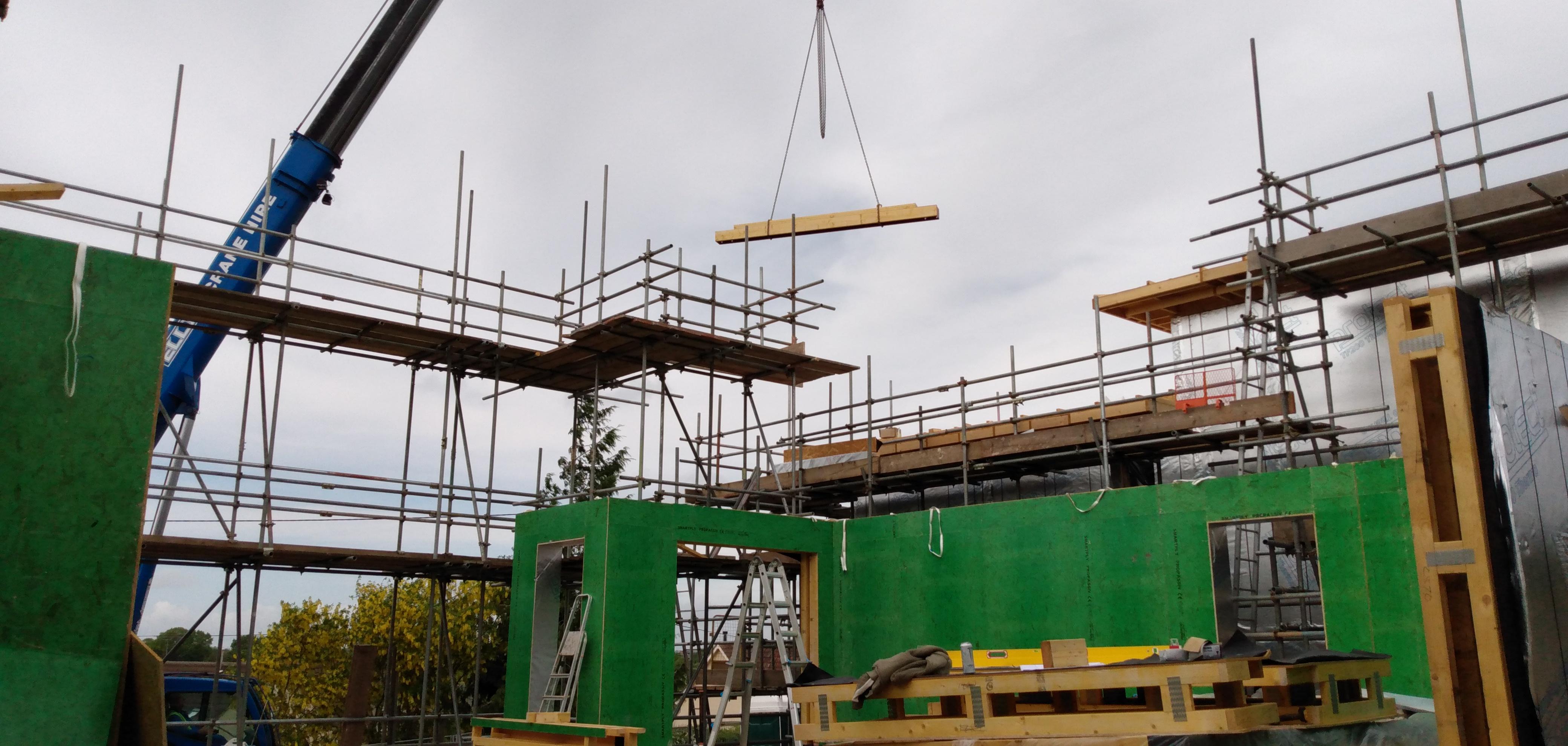

So MBC finished Plot 1 and moved over to Plot 2 - another big crane day and the lower floor went up in one day and the joist went on the next and then the boys left us for a long weekend back to Ireland as we  fitted the UFH pipes. Having done it once already the UFH pipes went in just fine and this time we didn't have to cut all the metal plates so it was a bit easier. Then the MBC team came back and fitted the floor deck and the sole plate for the top floor and then the crane came back for the top floor walls and roof. The wind came up and so we had to have the crane back the next day to finish off as wind is not your friend when you have to lift big panels up and over a three story building! The boys cracked on and decided to work the Bank Holiday weekend and try to finish by the Sunday. We had already had some comments on the noise and weekend working and had talked to our BCO so we posted a polite notice to say because of CV19 guidance we were trying to reduce travel of our contractors so they would be working through. A couple of neighbours were supportive and sympathetic and one of them even invited the boys for a socially distanced beer after work. We had them stop work for 2 minutes at 11:00 on VE day so exactly at that point one of the neighbours switched on his pressure washer - you cant make this stuff up!. Everything pretty much went to plan and after a heroic effort the MBC crew finished on the Sunday evening as promised and both houses finished to shell level in under 5 weeks - and they look amazing. We did our best to look after the MBC crew as they were in local B&B without the Breakfast (or any food component) - its never ceases to amaze us how well simply treating contractors like human beings goes down. We guess that some of their clients must treat them badly - but why on earth would you want to? After MBC left we  had a call from Environmental Health and it seems that some noise complaints had been received - it seems that the latest Government edict on allowing longer working hours on construction to get the economy moving only apply to Planning and not Environmental Health so we were suitably humble and promised to be good in the face of some very vague guidance. Given that we have been working on site since August and these are  the first noise complaints its obviously not a serious problem, and as we are self building under loads of pressure we will continue to do DIY at weekends - though as quietly as possible. Yet again we find we really do have one or two vile neighbours.

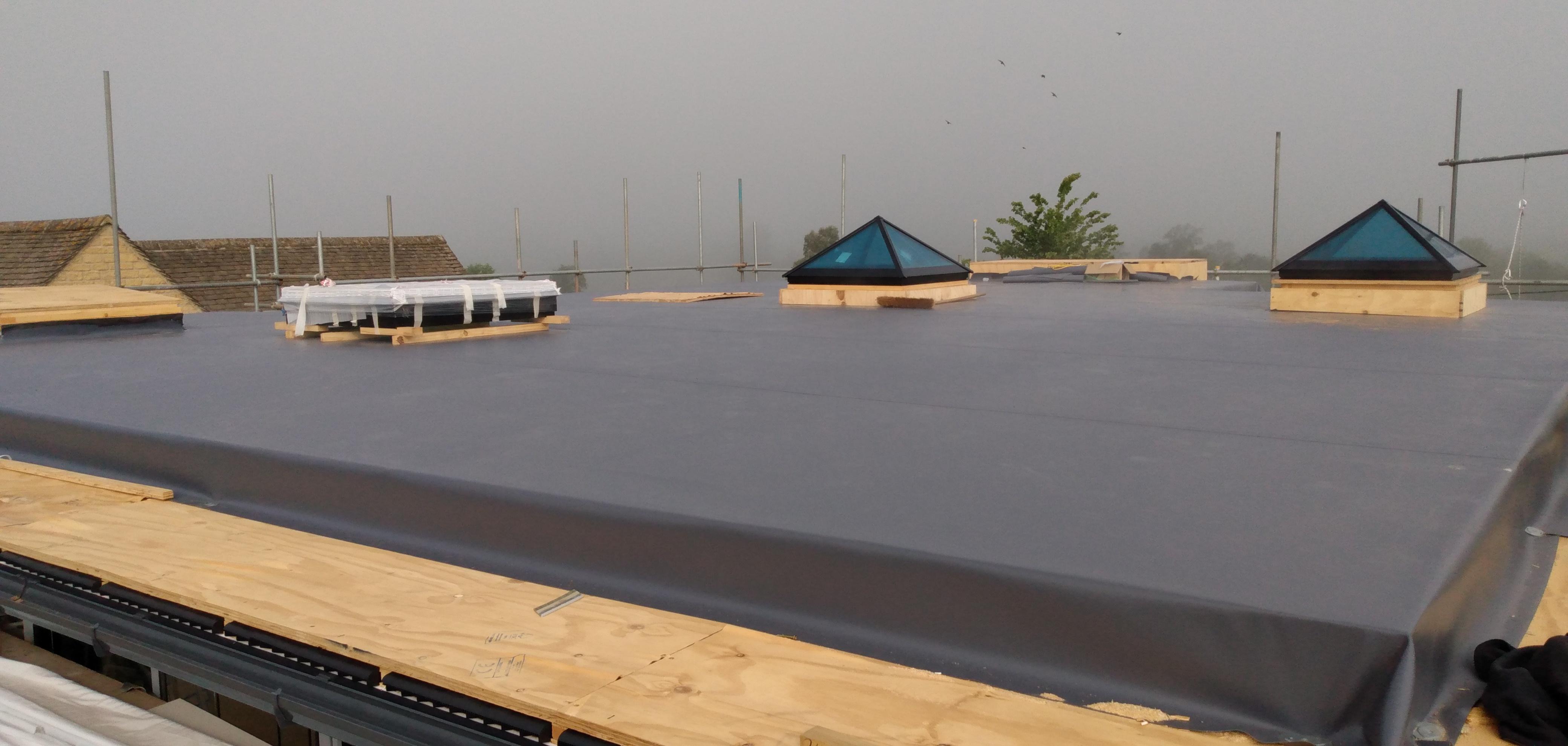

Roofing

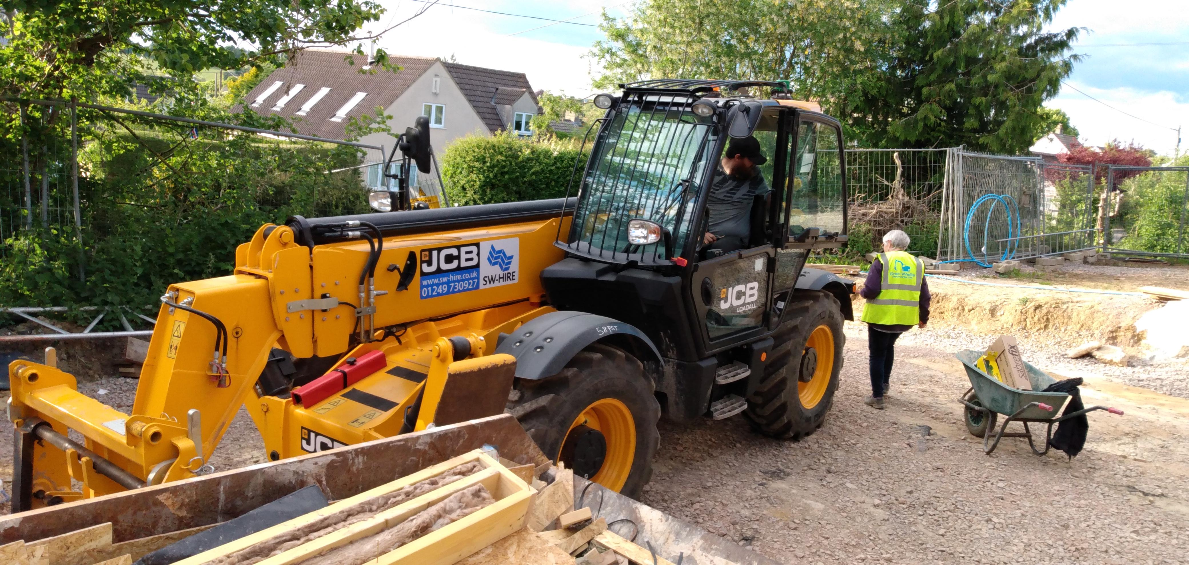

As we have a flat roof to keep the roof height at the same level as the original bungalow it has an EPDM (plastic / rubber single ply) membrane roof. This sits on a 24mm plywood deck on top of the MBC flat 12mm OSB roof and the MBC firring strips - which slope the roof slightly to get the water to run off. Sounds pretty simple but as with all these things its not so simple. First you need airflow in the gap between the two deck layers so there is no condensation to rot the timber - for this you need plastic soffit vents around the edge to stop the bugs and birds getting in so Joe and Chris fitted all these. Then you need to think how you get over 4 tonnes of plywood 9m up and onto the roof (plus all the rolls of membrane etc) and our roofers said they would do the roofing but not the lifting. Simple solution here was a tele-handler which is a huge forklift that makes short work of this kind of thing - just hire one - simple. But then you need a driver - again simple: one of Joe's colleagues Andy drives one all the time on musical festival sites and is qualified and was happy to come over to help out. So Andy and the roofers turned up and after a bit of delay the first pallet of ply was lifted onto the roof and they were away. Again a good crew who worked really hard and seem to be doing a great job. They have spent a week and plyed and membraned the main part of both roofs so we almost have a dry roof. It was really hot on the roof with no shade so ice-cream went down really well (and for us as we were up there working as well). They still need to do all the fiddly bits like rooflights and soil stack, plus all of the top of the oversail roof but the bulk is done. One wrinkle here is that the rear bay on Plot 2 has the same oversail detail and MBC couldn't fit this because the scaffolding is in the way, but we couldn't take down the scaffolding because we needed it for roofing the main roof on the floor above. So when the main roof is done we will have the scaffolders back to take down the back corner and then MBC will fit the roof and then the roofers will come back  and fit that section of membrane roof. Oh how it all gets really convoluted and complex really quickly. Finally to add to the simple / complex plan we had the roofers and the window fitters start on the same day - what could possibly go wrong!

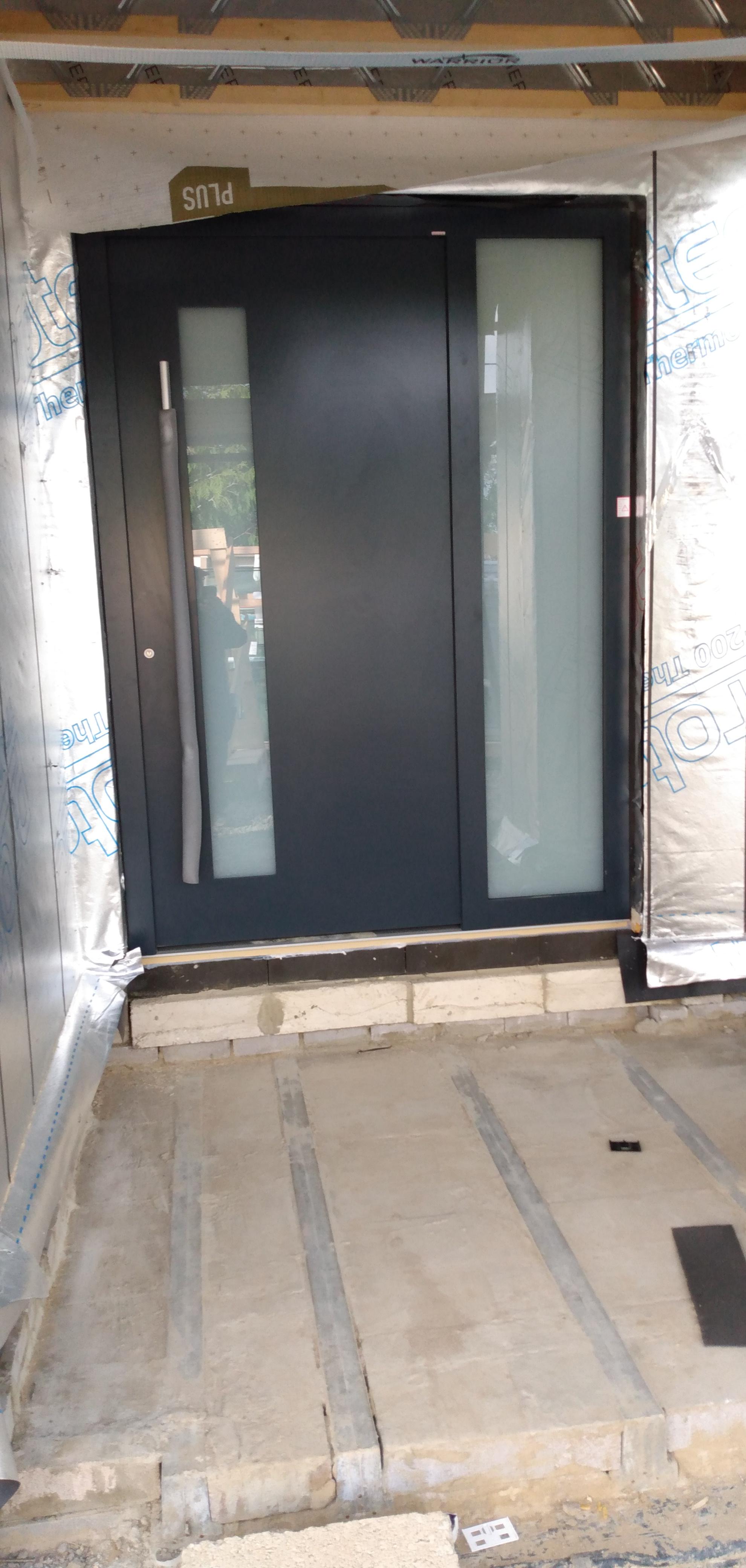

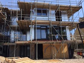

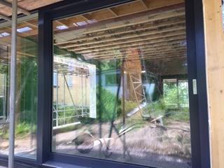

Windows

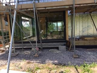

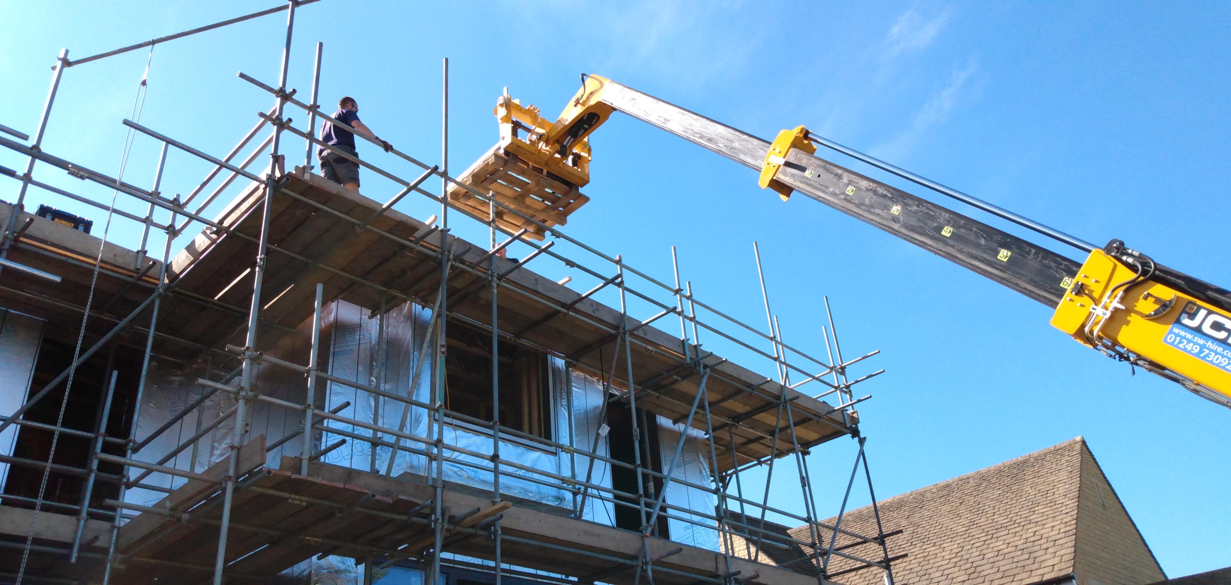

The EcoHaus Internorm surveyor came out and lasered around and said that the rear bay window on Plot 1 was 30mm too low and the three windows wouldn't fit. Some checking and it was an MBC error that they happily agreed to fix and Brendan popped over and spent a morning cutting 30mm off the underside of the 3 sided glulam frame in situ and in mid air with a skill saw. We were apprehensive about the sort of job he would do but skill saw is an understatement when it comes to Brendan: two saw cuts one from each side that met perfectly in the middle - truly fantastic work. So one week after MBC had finished EcoHaus Internorm arrived to fit the windows (same day as the roofers - but the windows arrived first!). Their plan was to fit all of Plot 1 windows and then move to Plot 2 - but they were all over the place fitting windows at what seemed like random. We had some of the scaffold moved to make space for them and they seemed happy - and we said if they needed anything at all just to ask. So we were working around the back of the house when we heard an almighty crash and ran to see what had happened. They had asked Andy to lift a huge pallet of windows up above the garage level (about 2m) so they could load them through the window opening. During the unload one of the fitters stepped off the scaffold onto the pallet. The load slipped and the windows fell. Included in this fall was the  fitter who had stepped onto the pallet. Ongoing discussions with EcoHaus preclude us from saying much more about this except to say that mercifully the fitter was only bruised and a load of windows were damaged (no glass broken though) and will need replacing - it could have been much much worse. They carried on and then discovered than one of the huge panes of glass for Plot 1's rear slider was cracked in transit from Austria, and also imageproxy.php?img=&key=f5f06bfe2c42e69cthat there were no bolts to fit Plot 2's Juliet balcony. Finally, and this is my fault; the front door for Plot 2 is handed wrong and will need a new frame. So they finished fitting what they could but we have three gaping holes awaiting replacements and a bunch of other stuff that needs rectifying. We have to say that the quality of the actual windows is fantastic, but the experience has not been good so far. Just to contrast this with another MBC issue: we discovered that the kitchen window on Plot 1 didn't fit and there was a 300mm gap above the head of the window (window surveyor didn't spot this one). Well after MBC had left site we discovered a 300mm panel that didn't seem to have a home! Quick call to MBC and yes this was the missing piece, they apologised and Mike came over the next day, apologised some more, fitted the panel and problem solved. If only all the people we deal with had the same attitude then it might all be simple!

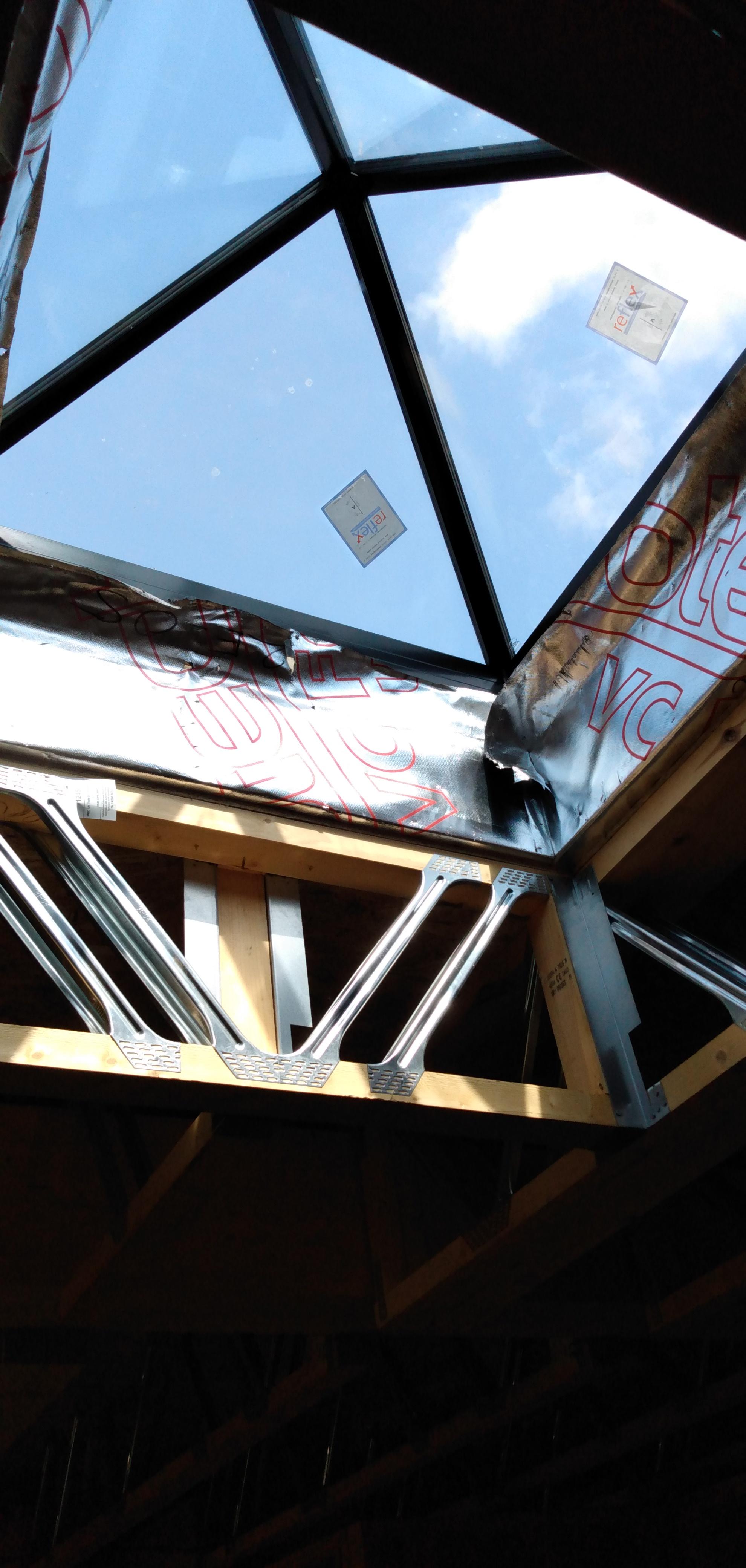

Since we have been on a cost cutting mission we have taken on much more of the 'doing' ourselves and keep trying to cut costs where we can. One of these is the guttering etc. the original plan was powder coated aluminium. However this would have been about 3x the cost of plastic, and given the really complex oversail roof detail this would have been really expensive to have fitted. So, and with some real reluctance, we have gone for plastic gutter and soffits and facia. We would be the first to admit it doesn't look as good and will not last as well as aluminium but it is 9m in the air and nobody will examine it in detail. Its likely we will compromise and fit metal gutter to the rear bay (when its finished) as this will be almost at eye height and will look much better. So a mad rush as the three of us have been busy fitting all this and trying to keep half a step in front of the roofers who need the gutter fitted before they can membrane the oversail roof. The reality is that the plastic looks really OK - though we are somewhat mystified by the physics of fitting a flat gutter all the way round the roof - anyone done this? We had to call a stop on Saturday as the wind was really strong and the plastic panels wanted to take off and it really wasn't safe. Also as part of the roofworks we  have 4 rooflights on the roof :- 3 fixed pyramid lanterns, 1 on Plot 1 over the stairs and 2 over stairs and landing on Plot 2, plus one flat sliding opening rooflight over the en-suite on Plot 2. The fixed lanterns were flat pack so we have just brought all the parts up onto the roof and built them in-situ ready for the roofers to flash the membrane roof around them. The sliding light was ready built and is really heavy and a 4-man lift so MBC helped unload it and store it and the roofers moved it to the tele-handler and we hoisted it up to the roof and they moved it to a point where its a really simple install. We have had to build the upstand / kerbs for all of these so they fit exactly into place - and we were able to test this with the empty frames. We have just placed the completed unit above the landing and it really looks great - the one above the stairs will look great but at the moment the hole is covered with ply as there is a 9m drop below it and we dont want to leave that open for obvious reasons!
