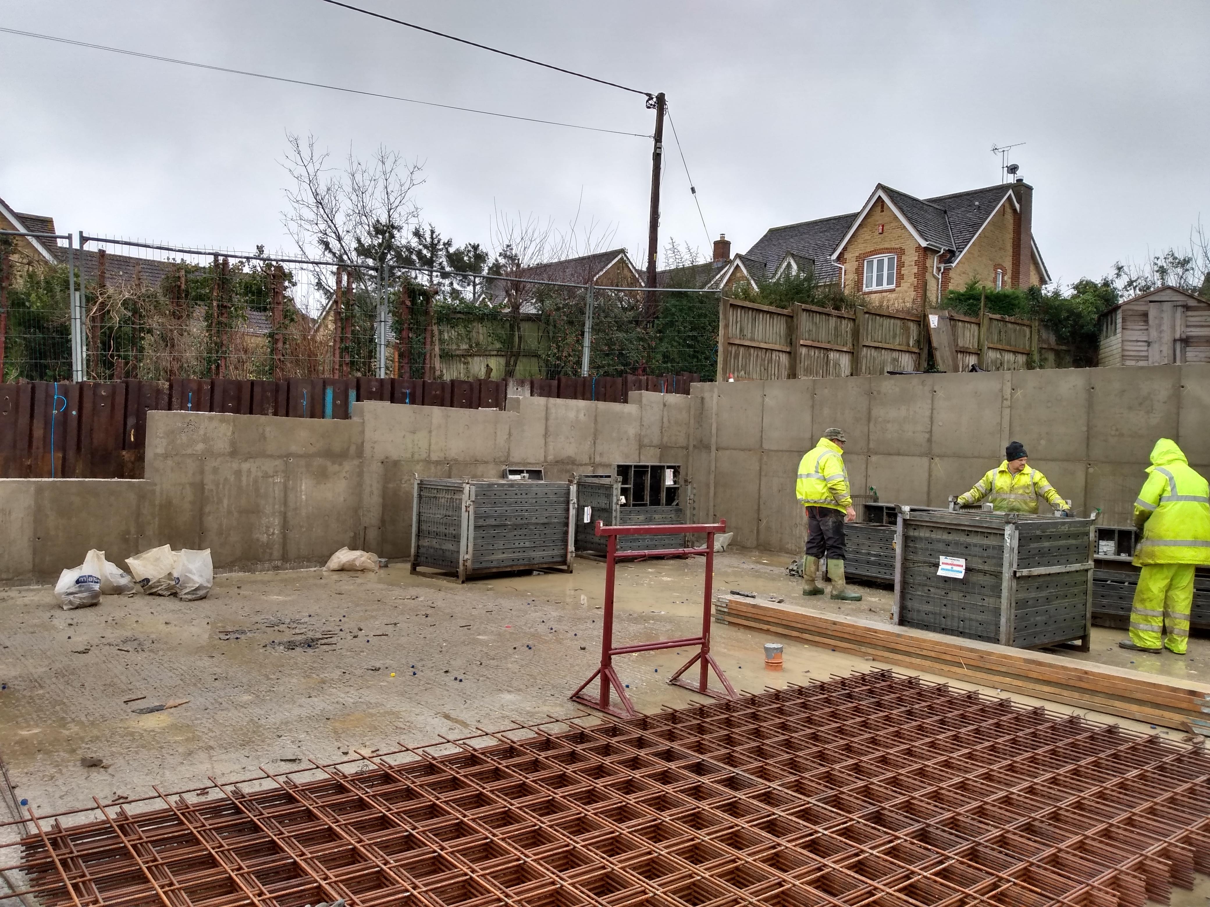

Progress on site has been a bit slow so we have combined the last two weeks together, and also the guys packed up early on Friday for their long and well earned  Christmas break. Over the last two weeks you can see them taking down the last of the shuttering and getting it off site. So that is the end of the poured concrete for us which is a big milestone and you can now see the full extent of the basement / foundations. The next step was to put a fillet of mortar all around the outside of the kicker to get a smooth edge for the membrane, and then prime the outside of the concrete in black. Then they have started to put on the external tanking membrane which has been a real challenge in the wet and cold. At one point they resorted to putting the membrane in the digger cab and running the heater to get it flexible and warm. They managed to get the left hand side wall completed and the first job next year will be to put the French drain around that side and backfill with clean stone so they can get around to the back and continue the tanking. They then need to build the internal walls out of blockwork and then the beam and block floor ready for the Timber Frame. So given a really wet autumn progress is pretty good; the guys have worked really hard  and though it has taken longer than we thought, we are pretty happy. Now it all depends on the weather in January!
The waterproofing guys inspected the concrete and declared it 'near perfect' so looking good for the warranty. Also the BCO and Structural Warranty folks all seem happy so that is comforting. They seem impressed, as we are, with the quality of the work and the attention to detail - which, given the weather, is a huge credit to the guys on site. And whatever the weather they are cheerful and work really hard. Are there any convention out there on how you treat your contractors? - we make sure to drop off cake or cookies to them about once a week, and even mince pies for Christmas!
It also looks like we have finally got some drawings to sign off from the TF company so just waiting on our SE to agree and we can push the button to get it into production - so likely to see it in Feb. Similarly with the windows - we have a complete schedule that looks good and though it has taken ages the window supplier, the TF supplier and our Architect all see to be in agreement - fingers crossed they all fit!!!! And they are on 12 - 14 weeks lead time so likely in March!

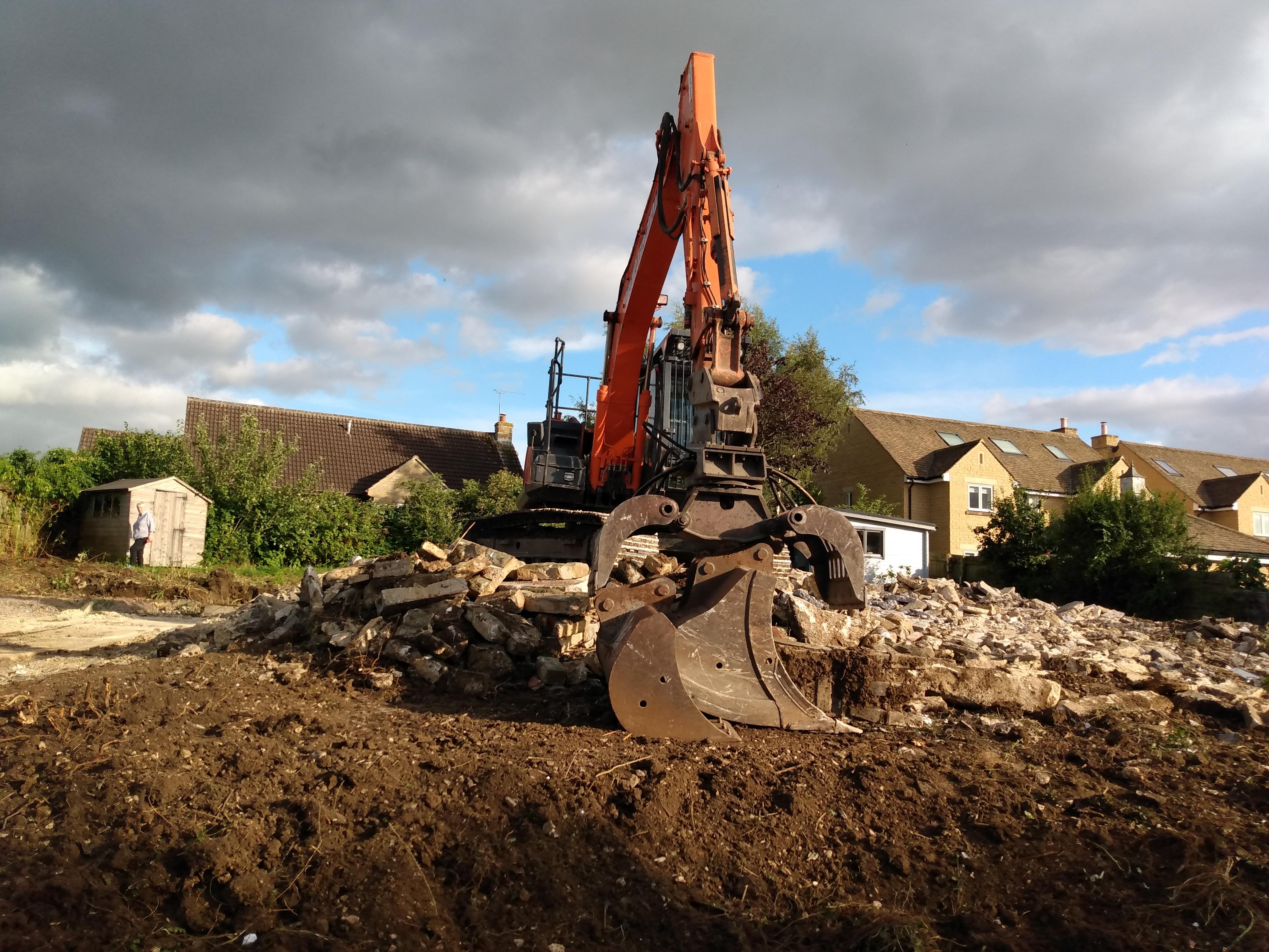

And as an extra special Christmas treat the entire 13 weeks of 2019 Groundworks videos are compacted down to a 3 minute video summary named  2019 (  https://www.dropbox.com/s/jbvjhdxn1dyrufm/2019.mp4?dl=0  ) Its much too quick to capture the detail but it give a really rapid view of the progress we have made this year - starting after the demolition in October. So still a way to go - but moving forward is so much better than having your soul ever so slowly destroyed by the Planning process!
So From This
