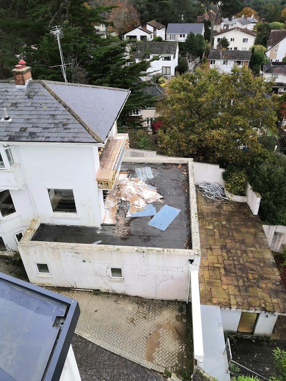

And... we're off - Demolition Time
Wow - time goes fast! I guess I'll say that again....and again!
We submitted the revised planning app - free as within a year - and that was approved with no comments. The revised design removed a couple of windows which has pleased the neighbours. Engineer co has been working with the architect so we have made a lot of progress in design terms while we did the planning app so had building regs design approval ahead of revised planning approval!

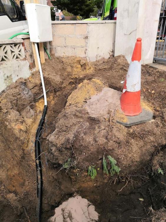

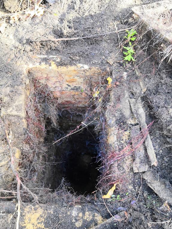

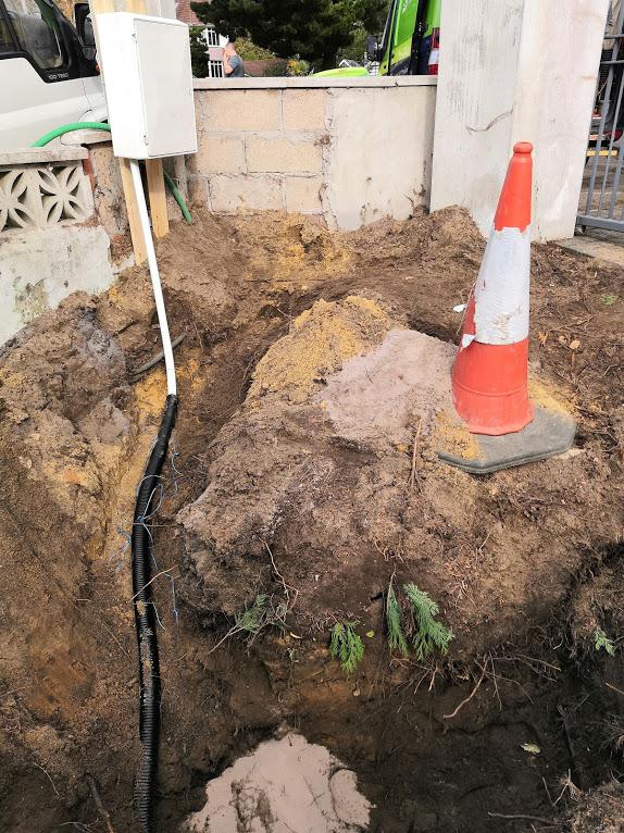

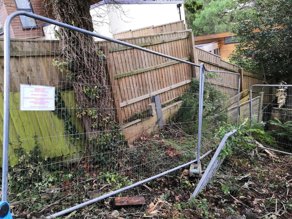

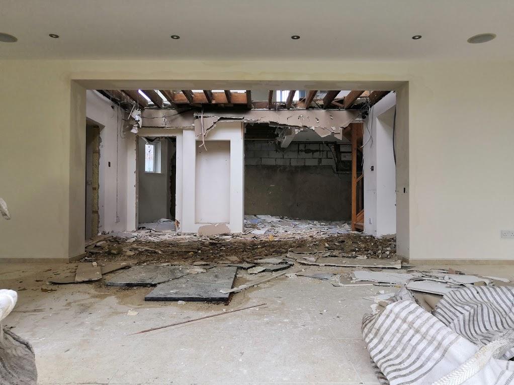

In prep for the demolition I (with my helpful neighbour and his digger) sorted the services which included stripping out the front garden and some trees (these ones without TPOs!). We managed to have a lot of the house re-used by people building near by - internal doors, UPVC patio doors, kitchens and bathrooms - trading for some labour later. Plus my neighbour fancied the 20+m of balustrade - he's got the digger so that + some of his time and experience is a good trade! We have a pump station serving the lower 2 floors, sadly the location needs to change but the pumps and control system will all be reused so need to get the pumps out - pretty sure the tank will be wrecked coming out but that if that's all we need to replace that will be a good result.

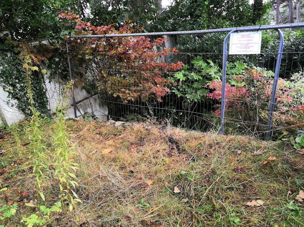

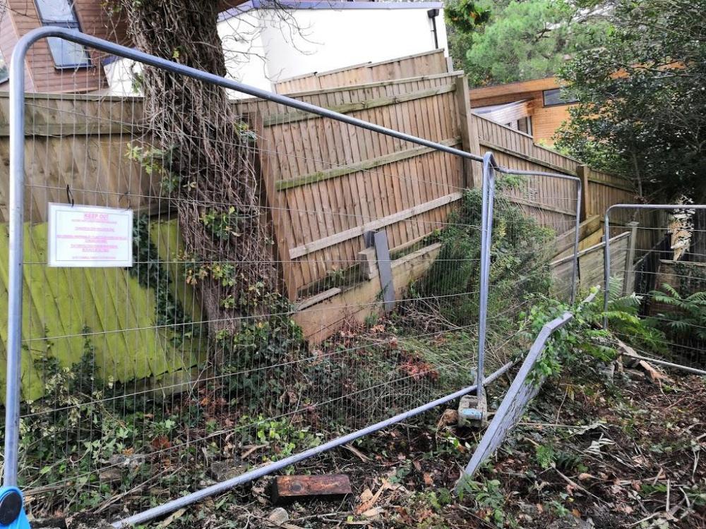

Demo firm engaged and they are fantastic (so far anyway) who have stripped out the inside while I worked frantically to get the pre-commencement conditions satisfied. My helpful (seriously) planning officer confirmed by email that we could do trenches for services, strip out internals etc without being classed as having "commenced". this week we had a meeting with the tree police to inspect our tree protection measures and check the working arrangements - I prepared a nice report for them and that went well so we can officially crack on with the demo. Time lapse camera installed on neighbour's roof (Brinno - seems a great product).
Currently harassing engineer to provide reinforcement detail for floor so I can get quotes in for steel and ground works.
Next week the demo then will be underway and I'll be trying to finalise the drainage design + spec for the floor slabs...
Oh - CIL rules changed so our liability would have tripled! But all sorted now and next form for them will be after we finish.
