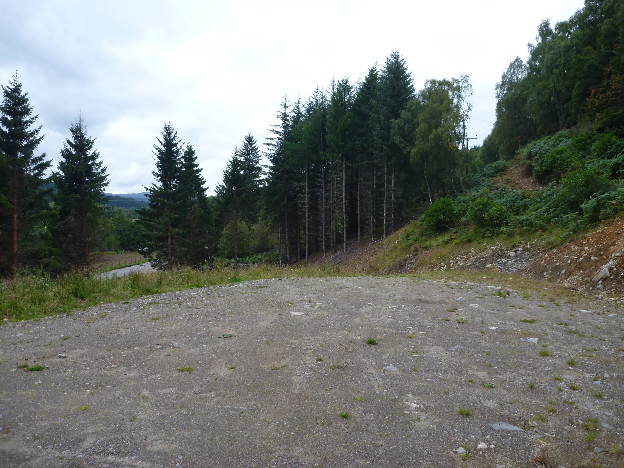

We're at the beginning of the self build process, up in the Highlands.  We have a site that has full planning and we have quite a few ideas, so for now it's cracking on with a lot of research.  We originally acquired the land as a bit of an exercise in woodland management, specifically with the long-term aim of developing native woodland and productive timber (though we might not see it in our lifetime).  The planning is almost a bonus,  living on site will make the woodland worl easier.
We've found an architect to help work up some plans with the aim of getting a building warrant by the end of the year.
Currently we're pondering:
  • What the best way of integrating a wood burner, solar (thermal and/or pv) and potentially ASHP is.
  • Whether we go for a completely off grid electrical system or pay SSE an estimated £15-17k!
  • How much of the build we will do ourselves and what sort of construction method we go for.  We will be using timber in one form or another.
Lots of things to think about and probably loads more.

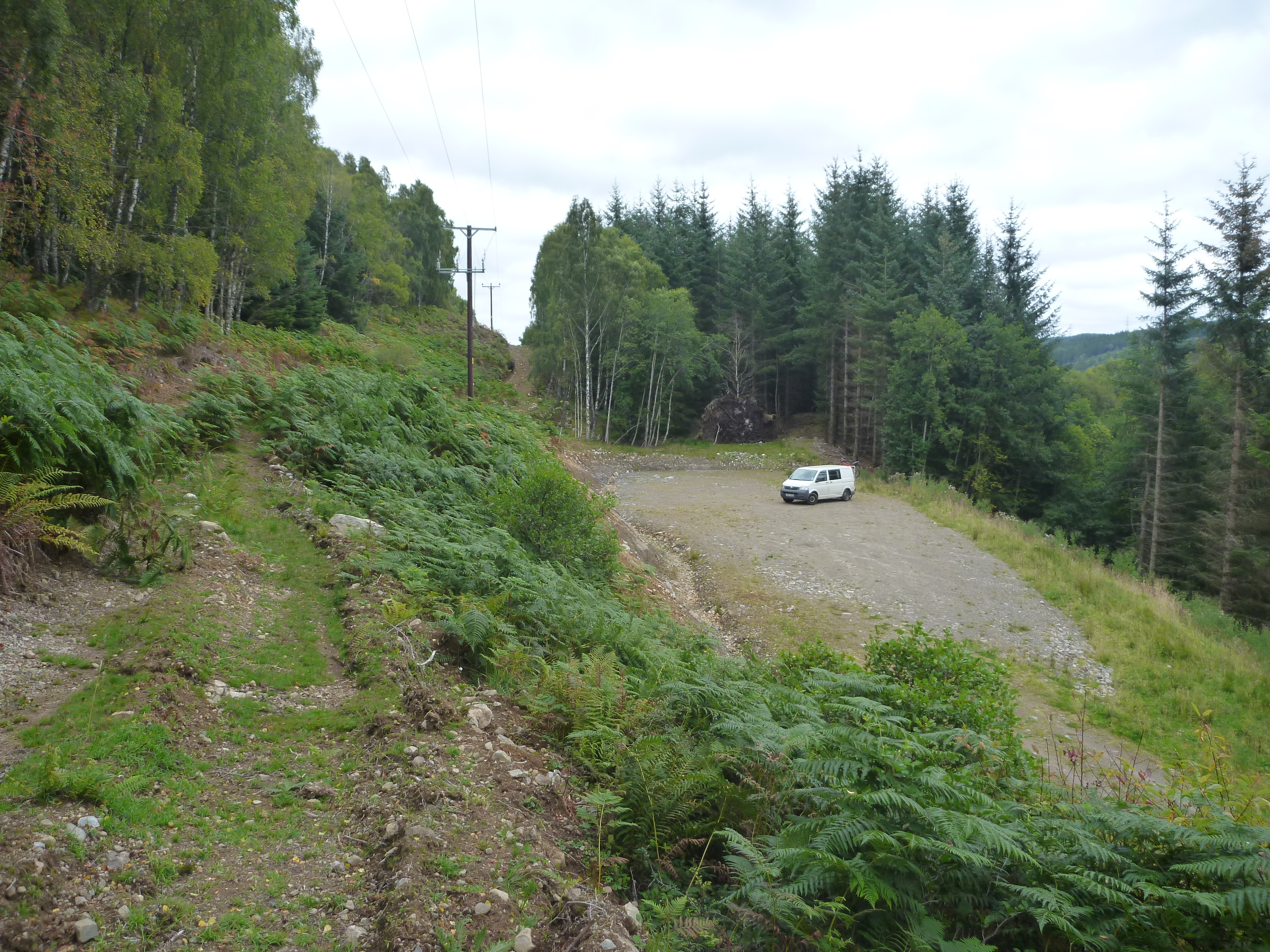

You have a 3 phase 11KV line there. Why do you think it is going to cost you £15K for the hydro to hang a transformer on one of those poles and drop a feed down to your house?
A local build here cost £10K for the supply but that included undergrounding a section of the 11KV line that was in the way for his house. You don't have to do that so your cost should be a lot less than £10K

As we don't have plans for SSE to give a firm quote, I asked them for a budget estimate and that's what they told me.  So perhaps they quote on the high side to cover themselves at this stage.  Admittedly  there was no breakdown from them and so I don't know how the contestable/non contestable elements would work out.  I also haven't spent much time pressing them on the cost although it will be worthwhile at some point.  This was what they said they needed to do:
  • Shutdown the network and tee-off existing pole X, and install a stay.
  • Install a new overhead Extra High Voltage line, consisting of 1 span, 1 x stout terminal pole, 1 x stay.
  • Install a new 16kVA transformer to take the new load of supply.
  • Take a connection from the transformer and lay new single phase service cable to the new 100 amp cut out.
  • Customer to excavate and reinstate all tracks at no cost to SSEN.

The bit in bold seems unnecessary.  Why take a spur to another pole.
All I see in this situation usually is the transformer mounted onto one existing pole. You don't want them adding extra overhead lines across your land. They may need to add stays to that pole but that is usually the extent.
You could do as some of us have done here. Make your meter box a permanent structure on a bit of fence or wall close to the pole. You can use it as a site supply there to start with then take your own feed from the meter box to the house rather than getting your supply moved.

Thanks to you both for the replies.  @Thedreamer  - it needs a lot more investigating from me and working out how they've come up with that number.  We will be the only people using that transformer I reckon.  As both you have @ProDave have mentioned I'll take a look into siting a meter box elsewhere - space is thankfully not a problem so it would make sense.  I think they just threw together a cost fairly quickly, as we couldn't give them much of a plan.
