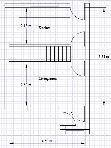

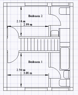

Interesting.  My house is 3.5m wide inside, that 'narrow' house in the drawing is 2.9 m wider.  Not what I would call a narrow site.
Link to comment
Aye...interesting: perhaps a plan? The one shown in the link was probably built for Hertfordshire County Council (an enlightened outfit...you cannot ever imagine a private house builder even considering such a thing) and they would need to adhere to strict Parker Morris standards of the day. I guess you could narrow it be a 2-3 feet at a push. Also British Gypsum make (or did) PDP, a form of partition 57mm wide which, they say, performed acoustically as well as a 100mm timber partition.
There was a terrace of 20+ of these...One sold a few years back (The modern House...estate agents) as a listed building. The owners had put a glass roof over a courtyard too...almost an extra living room! You can follow up similar house forms in a cracking little book called 'The Modern Courtyard House' by Duncan MacIntosh...if you can find a copy. Cheapest on ABEbooks is over £50...err posted from Australia: or your local library perhaps.  Worth digging!

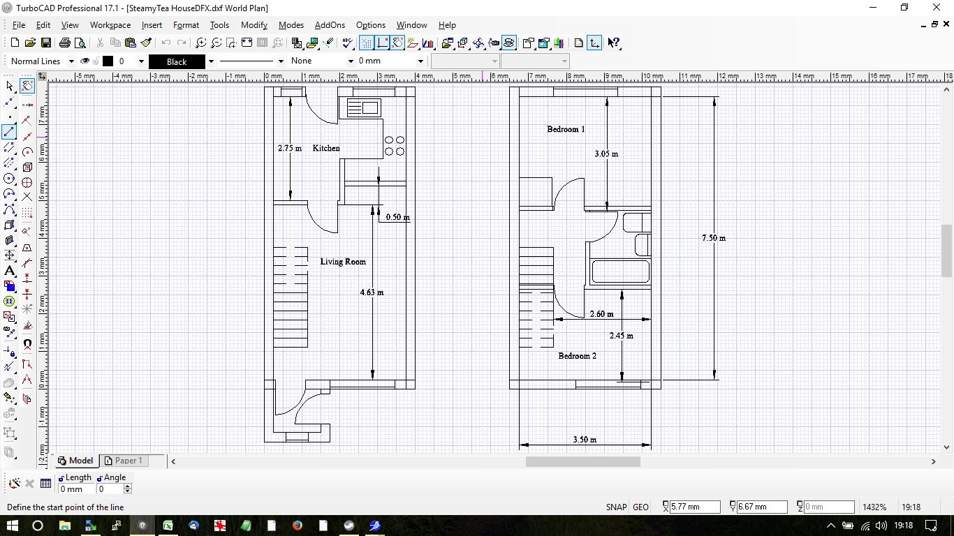

Hopefully you can open this and it makes sense. You will need to change the .txt extension to .dxf (can we change it to allow some CAD formats to be uploaded please).
Basically a 8m by 4m two storey box.
A little wider and I could turn the stairs around though 90° and stop the living room being a corridor.
SteamyTea HouseDFX.txt
Edited by SteamyTea
Link to comment
Did you change the file extension to .dxf, then open it up in just about any CAD package.
Here is a screen capture anyway.
No hurry, I am not charging you for this :D
Link to comment
Trouble is that they are open (though easily solved), so noise transmits upstairs.
What would be better was if the stairs cut the house in two, a front and back.
Then move the kitchen to the front and have a totally separate living room at the back.
Trouble with that is that the parking is at the back, so no one uses the front doors.  So maybe living room should stay in the front.
One problem is that a normal sofa is just a bit to wide to go across the front wall, and when it is on the long wall, it makes a narrow room even narrower.
A bit of space could be made upstairs by getting rid of the airing cupboard and cylinder, making the larger back room a bit larger.
But the real problem is that the living room is a corridor.  Fine when I am on my own (I never use it anyway) but then other are in the house it it a bit intrusive walking past friend, lodgers or family.
