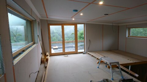

I've got all the socket wiring now in place, and the soundproof plasterboard up where I wanted it on the upstairs bathroom and bedrooms. Coming to the realisation that boarding out the huge open space above the stairs is going to be "interesting" when the time comes! But with some of the plasterboard up, we are really getting a feel for the room sizes and it really feels like progress.  Our daughter is now at University and is gutted she can't be helping - she really enjoyed helping.. So thanks to the wonders of technology, I took my mobile and gave her a visual tour of the house last night on skype.

Sounds good! Plaster boarding is pretty rewarding as you say, you really start to get a feel for rooms.  We got a bit inventive for our lightwell and staircase and built out a temporary platform. Might be an option?
It may be obvious but start at the ceilings and work down. As above we put up a temporary platform over the stair well and moved it lower as we worked down. This is where every self builder needs his own scaffold of a scaffold platform.
You also need a pair of dead men, or a plasterboard hoist to make life easier (we are just using the dead men)

Thanks - Just looked "dead men for plasterboard" up and will make a couple.
