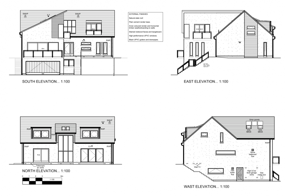

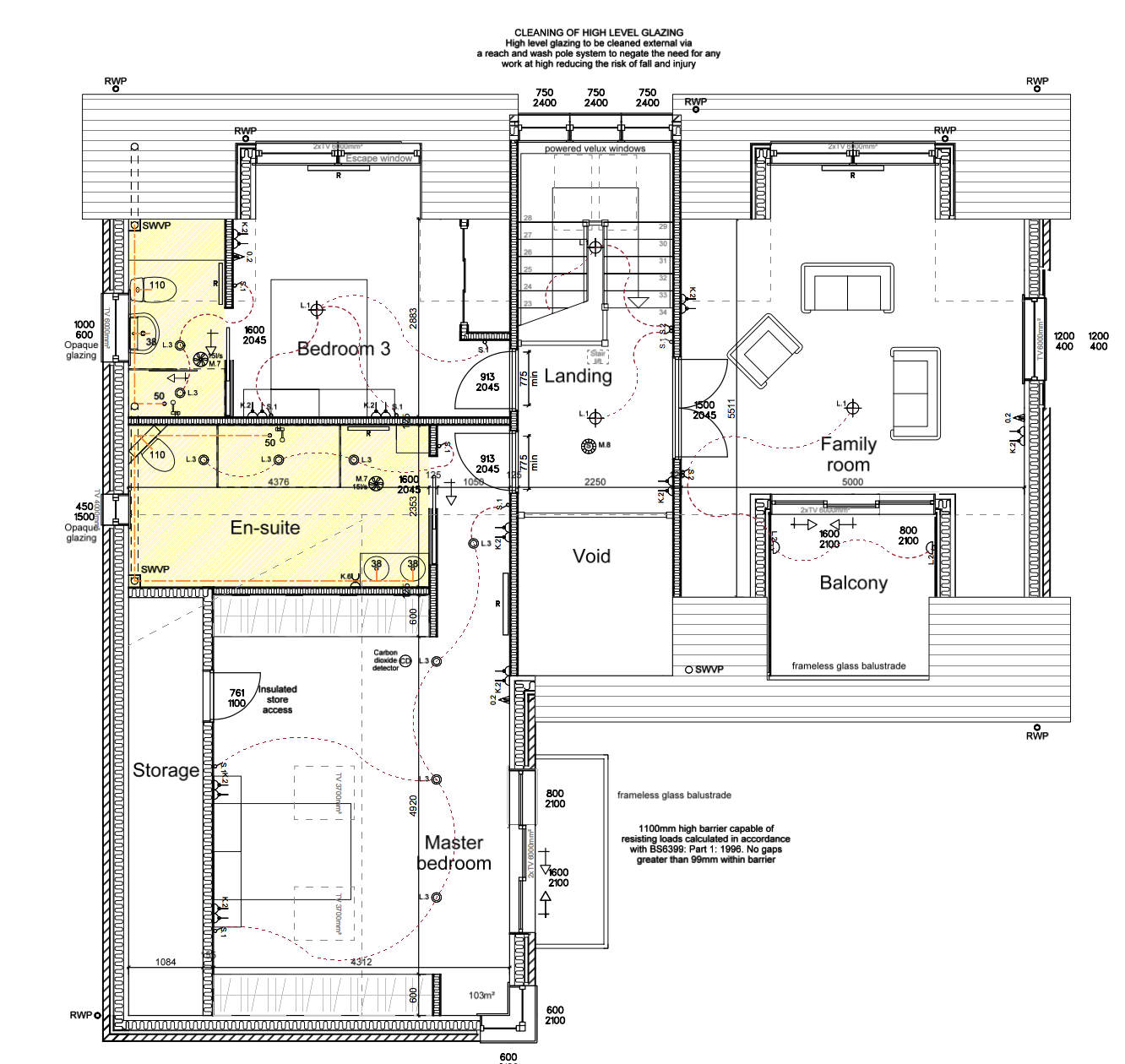

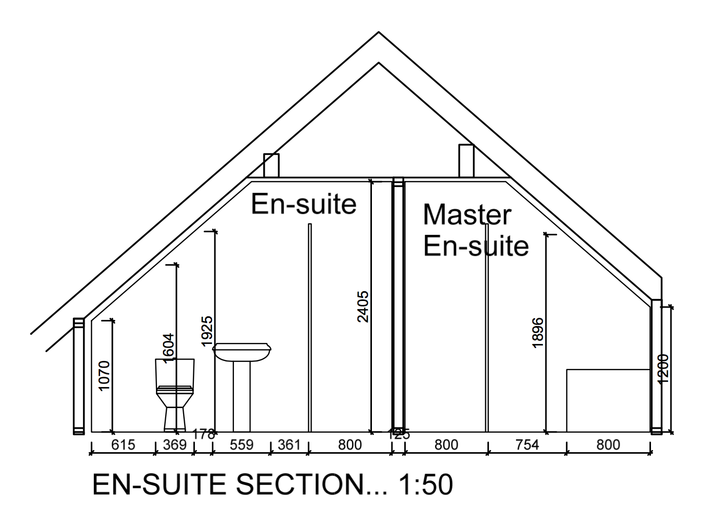

A perfect example of that was highlighted when we identified a couple of very basic flaws with the approved plans, yet the design agency did not notice those until they had been pointed out to them. I'm sure many here will spot the issues:

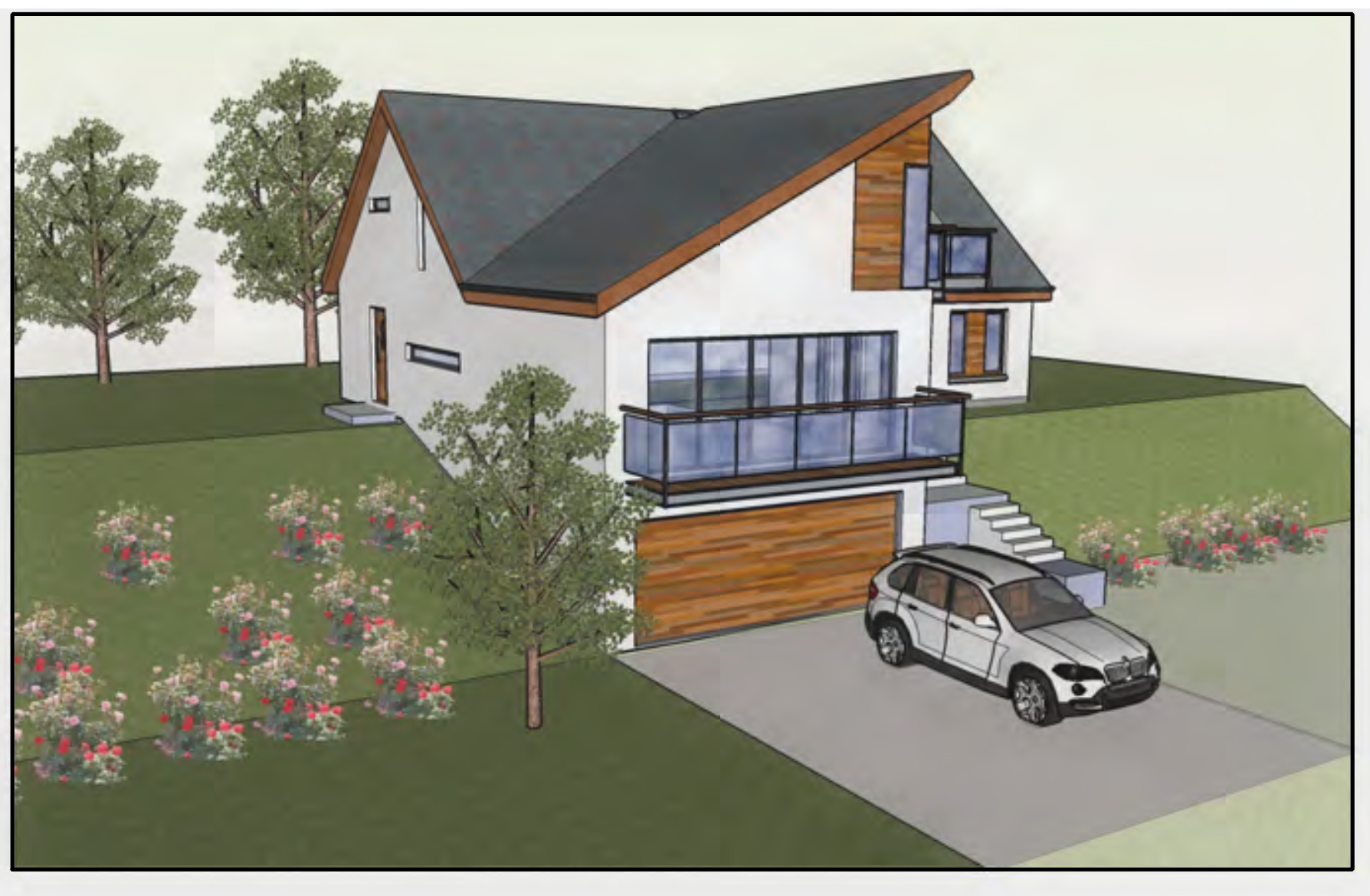

It was my own inquisitiveness that meant I spotted the  issue before we got to timber kit design stage. Other than the initial marketing images, we did not have a 3D model of the house, and with two roofs resulting in a fairly complicated join in our master en-suite, I wanted to visualise how that room would work so started creating my own 3D model. You can see that roof join in this picture:
I had drawings with room sizes, but wanted room heights, so I asked for section views and eventually got the below.
58daf33aca2e6_Screenshot2017-03-2900_34_09.thumb.png.84a809d3117763f94a21eeda76e04d5b.png
However, even at this point, the design agency did not seem to comprehend that there was an issue with the two en-suites on that floor. One of them only had 1.6 meters (around 5 foot 3 inches) headroom in front of the toilet! The agency sent this through with a "as requested" response, not the expected "oh, I see what you mean, that headroom is not enough" comment.
Nor did they notice that the roofline at the rear of the building meant that you could not walk around Bedroom 3 with a double-bed placed as shown on the plan!
We did make some changes in an attempt to mitigate the issues - we increased the roof ridge heights and widened the dormers to allow people to walk around the bed, but it was hard going. We were effectively driving any improvements, and the design agency were acting as computer operators. When asking their opinion or making a suggestion the response was typically "what do you think?"

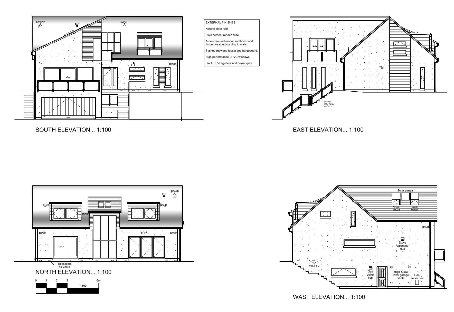

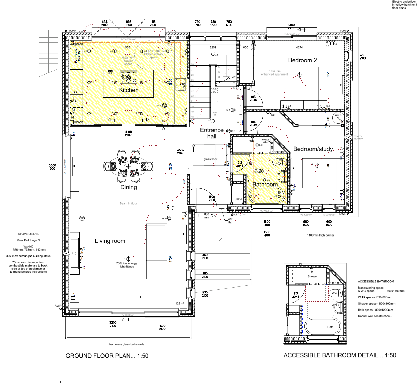

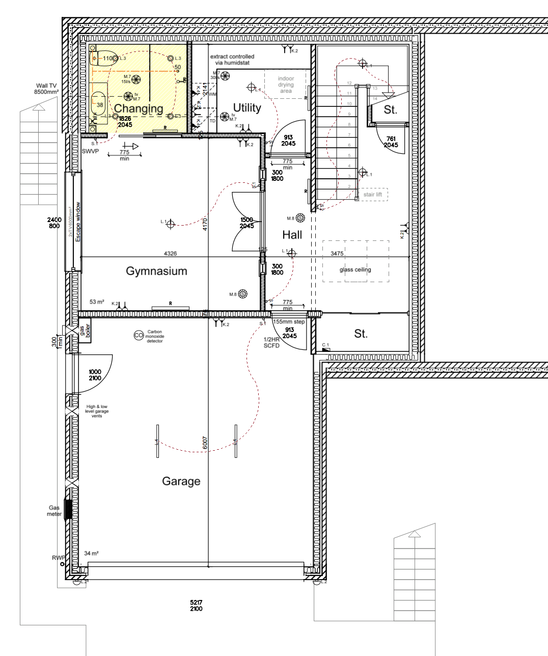

There were some changes we made that we were happy with - I've always liked a double height entrance space, so we removed the vestibule and added a void above the front door, we removed the back door from the kitchen in exchange for more sliding doors (although for some reason they were shown as bi-fold), and also made some other tweaks. This was the final set of designs we got from the design agency, in April 2016.
