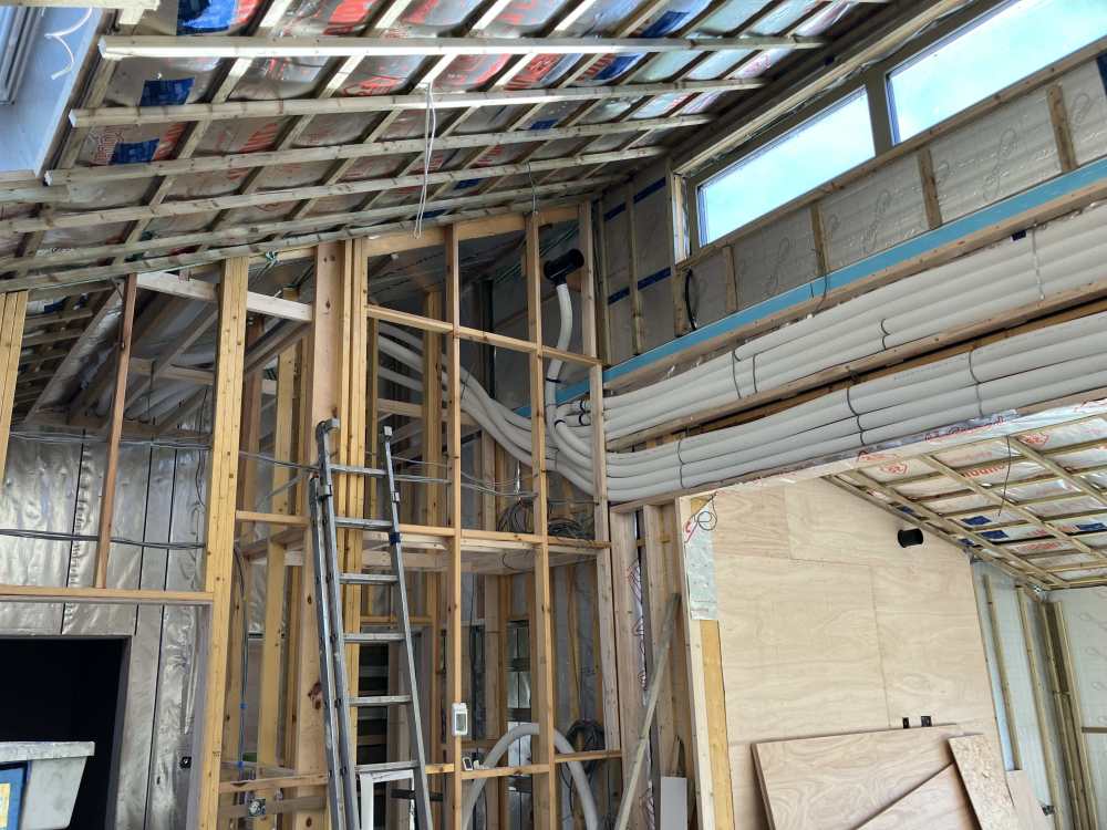

Ventilation ducting and caprentry

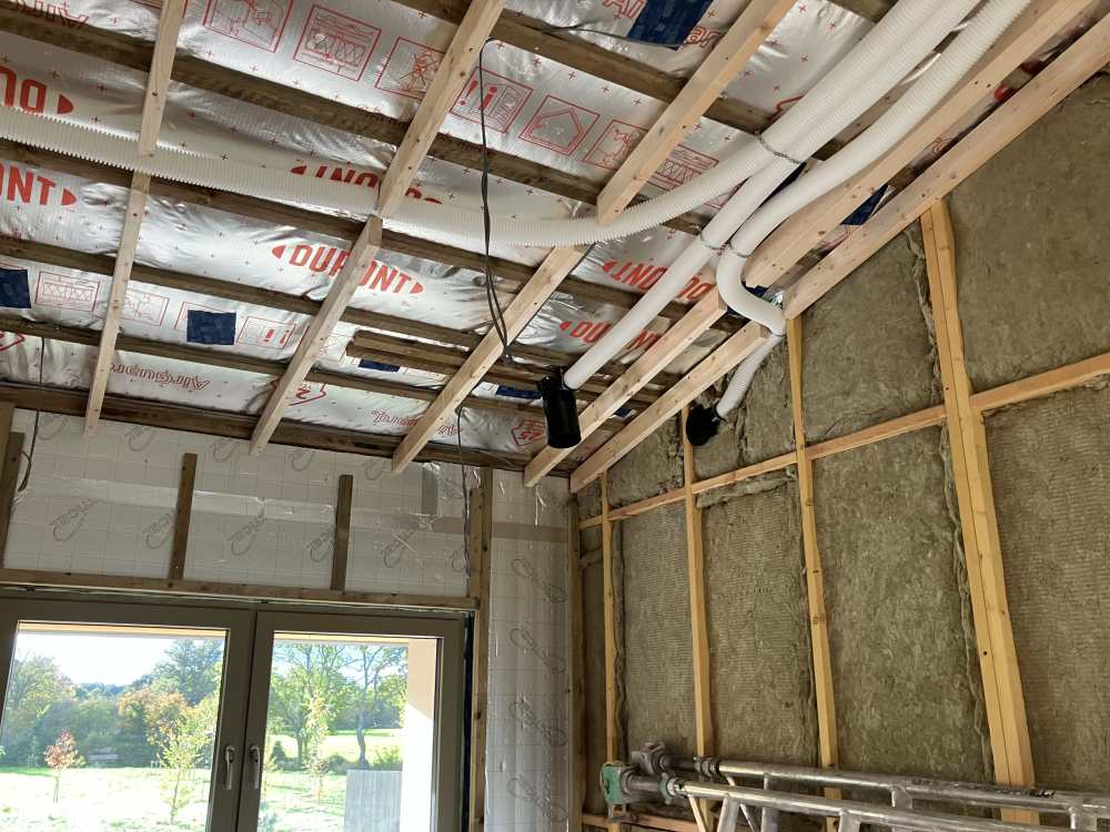

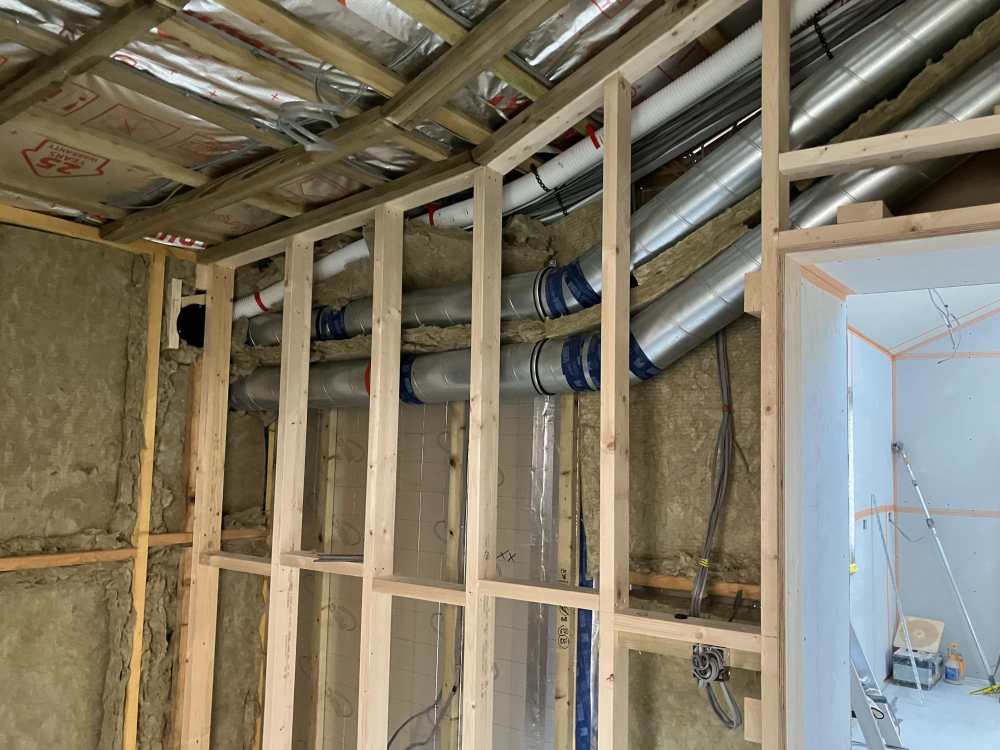

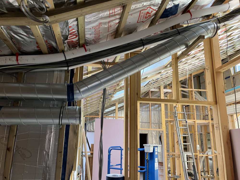

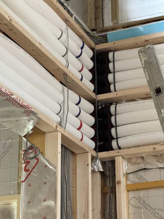

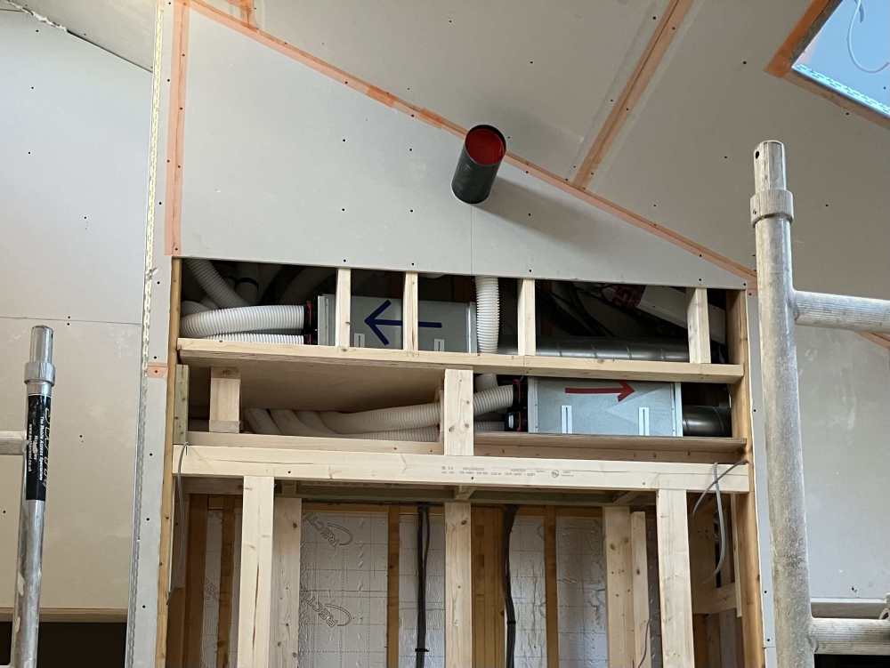

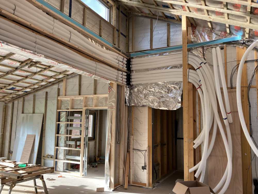

I had some wild idea that Mrs P. and I might fit the MVHR ducting but the least said about that the better.  Fortunately, as noted in the previous blog, our chippies Chris and Alan stepped in to run the ducts very neatly to all the rooms.
Even though it’s a new build we’ve found it tricky to work out how to run the 14 semi-rigid 75mm ventilation ducts from the MVHR to all the rooms whilst avoiding obvious ‘boxing in’ sections around and across rooms, which would have detracted from our desired clean lines.  Partly that’s because it’s single storey and most of the ceilings are vaulted right up to the insulated roof.  If we did another build (Mrs P: “We’re not!”), I’d definitely look to use those open web joists to good effect for ducting.
But in the event it’s been left to Chris and Alan to ‘magic away’ all the ducting behind invisible false walls, whilst impacting the overall room sizes as little as possible.  And a splendid job they have made of it.

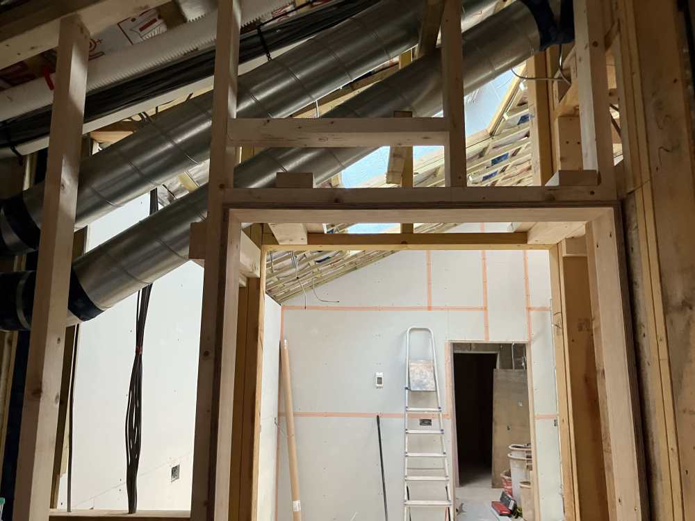

The ducting plan requires seven supply and seven extract ducts attached radially to two 8-port manifolds close to MVHR unit itself.  We chose to site the manifolds 3m away from the MVHR unit in a void above the kitchen alcove which will hold our built-in ovens, connecting the manifolds to the MVHR unit with 160mm rigid steel spiral ducts, which themselves needed to be hidden away behind a false wall in the utility room.

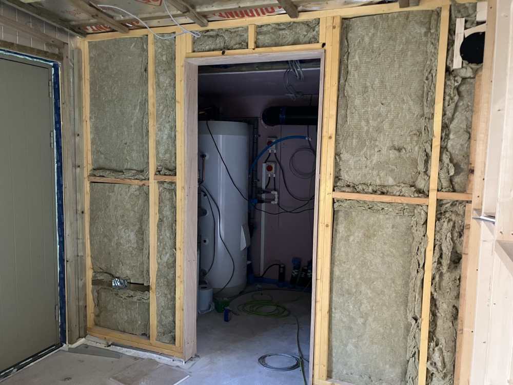

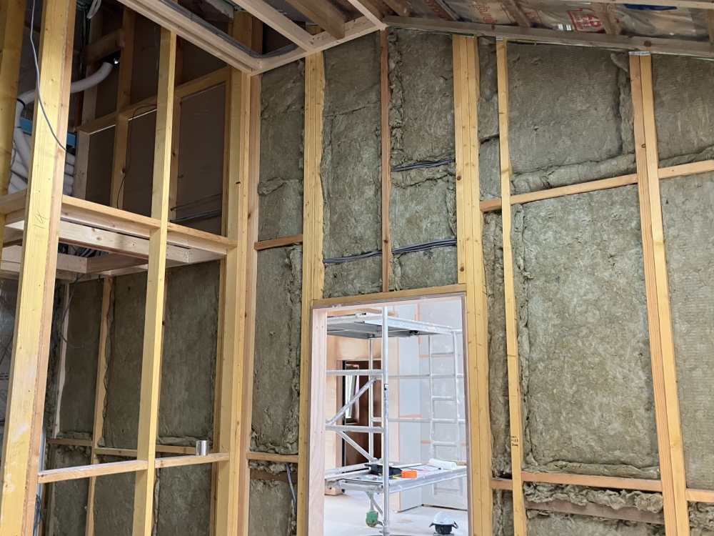

Acoustic insulation
As noted above, Mrs P. is an absolute whizz at fitting this.  I'd like to think that she's enjoyed it but, um, I'm not brave enough to ask.  Anyway, it's going in to every stud wall as soon as there's board on one side to fit it against:

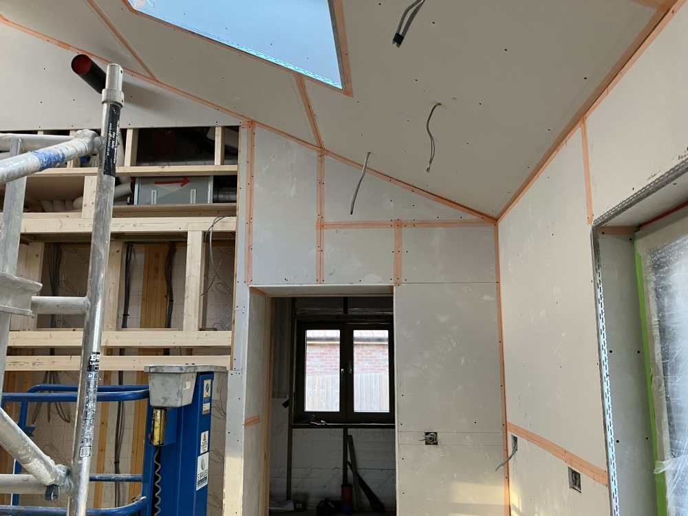

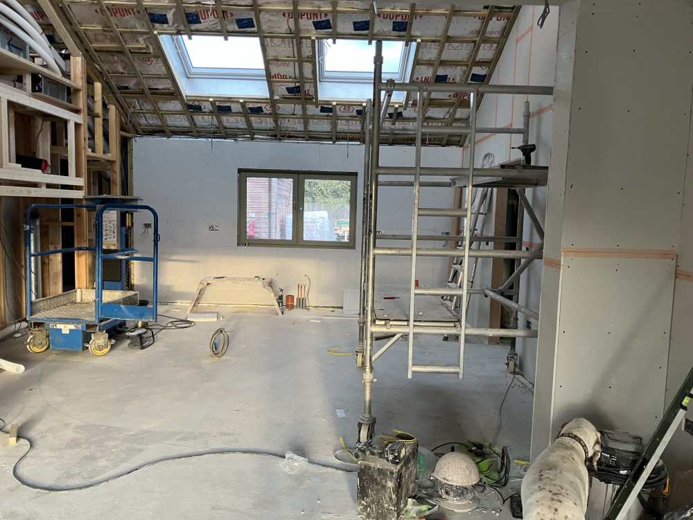

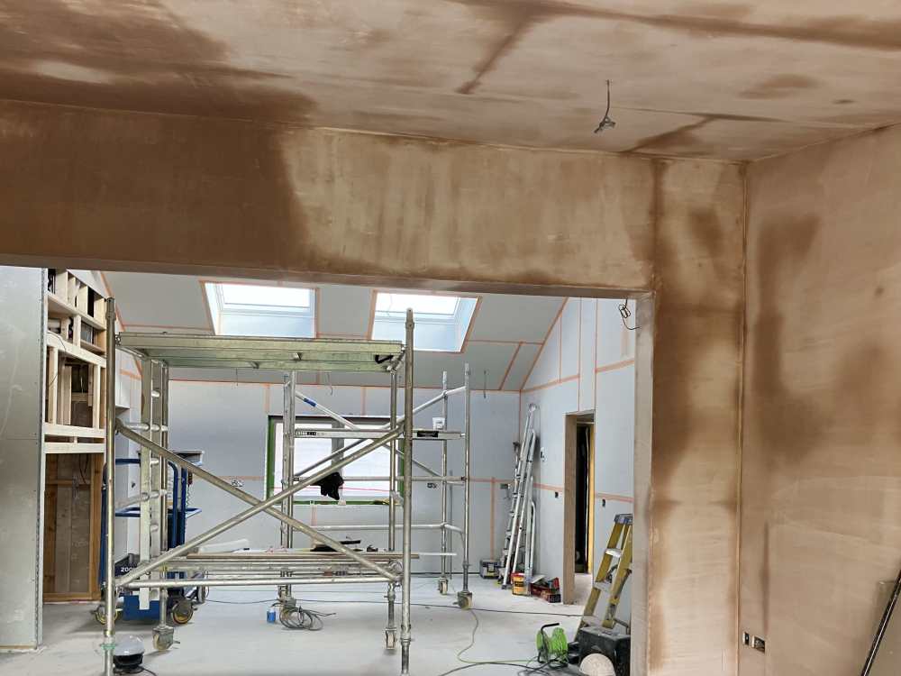

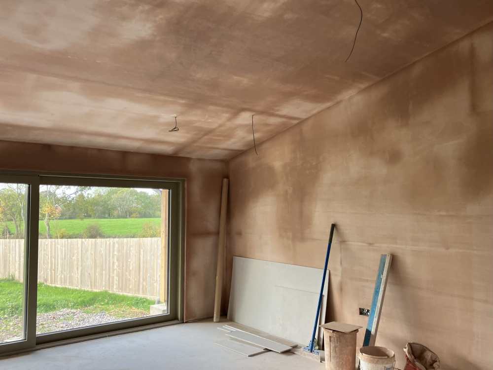

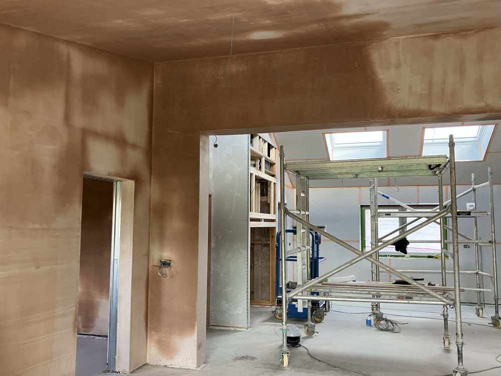

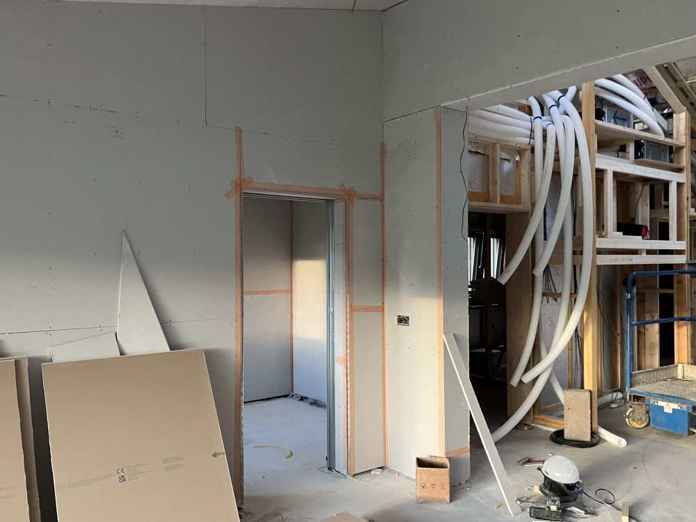

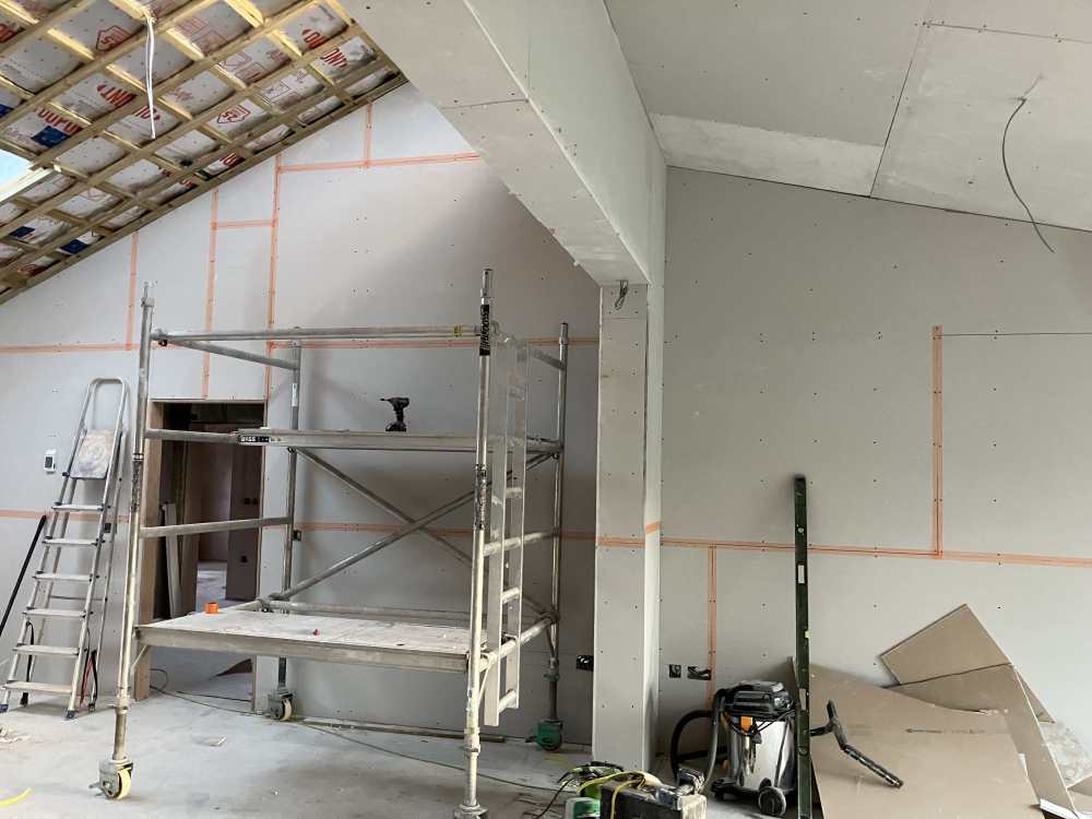

Boarding-out and plastering
The main thrust over the two weeks has been the room by room boarding-out and plaster skimming.  12.5mm board to the walls, and 37.5mm insulated plasterboard to the ceilings.
The plastering team - Dan, Sam and Brandon - have been great.  Particularly pleasing is that they are alert to problems and think about the finished product, raising any questions or concerns so that they can be resolved rather than simply plastering over them, so to speak.  For example, questioning whether a pendant right by a wall rather than centrally in the room was what we wanted (it wasn’t, the cable had been dropped in the wrong place).
We are now about 2/3rds of the way through the plastering and it's making an amazing transformation - turning a house frame into something that begins to feel like a home.

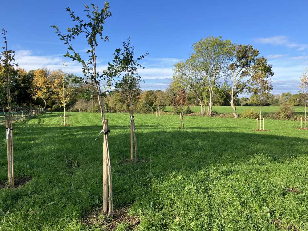

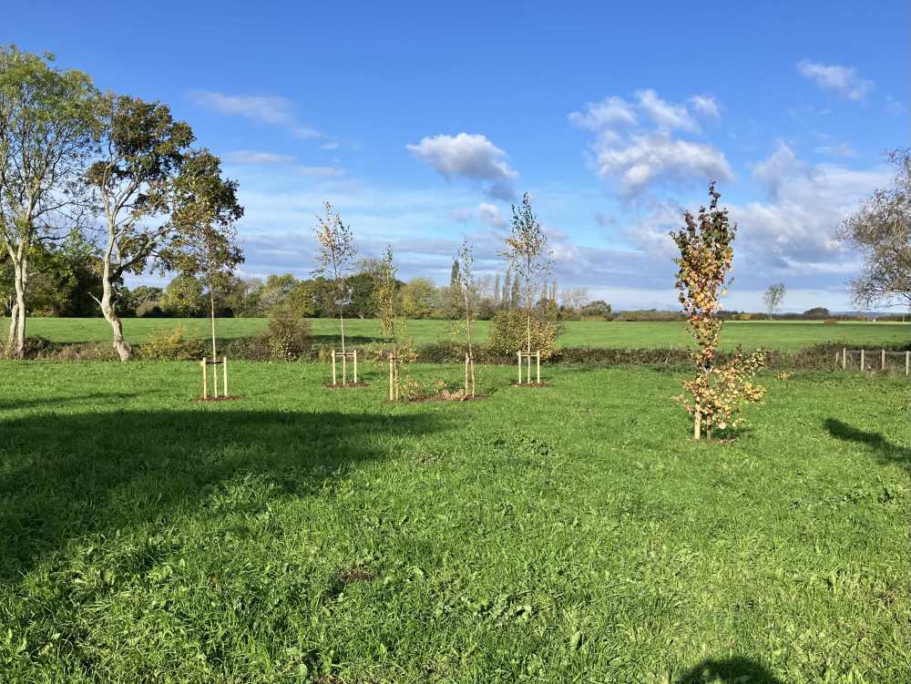

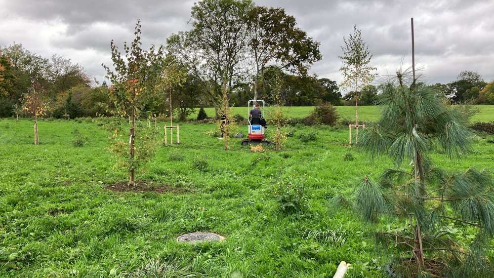

Tree-planting
Remember all those trees delivered in the last blog?  Well Mrs P. got them all planted with the help of our landscape man Ashley, and they are really looking great.

-rick-
Posted
Excellent progress as usual. Hope you mend quickly!
You don't really show it (maybe the start) or mention it but I presume those external MHVR ducts were heavily and carefully insulated before being boxed in?
Benpointer
Posted
Good point Rick.  The steel ducts are actually on the 'warm' side so don't need insulating (though we have popped some acoustic insulation offcuts around them just because we have them.
The 'cold' side ducts are Zehnder ComfoPipe 160mm pre-insulated ducts as shown here:
-rick-
Posted
Ah sorry, and now I look I see you did in fact mention them!
