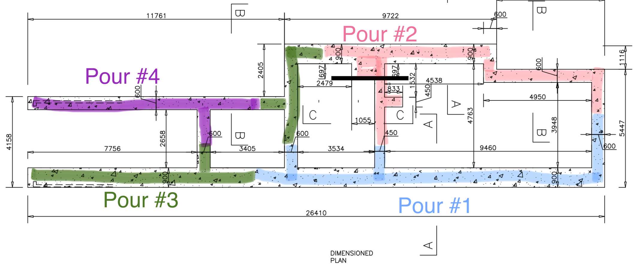

We start the week with the latest quandary: how to show the warranty surveyor enough trenches so he can confirm he’s seen 50% of them.  He saw some last week and if we dug the rest of them then that would add up to enough.   However, if we did that we’d have a massive issue with spoil and we would not get the concrete lorry on to pour, so it would be barrows.   Apparently pumping is an option, but we’d need to close the road which is a lot of cost and a great deal of time wasted.
So, my Monday morning starts with red eyes from pointless endless ‘loop’ worrying instead of sleep, and the morning on site starts with a replan.  The only way to do it appears to be to dig about two thirds of what remains, piling the spoil on the already done foundations, then let the surveyor see the newly dug trenches, then fill that and then next day (yes, this plan extends everything by at least a day) we pull the rest and pour on the final day.   This involves lots of wasted time shunting piles of soil around - we can’t have a grab lorry on the road due to low wires, but we can have one on site once we’ve filled the trenches and they are thus stable.  All the grab lorries are reserved for Kev the Dig’s last day.

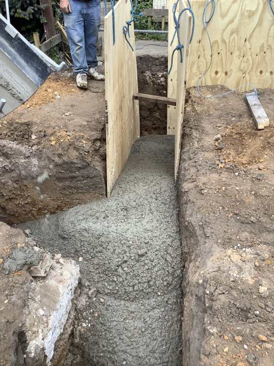

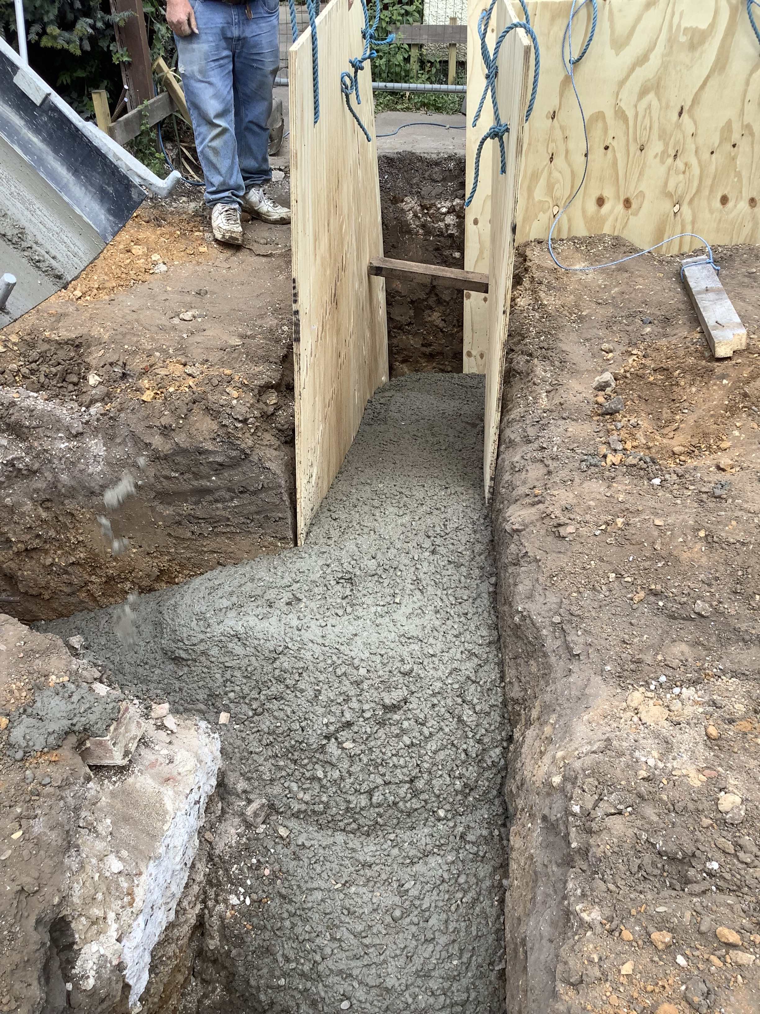

The surveyor arrived on time, and was happy and relaxed.  Stayed a good few minutes this time (we were his only call that day as it was supposed to be a first day back and in the office day), talked through what we were doing.  In response to the shuttering we left in he commented “oh that’s ok”.  All that angst.  Sigh.
He appeared happy with all that he could see, noted that I was talking to the warranty provider peeps, so him being happy is the main thing.  So we got on with pour #3 and removing the shuttering.  The forces involved in pulling out a piece of 4’ by 8’ ply, even when less than half of it is in the concrete, is staggering.  Kev used his digger to pull them out by the rope loops we had attached, but even then it was a struggle and only achieved by wiggling his bucket.

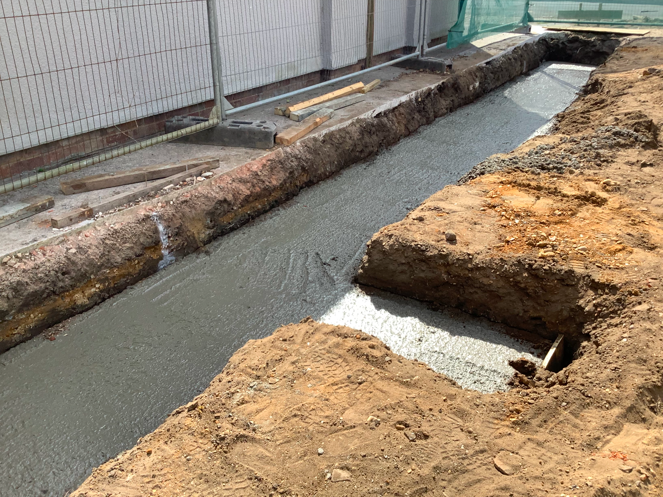

Next day, we dug out the rest of the foundations, dumping the soil on the previous day’s pour and then lunchtime we poured #4.  Bit of a moment when the digger severed the temporary site water pipe that some idiot had dug in and forgotten.  Fortunately when I did that I had used the stopcock at the water meter so I knew it worked and the flow was quickly stemmed.  Interestingly, after all my panicking this was the first instance where Steve and Kev showed significant concern and were moved to move rapidly.   I guess water mixing with sand makes good castles but poor trenches.  I simply don’t know enough to panic about the right things.

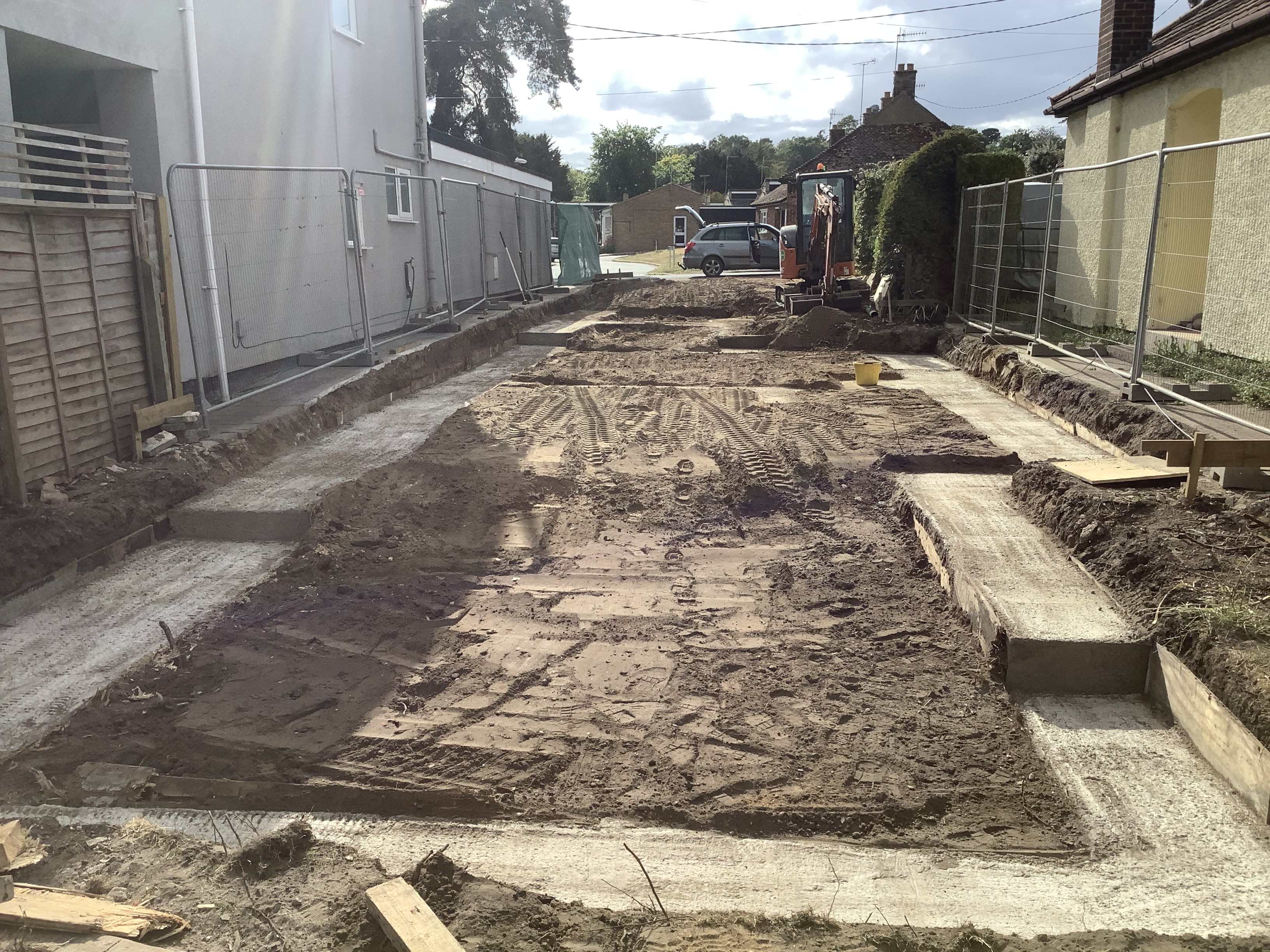

That overcome the rest of the day went to plan, so we finished the foundations.  Four tranches of trenches.  Finally, a full set.
Thursday was spent moving spoil to the front of site for 5 loads of a 16 ton grab lorry to be removed, and that still left some.  Including the previous loads well over 100 tons of material gone by grab, all for a little three bed detached on a diddy site.  Staggering.  Next week we will hopefully get the invoices and we’ll find out if day rate did save us money.  Fingers crossed.
