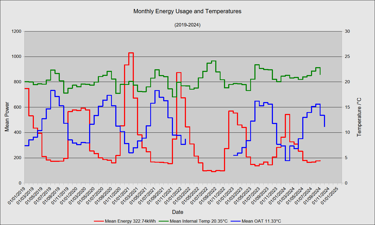

This first one is a time series since the beginning of 2019.  There is a little break in the outside air temperature readings (was using a DHT22 and it probably got wet in a storm).  There are times when I get seemingly high readings which are caused by the sensor being hit by full sunlight, but for 22 out of 24 hours a day, the readings are good, and I can filter out the over temperatures if I need to.  I have a plan to improve this by making a shield, but going for a coffee is more fun than doing 'engineering'.
When we had the energy price shock back in 2022, I added triple glazing to my windows.  This was a cheap option (about £120) and after the first winter I noticed that I did not have to turn my storage heaters on until the mean outside air temperature went below 9°C for a few days.  This was a degree lower than before.  I also noticed a drastic reduction in sound transmission from outside.  There is an energy reduction that is quite clear on the charts, even though there is missing temperature data, though luckily during the summer.

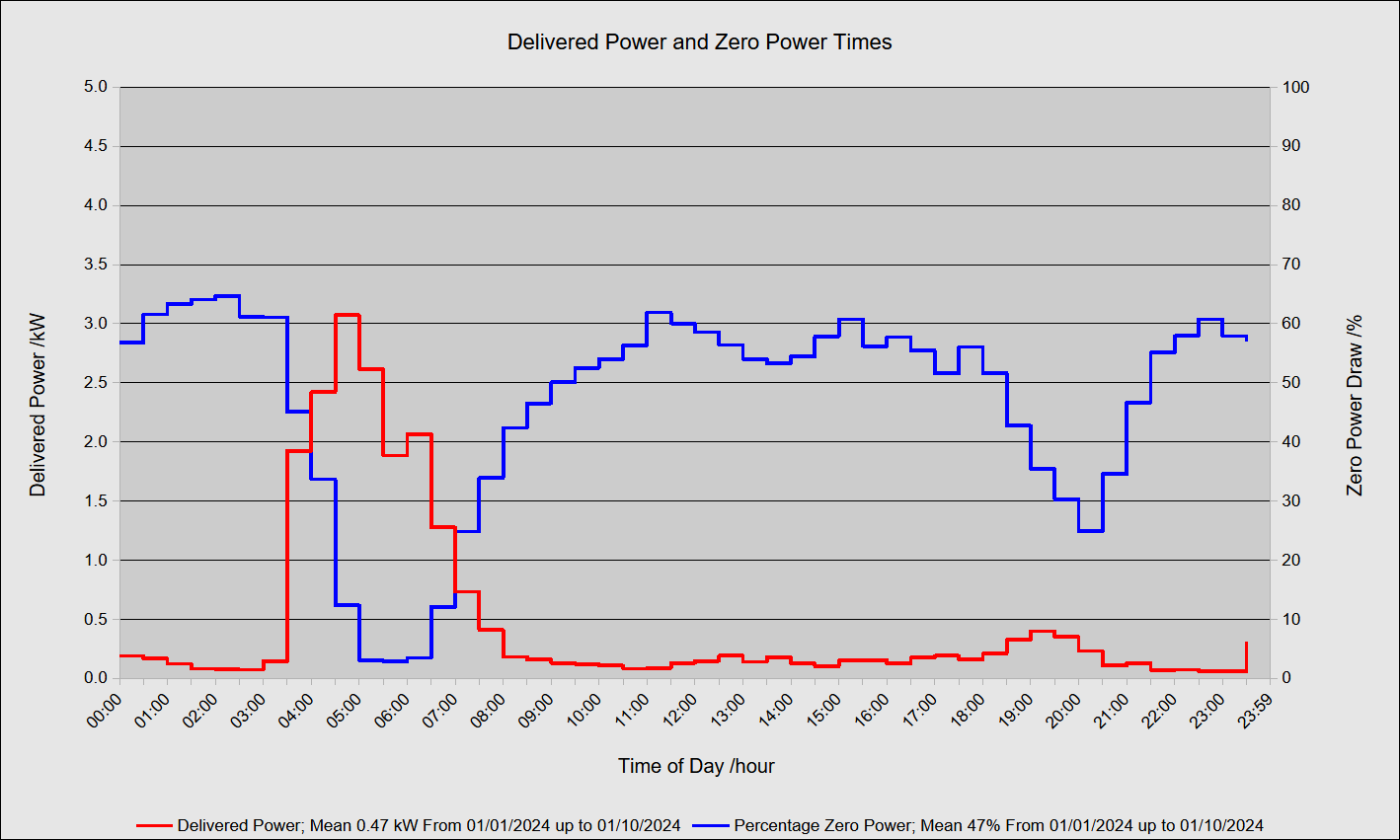

This second chart shows the mean power by time of use and the percentage of time that the house draws no energy from the grid.
