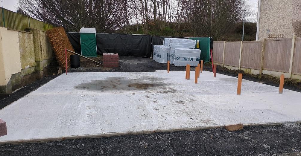

Concrete was poured via a pump on Monday. Finally have a Concrete sub foundation!

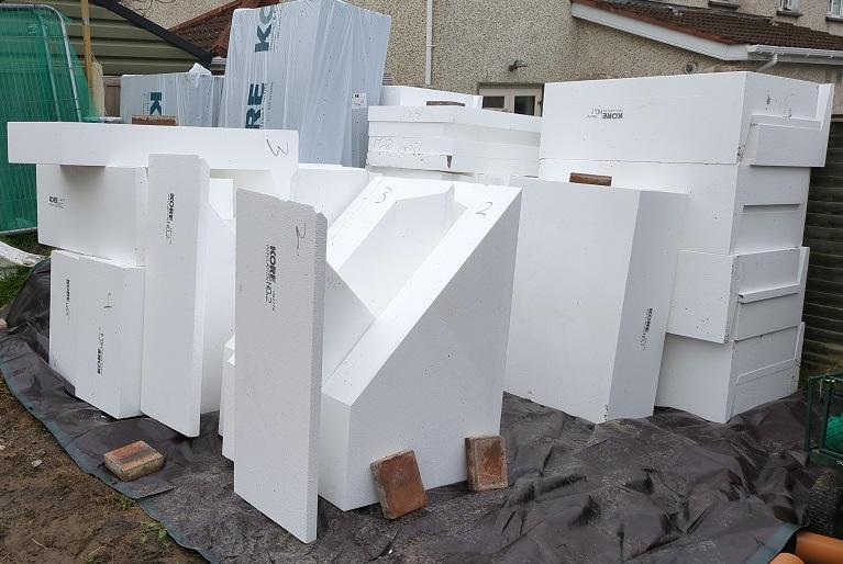

Took delivery of the Kore insulation for the actual foundation. Lots of angles sheets, L shape and other ones. I've 88 silver EPS boards too in packs of 8. They needed 2 men to move, the others could be handled one by one. The delivery driver helped offload as getting a forklift and driver for 4 Pallets (@150kg each) was going to be expensive and on too much short notice to arrange insurance for me to drive one. Plus I don't know how!! We got it all offloaded in about 30 minutes by hand and then another 45 to shift it to the back of the site.
There seems to be a dip where water is collecting in the middle there and some rebar patterns are showing up in one corner, will discuss with groundsworks lead next week.
Next is to find a blocklayer to place two courses of blocks on their side around the perimeter to hold in the Kore and lay the DPM/Radon barrier on. Stops the Kore moving around. That's the holdup as brick layers are flat out over here currently. I put a call into a 2nd who said 7-10 days give him a shout. Plan is for Timber Frame to go up in early March.

Why can’t you fit the kore in place , shuffle it until you are happy then fix 4x2 strip at corners screwed down to keep it in place.
if the blocks are put in place first you are at the mercy of the bricklayer’s accuracy.
  • Like 2
Link to comment
We'll allow 10mm on each axis for wiggle room. The groundsworker want to tie in the DPM/Radon barrier onto the blocks. Definitely the reverse way I'd like things done but just need to make sure the block work is perfect on the internal measurements. I'll have a chat with them in an hour or so and see what they think...good suggestion though....
Link to comment
"Made Ground" - found out at last minute. Poor down to 2.2 meters. The sub foundation is part of the system to avoid subsidence - using 89 groundscrews!! Now all covered you wouldn't know they were there at all!!
