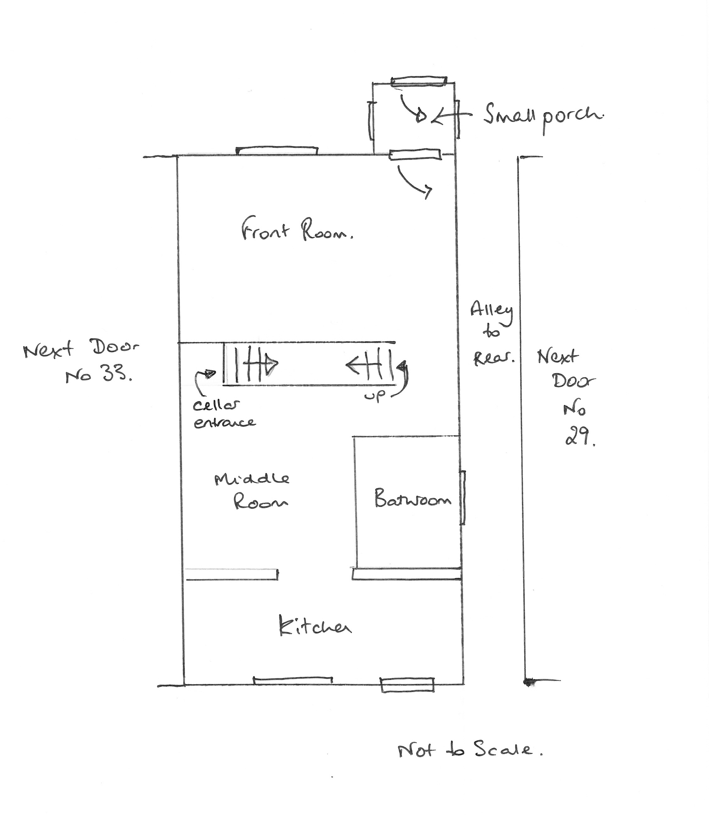

Here is a plan of the ground floor to give an idea of what is where.
