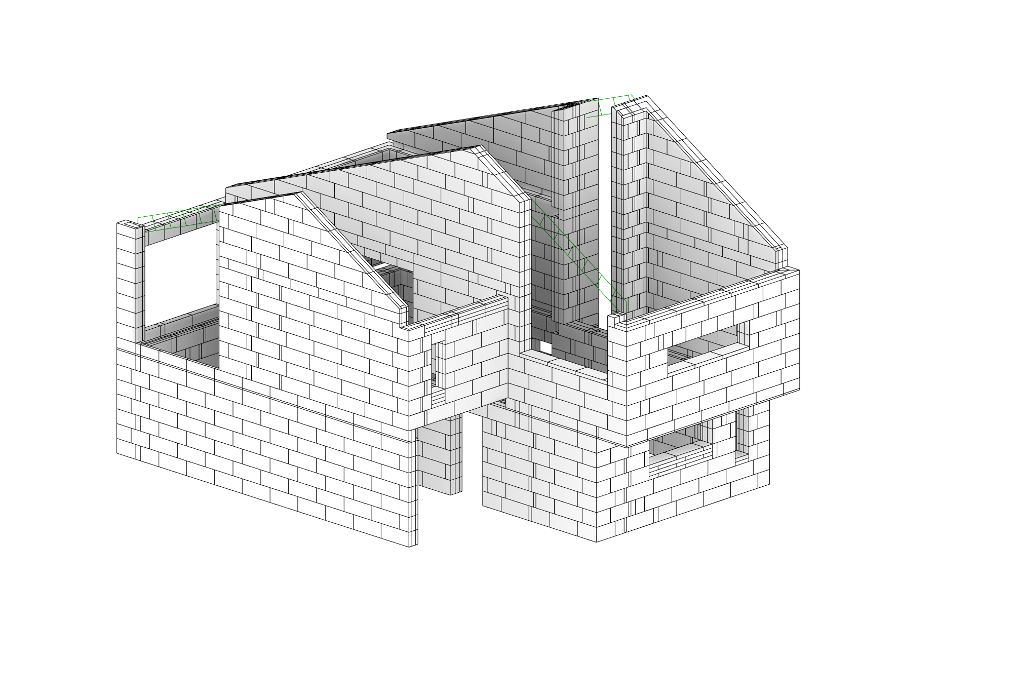

At this point it should have been simple order the MBC kit...enter the build hub. Having done a bit of reading on construction techniques and their problems we decided to take a look at ICF as it was comparable in price with timber frame without some of the long term problems that timber frame can face with external water ingress. More research looking at ICF block led us to JUB who had a “no cut on site solution” which appealed. The block are not flat pack and have substantial webbing which should reduce the risks of bulges and leaks when the concrete is cast. Having selected a brick the next problem was to find a builder. Not as simple as we would have thought as builders who use ICF are would appear in the main to be in exclusive partnership with the a block manufacturer. In the end we went with “Intelligent Building Solution” a firm with considerable ICF experience who are based in Glasgow.
JUB ICF:
The web site literature for JUB sells the blocks as a well established solution. JUB have integrated raft, wall roof and render systems which should minimise compatibility issues.
It was not long into the process before we discovered from sources other than JUB that they had not built any houses in the UK. The bricks are in use in Europe but mainly in off the peg solutions, in the UK it's being marketed as a solution that can build pretty much any house you like within a 75mm of your design. The marketing support for the blocks is best described as tentative, having nothing to base there quotes on. We had expected them to be keen on getting a build under way but getting a competitive price was not straight forward. At £79 per square meter for the 390mm blocks and £58 for the 300mm blocks put it toward the high end for ICF. What I will say in their favour is that the technical support has been excellent. We are now dealing direct with the JUB technical guys in Slovenia and they are being very practical and helpful.
Structural calculations:
One problem you face with the JUB solution is that the block plan can alter the build dimensions, not only by the 75mm figure but also to simplify wall interfaces. The result is that you have a bit of a “chicken and egg” dilemma with what order you get things done in. We opted to get a first pass on the ICF block layout and use this as input to the structural engineers. This has worked out well with only minor rework of the calculations and amendments to block layout.
