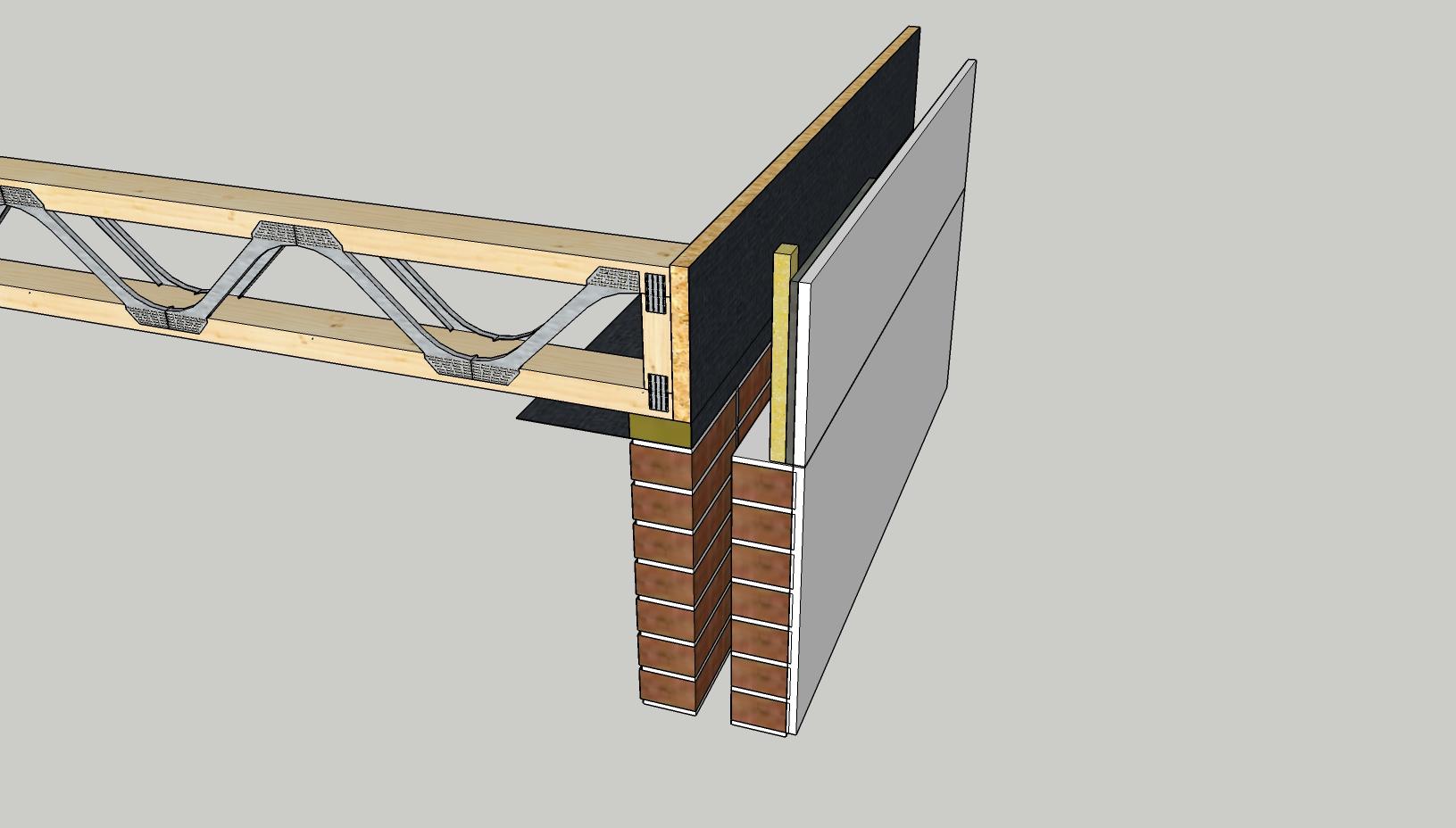

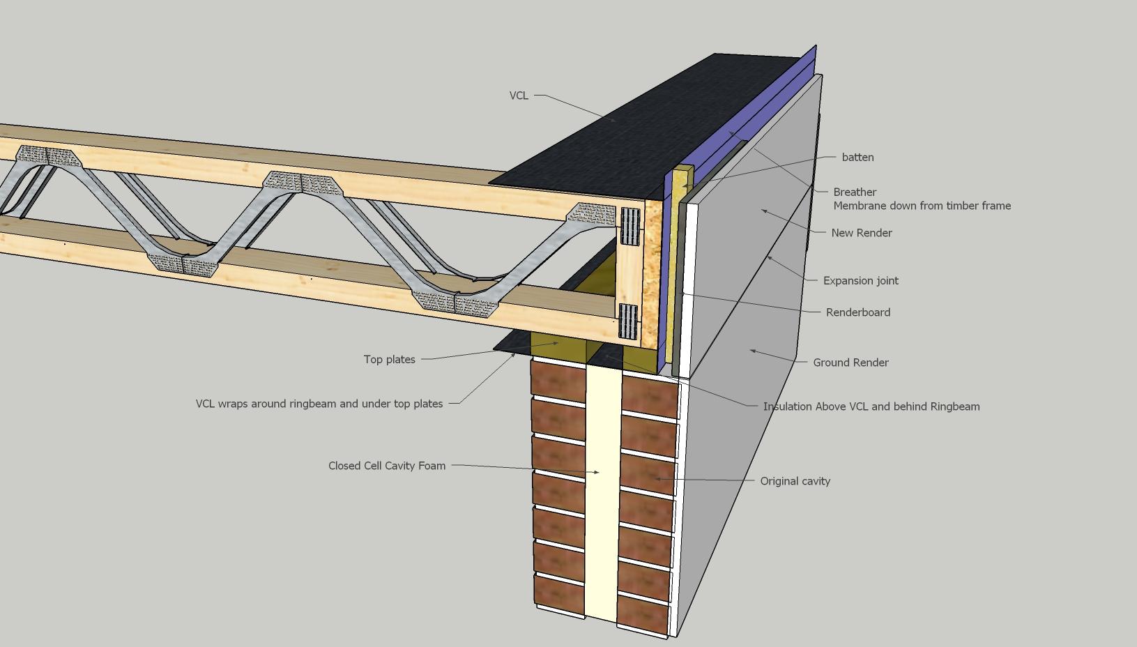

PhilC Posted July 14, 2022 Share Posted July 14, 2022 Couple of diagrams i made to highlight, top with the 'void' lower with what I would like to do. Link to comment Share on other sites More sharing options...

PhilC Posted July 20, 2022 Share Posted July 20, 2022 (edited) Hi JohnMo, Thanks for the response and interest. I am not sure how that applies directly to my query though. I dont want to site the ringbeam on the inner leaf (1st picture i inserted) as it creates a large void over the cavity that has to be spanned somehow to present a flush finish with the ground floor, essentially will need another brick course outer leaf, something i would like to avoid. I would like to span the cavity with the floor joist if possible, then i can present the ring beam closer to the outside wall to batten/renderboard or woodfibre sheath and render. I guess you have no cavity to span with ICF? Edited July 20, 2022 by PhilC Link to comment Share on other sites More sharing options...
