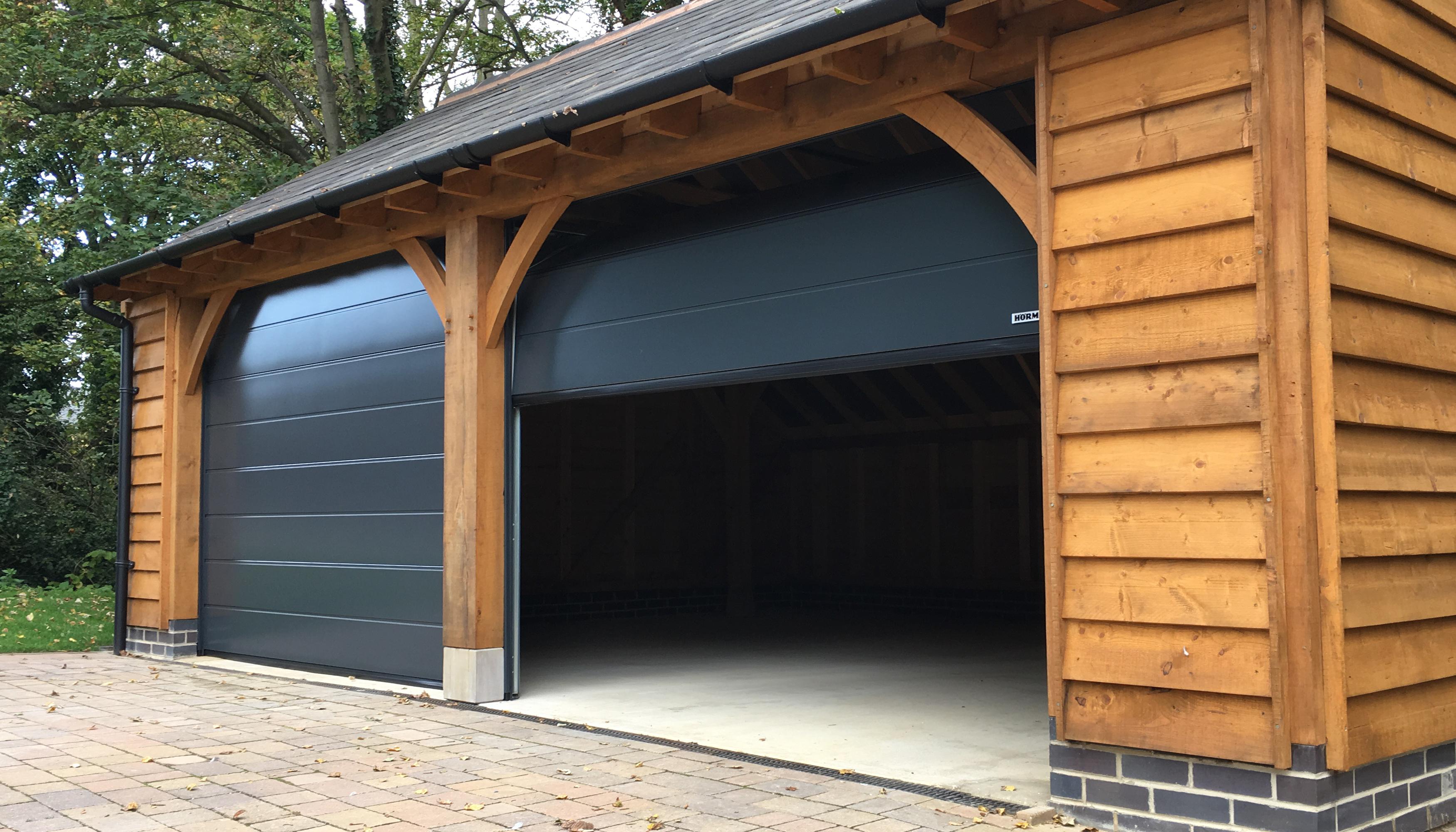

I aspire to something like this for the garage...

Normally, there is a closer board across the cavity and the last set of tiles sits on the edge of the brickwork unless you have an open eaves detail.
Search for Cottage Eaves detail.
