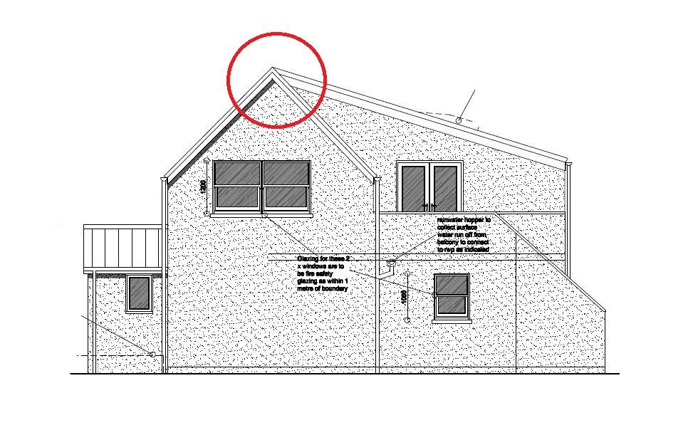

willbish Posted January 3, 2019 Posted January 3, 2019 Do I need a specific ridge tile/slate to suit my needs? Front pitch is 45°, Rear is 16° then transitions to 45° Im thinking a half round would better absorb the transition. I'd like it to be seamless from the front that there is any change in pitch going on at the rear, if that's possible? It will be a 'dry ridge' to allow for ventilation
nod Posted January 3, 2019 Posted January 3, 2019 I used a Marley half round on ours Which accommodated Both pitches that I needed They look identical once they are fitted
