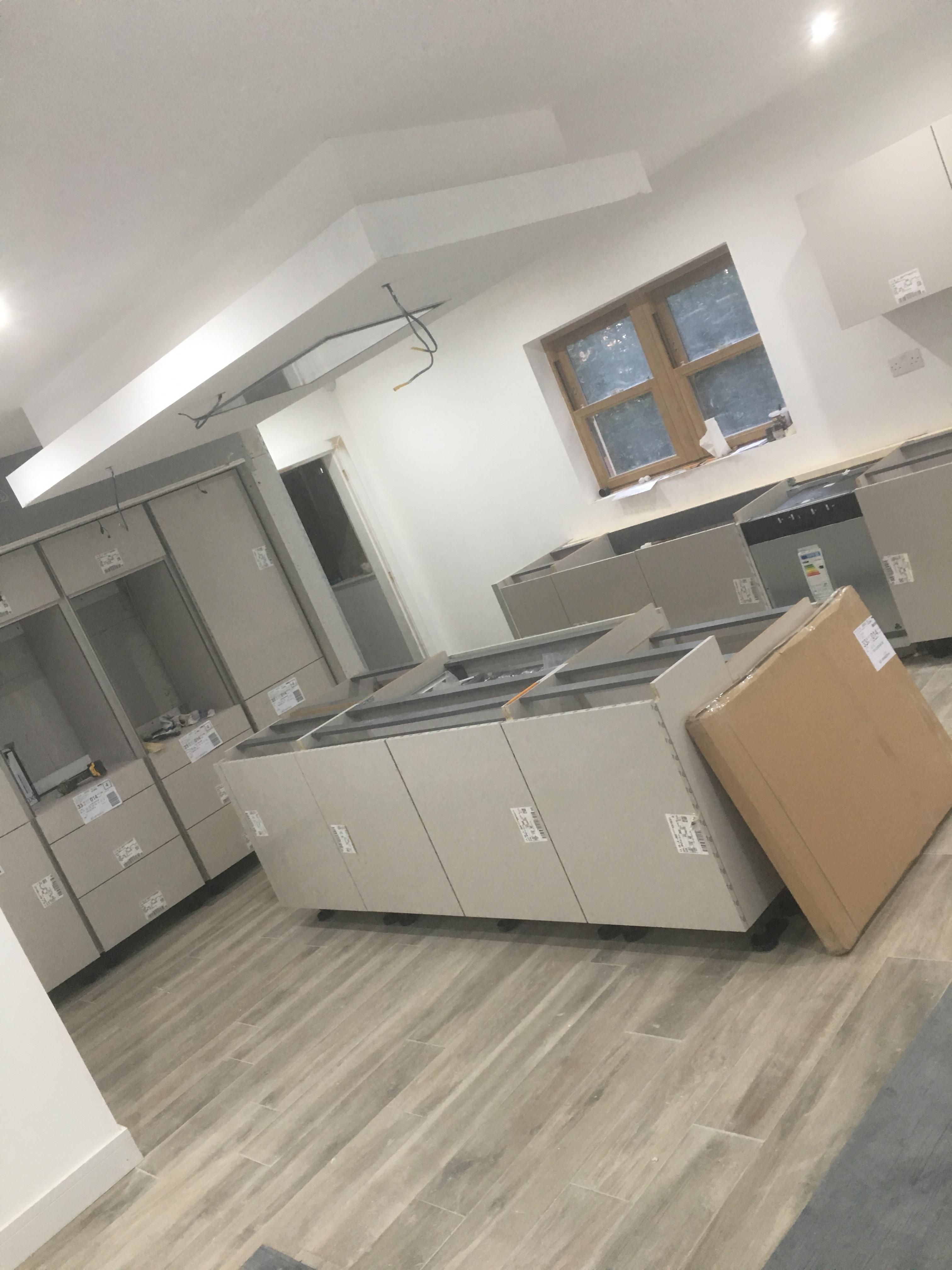

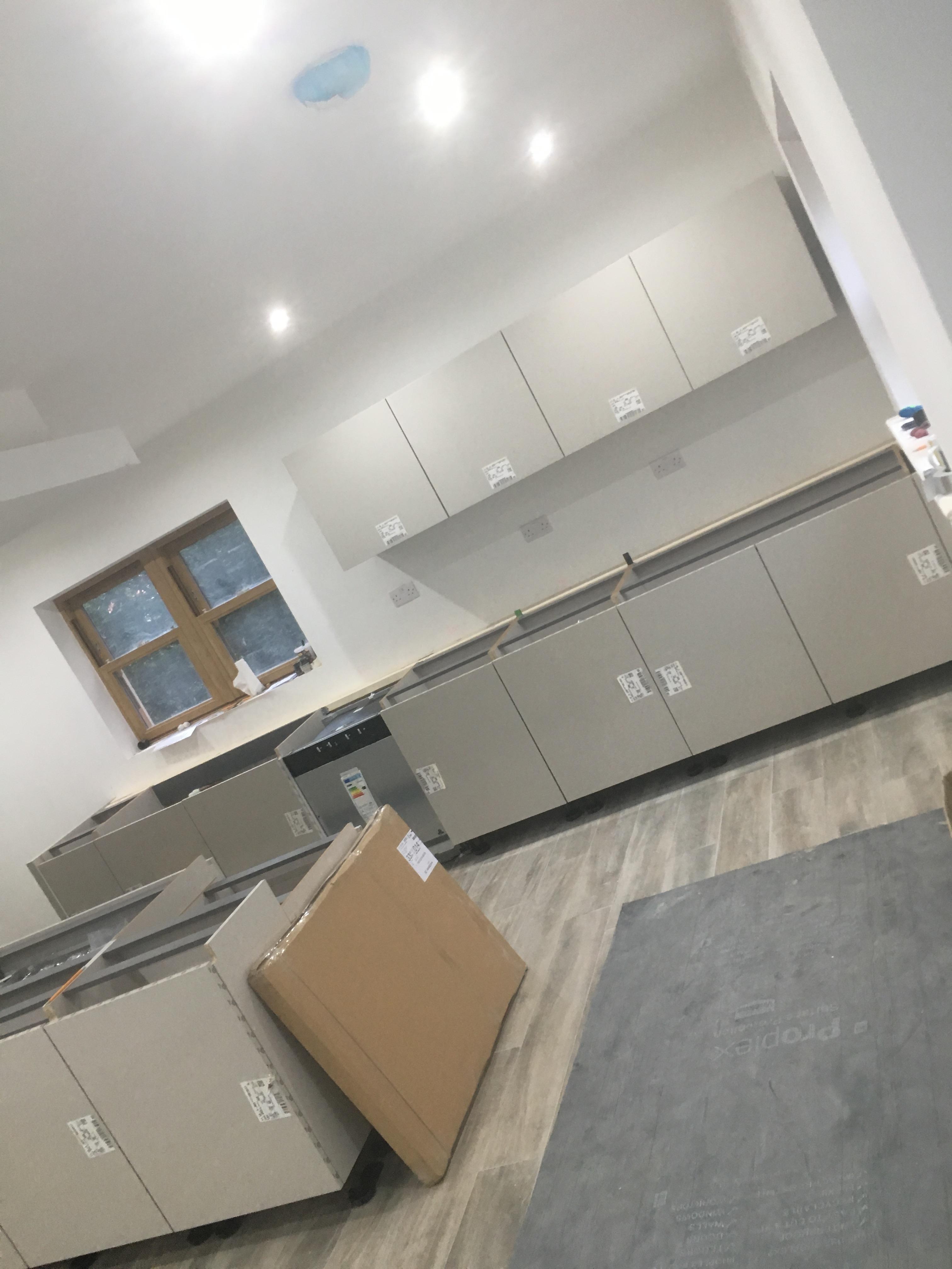

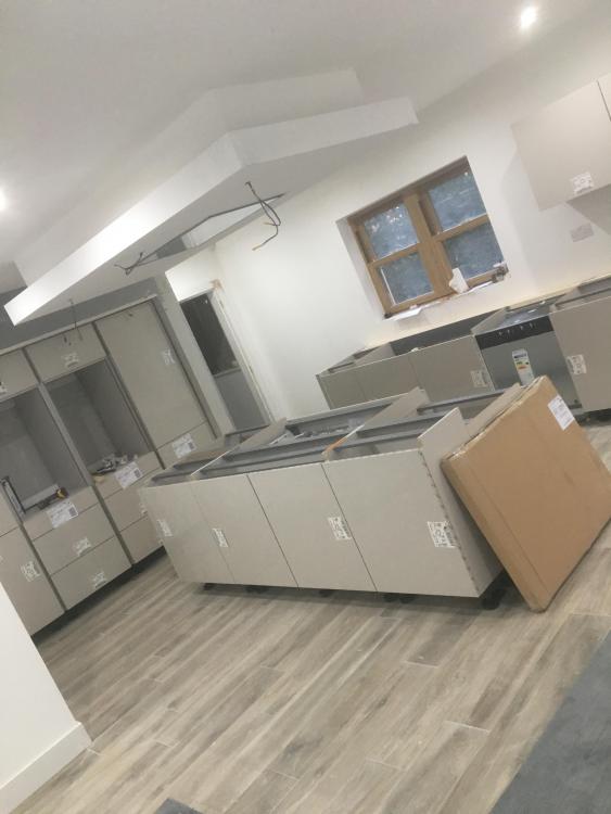

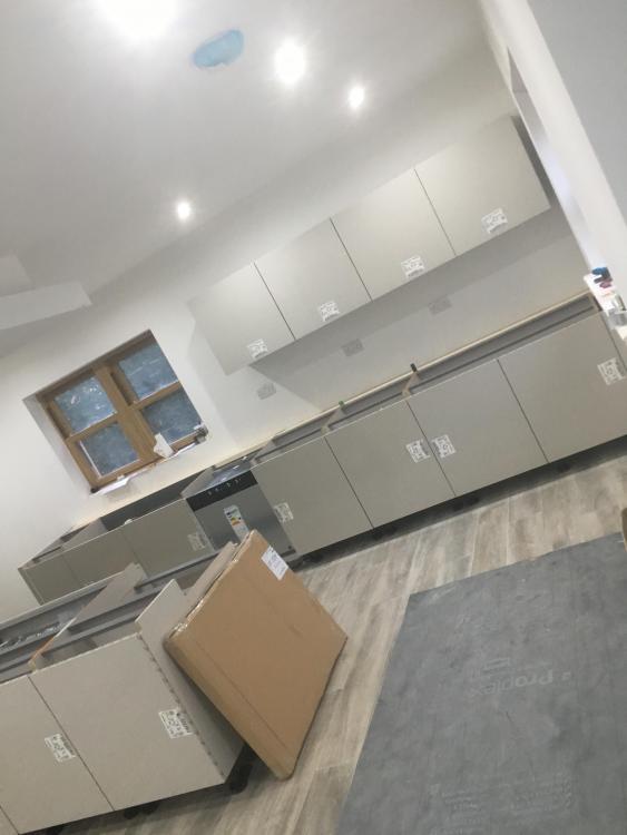

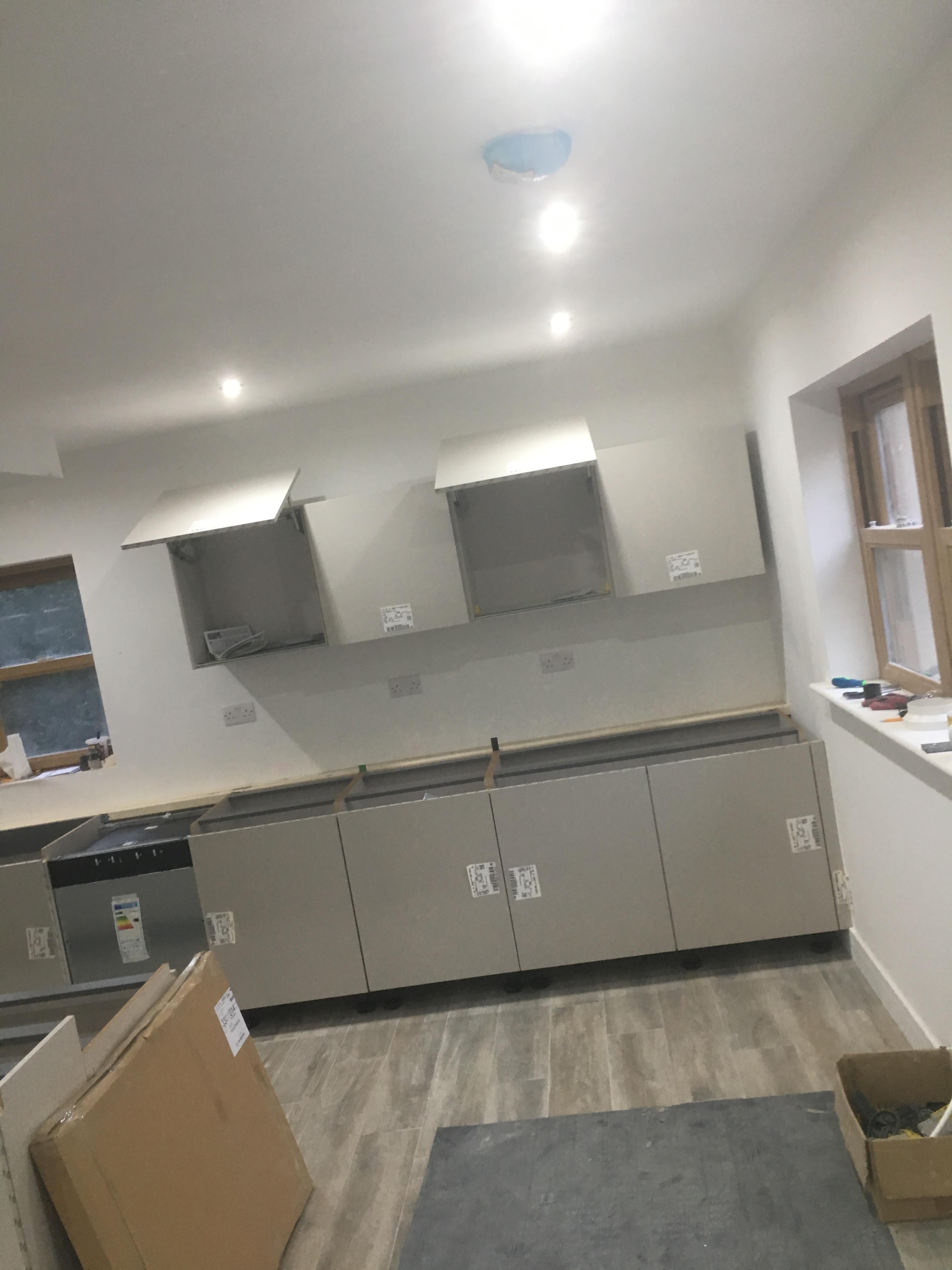

The carcasses are pretty much the same as anywhere else
The doors and hinges are excellent
A lot more work fitting especially  the finger rails
Lets see if they manage to redeem them selfs by shipping the damaged units out quickly
Myself and a friend have two days fitting to get it to the stage we’re we can get the quartz guys in

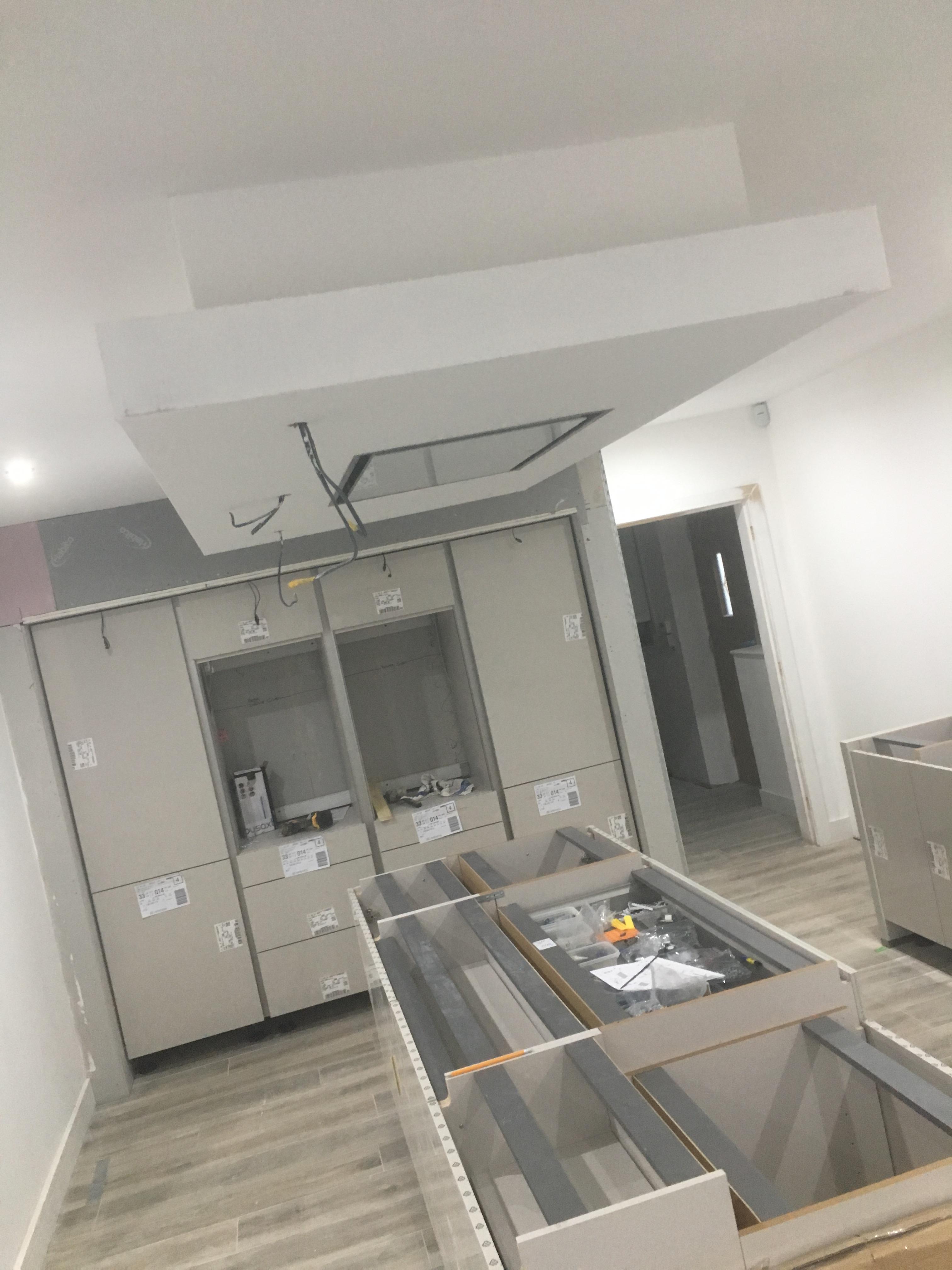

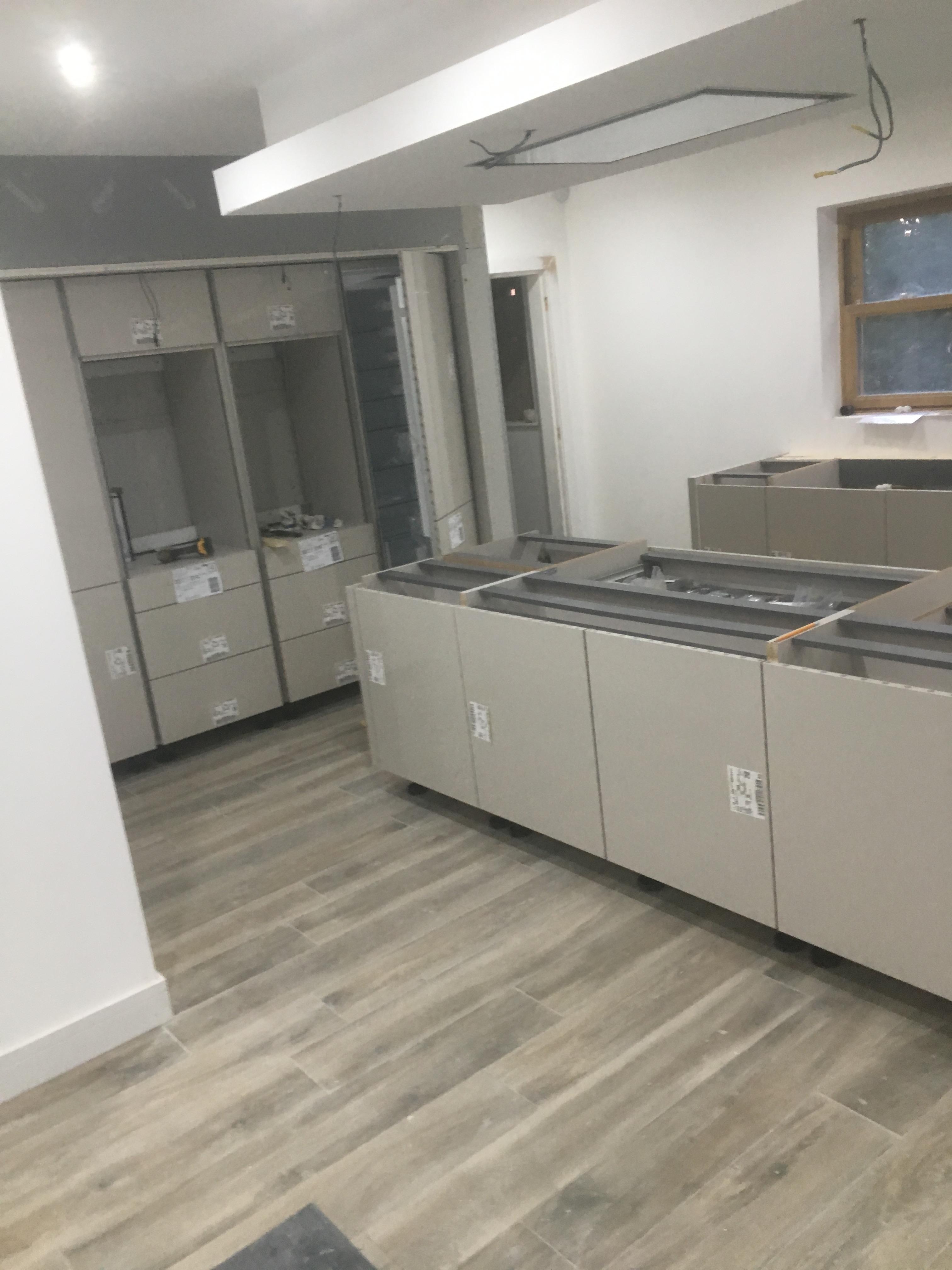

What are you putting in those oven housing? Doesnt the aperture  seem too high for whatever is going in?
Two Neff double ovens
It’s the height that my wife prefers
Shes only 5’6 I’m 6’4 so nothing looks high to me ?
Wow that is high! I’m the same height as your wife but mine start above your 2 lower drawers ?
I can guarantee you thats too high for your wife. Its probably ok for you for the bottom oven but definitely still a tad too high for the top oven.
A Double oven 890mm for a person for 5ft 4in should be no higher than 5ft 6 in to the top of the fascia.
Always consider that the top door dropped down will present a burn risk to the outside of the arm while removing items from a hot oven.
She like what she likes
I’ve built the run of base units out to take a 750 worktop also
