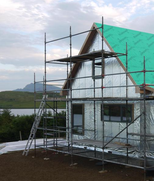

Thedreamer Posted August 15, 2018 Share Posted August 15, 2018 (edited) Seem to be going round in circles here. Spoke to Building Merchant and roofer earlier and they suggest the Klober dry verge uni line S strip, but this seems to be more based for battens rather than in Scotland where slates are nailed directly onto the sarking boards, so I was thinking that there 'Scot strip' would be the better option. http://klober.co.uk/shop/product/uni-line-continuous-dry-verge This is what the end gable currently looks like. Any comments or advice would be appreciated. Edited August 15, 2018 by Thedreamer Link to comment Share on other sites More sharing options...
Jeremy Harris Posted August 15, 2018 Share Posted August 15, 2018 We used the Kytun aluminium dry verge. Should work fine with slates nailed direct to sarking, I think: http://www.kytun.com/c/slate-dry-verge-system/7 Link to comment Share on other sites More sharing options...
Alexphd1 Posted August 15, 2018 Share Posted August 15, 2018 We used the T2 profile in the above link directly on to the sarking. Worked a treat apart from the first slate tier when we kicked them out for the bellcast which was a bit of a bugger . Also ordered direct from kloeber in RAL7016 to match windows and facias. We have used tapco plastic slates. Link to comment Share on other sites More sharing options...
Thedreamer Posted August 15, 2018 Author Share Posted August 15, 2018 Thanks Chaps. I think I might go down this route. https://www.google.com/url?hl=en&q=http://www.kytun.com/p/retro-fit-slate-dry-verge-aluminium-pack-of-4/p-c03&source=gmail&ust=1534434436095000&usg=AFQjCNHgOdaq_41SMhcW_UkcbUhRrz6zuQ With the verge attached to the bargeboard. Link to comment Share on other sites More sharing options...
