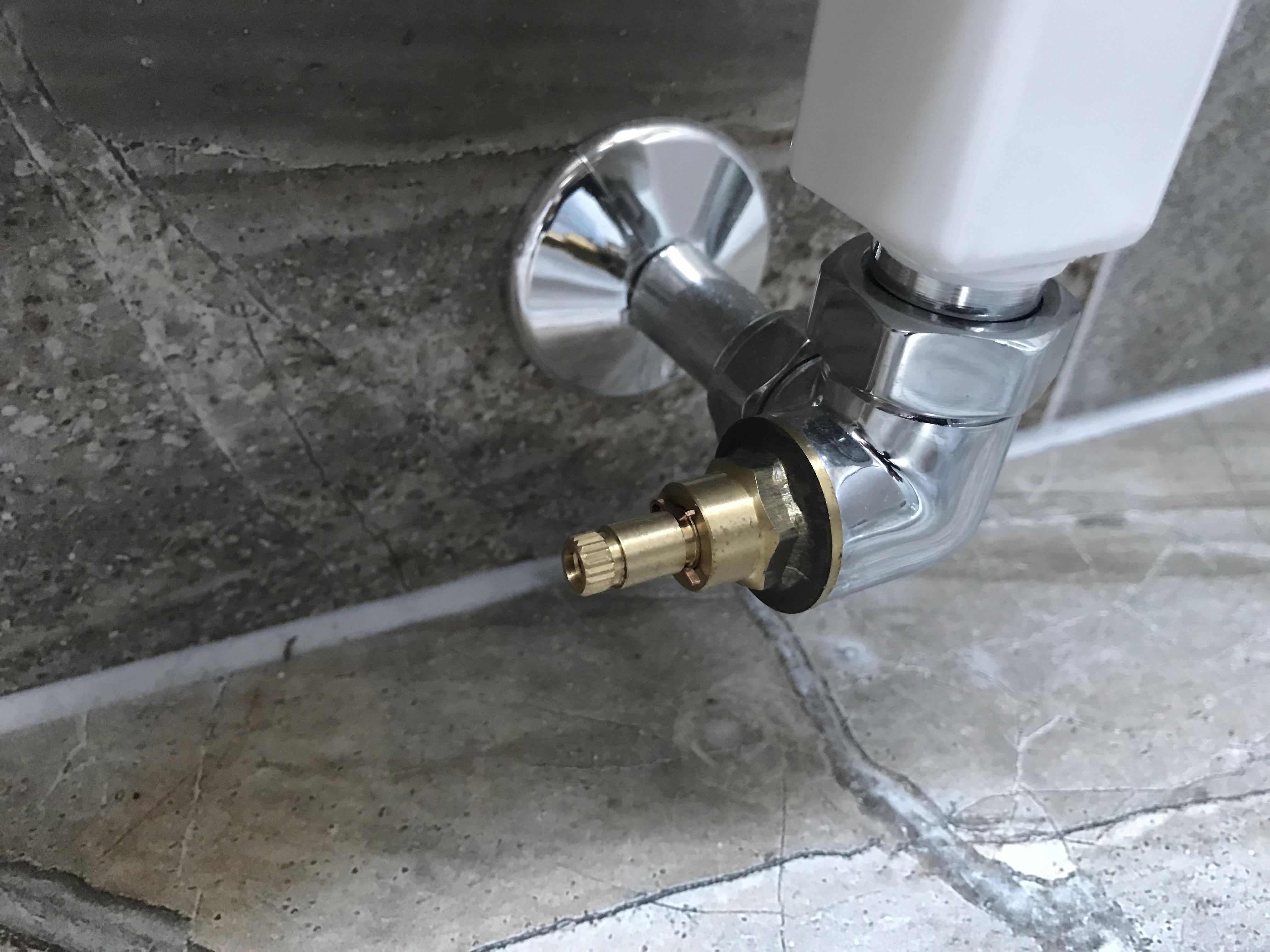

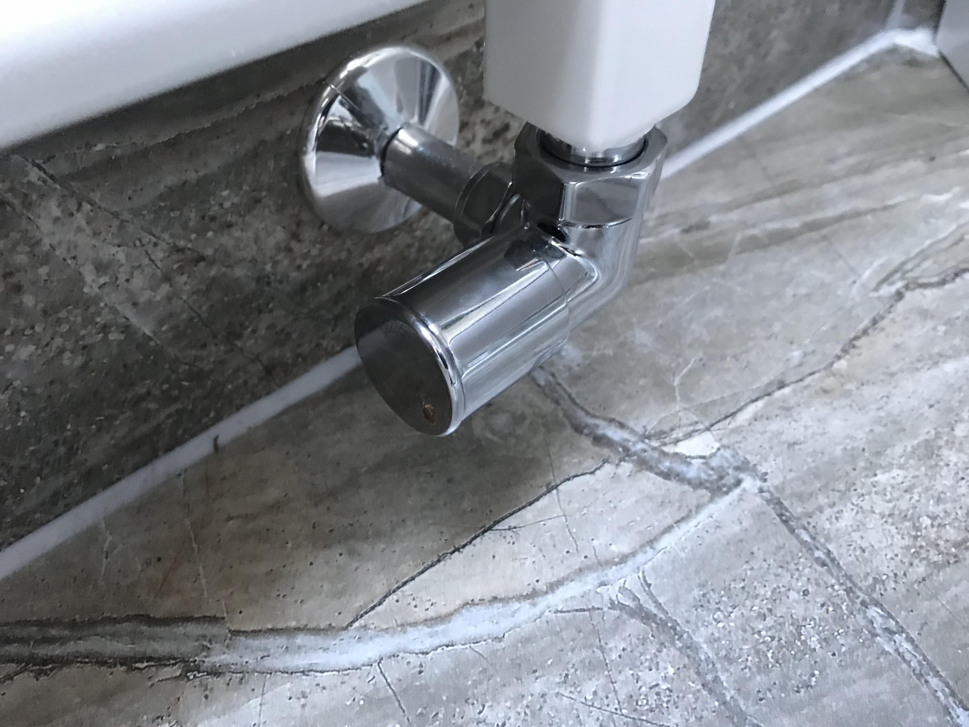

I doubt towel rail has a trv. Without a bypass of some sort you could find the boiler cutting out due to an overheat die to lack of flow
They're probably just valves then. Same question: If i turn both towel values off - would that cause an issue with the water nowhere to go (I'm showing my lack of knowledge in this area here ?)
EDIT: But... with my setup where the rads can only get flow when the downstairs UFH is on, could the lack of flow actually happen?
Edited by AliMcLeod
Yep they are probably standard valves so switching both off would potentially cause a problem.
As it stands though you can’t use the towel rads unless the UFh is on and tbh they can be pretty useful although that also depends on having a stat in a room without a TRV too - usually an upstairs hallway.
I’ve also dropped you a PM
Valves - no idea why I thought they might be TRVs.
