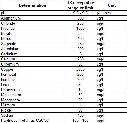

Jeremy Harris Posted July 14, 2018 Share Posted July 14, 2018 A pH of 6 is actually within limits, but probably makes the water taste slightly acidic, but TBH I doubt it'd be enough to notice. I suspect that the pH correction system was put in to fix something else, like a high dissolved metals problem, rather than just to provide a very modest correction to the pH. In general, most metals are more soluble in acidic water, and some metals are not great for health. The worry isn't with your plumbing, as very little copper is going to dissolve into water at a pH of 6, it's with whatever metals are in the ground that the aquifer feeding the spring runs through. Here are the UK acceptable limits for minerals and metals in drinking water (there is zero tolerance for coliforms, cysts etc, which are pretty much bound to be present in water from a surface spring, but the UV will kill them off as long as it has a 5µ pre-filter): There are lots of labs that will do a water test, but often it's cheaper to get your local environmental health people in the council to come out and take a sample and get it tested. They have a capped price (around £125 here) to do this and that is cheaper than the majority of labs would charge - I found that labs charged over £150 just to test a sample that I'd taken myself. There's no mandatory requirement for testing a private water supply, as long as no one other than the householders use it. The moment you allow the water to be used by others (for example paying guests at a B&B) then there is a mandatory requirement for annual testing. In terms of servicing, the UV tube needs replacing every 12 months, although they seem to last around 18 months in practice. Some UV systems have an alarm that goes off to remind you to replace the lamp, or if the lamp fails. UV lamps are bloody expensive, and I found that it's a lot cheaper to buy them in bulk direct from China (where most of them are made anyway). At the same time as the lamp is changed the 5µ pre-filter needs to be changed or cleaned. I used a washable pleated pre-filter and have two, so I can swap them over and then wash the spare ready to be swapped back the next year. Channelling is only an issue with filter media, not with limestone chippings for pH correction, so that makes me think that you've either been given duff info or the thing is doing more than just a little bit of pH correction. Link to comment Share on other sites More sharing options...

Fallingditch Posted October 8, 2018 Share Posted October 8, 2018 On 14/07/2018 at 09:36, JSHarris said: There are lots of labs that will do a water test, but often it's cheaper to get your local environmental health people in the council to come out and take a sample and get it tested. They have a capped price (around £125 here) to do this and that is cheaper than the majority of labs would charge - I found that labs charged over £150 just to test a sample that I'd taken myself. My LA was not very helpful in regard to organising a borehole test. I found a private testing company known as Lancrop or Yara based in Pocklington, Yorkshire. Their principal market is a range of tests for the the farming community. However they do offer a standard SA4 Borehole Test for £55.00 + VAT (SA4). All done by post and very efficient. For interest, my results were: Analysis Result pH 7.1 E.C. (mmhos/cm) 1.13 Total Alkalinity (mg/l) 288.1 Hardness (mg/l) 395 Total Hardness (mg/l) VERY HARD Turbidity (Units) < 4 Nitrate N (mg/l) 4.52 Nitrite N (mg/l) 0.014 Chloride (mg/l) 147 Fluoride (mg/l) 0.3 Calcium (mg/l) 113 Magnesium (mg/l) 27 Sulphur (mg/l) 53 Aluminium (mg/l) 0.001 Copper (mg/l) < 0.05 Iron (mg/l) < 0.1 Lead (mg/l) < 0.01 Manganese (mg/l) 0.61 Zinc (mg/l) < 0.01 Coliform Count (no/100ml) 0 E Coli (Beta G Pos) (mpn/100ml) 0 TVC 22C (in 1ml) 0 TVC 37C (in 1ml) 0 Link to comment Share on other sites More sharing options...
Jeremy Harris Posted October 8, 2018 Share Posted October 8, 2018 That's a very good price for water testing, much cheaper than the nearest commercial lab to us. That's also really hard water you've got! The LA have a legal obligation to provide a water testing service for private water supplies, so cannot dodge it. Private supplies that feed more than one house, or that feed something like a bed and breakfast or hotel, have to be annually tested, I believe, and the LA also have an obligation to do this (and charge for it). I found that our LA were reluctant to do a water test, though, as the government have capped the actual test price they can charge to a level that is less than the LA has to pay a lab. As a consequence, our LA will not accept samples of water for testing, they insist on coming out and taking the sample themselves. By doing this they can charge for taking the sample, which is the lion's share of the £125 we paid. BC wanted to see a certificate from the LA Environmental Health people to sign off our build, so we didn't have any choice by to pay. Link to comment Share on other sites More sharing options...
