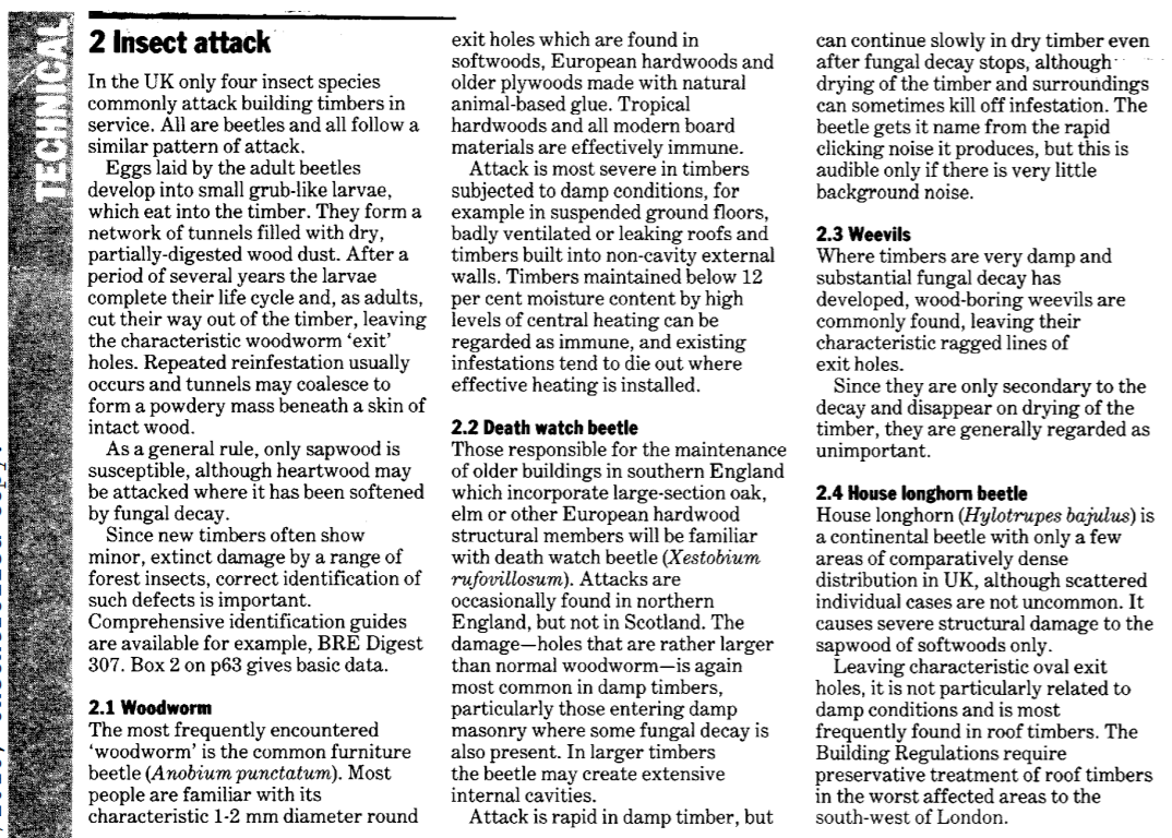

Ian Posted July 2, 2018 Posted July 2, 2018 33 minutes ago, JSHarris said: I don't think there's a significant risk, because of the low moisture content in the wood, the relatively low RH in the house and the lacquer finish, but does anyone else know any different? The risk is completely insignificant and nothing to worry about. Extract from a BRE paper on the subject: 1

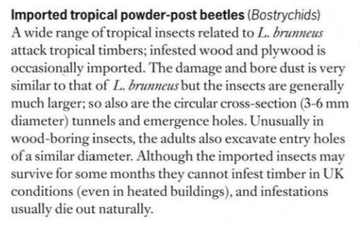

Ian Posted July 2, 2018 Posted July 2, 2018 and an extract from another paper which talks about insects on imported timber: 1

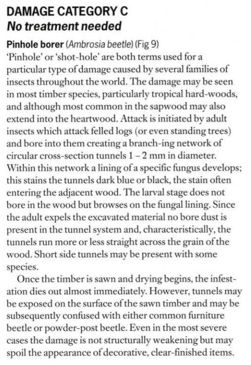

Jeremy Harris Posted July 2, 2018 Author Posted July 2, 2018 Very many thanks, @Ian. That confirms my thought that the larvae were most probably in the bit of wood before the bed was made and have spent the last year or two maturing in there before making good their escape. I was reasonably sure that there was no real risk, but as the whole house is made of timber there was a niggle in the back of my mind! I think the chances that any of the half dozen beetles that escaped could have found anything to suitable to lay eggs on will have been miniscule. From your info, I think the most likely culprit may have been the "pinhole borer", as the holes are around the same size as those from the common furniture beetle, certainly no bigger than 2mm, and closer to 1mm, and I'm certain that the furniture was imported from the Far East. It's some species of oak, but doesn't look at all like either European or American oak to me. It didn't come from Oak Furniture Land (who I know import all their stuff from the Far East) but from a local supplier who seems to have access to the same manufacturers that Oak Furniture land use, but who has more honest and reasonable sales practices.

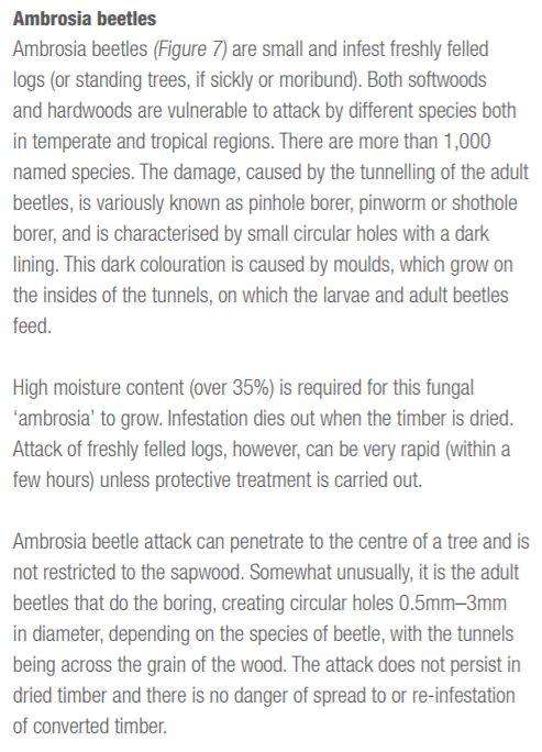

Ian Posted July 2, 2018 Posted July 2, 2018 @JSHarris No problem. Attached below is another extract; this time from a TRADA document confirming that the pinhole borer (Ambrosia Beetle) is not a risk to dry timber and there's no risk of spread or re-infestation 1
Jeremy Harris Posted July 2, 2018 Author Posted July 2, 2018 Thanks, that's very reassuring indeed - I can stop crawling around in the eaves looking for signs of beetle holes...
