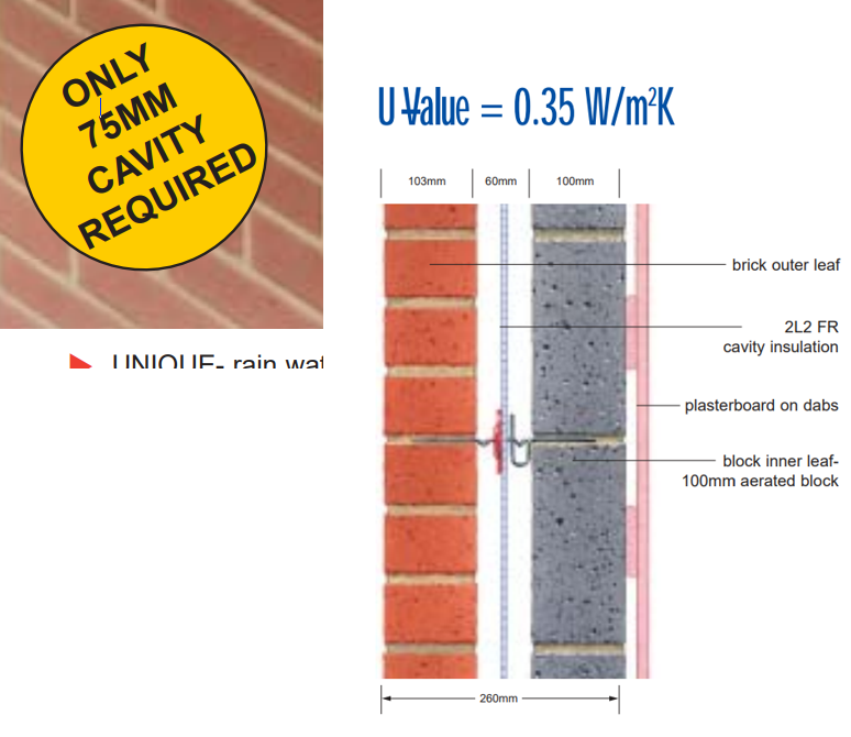

A_L Posted June 25, 2018 Share Posted June 25, 2018 The absolute minimum is a 25mm cavity, with battens to carry insulation and 75mm of PIR (to achieve U=0.3). Mineral wool will be 50% thicker to have the same effect. I would not use 2L2 on the cold side of the insulation as it is a plastic sheet and when taped at the edges a vapour barrier and in the wrong position. I think 100mm PIR would be reasonable but it may depend on how much floor area you are willing to lose. Link to comment Share on other sites More sharing options...
Daniel C Posted June 25, 2018 Author Share Posted June 25, 2018 I was just looking at their brochures and installation guides, It does not seem the best as they state minimum 75mm cavity, then they shaw a drawing for just 60mm... but they install it between brick wall and aerated block (I assume this is serves insulation purpose): I assume I need to seal the cavity from the roof and crawl space ends, am I right? Link to comment Share on other sites More sharing options...
