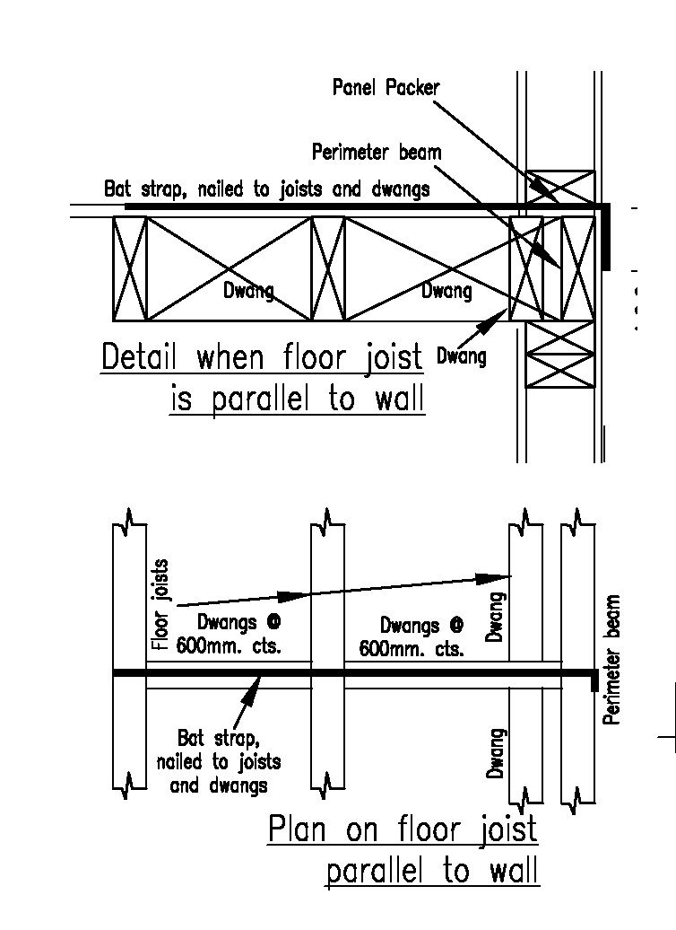

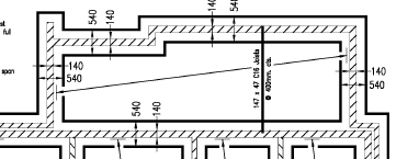

Thedreamer Posted May 7, 2018 Share Posted May 7, 2018 Nearly got a list of materials together for cutting our kit on site. One point not sure of, we have a small lean to at the back, for our utility room, at the end of each joists can you do without straps at the end of the joists for small rooms like this utilities and porch etc (the joists are approximately 2 meter width). Link to comment Share on other sites More sharing options...
Tennentslager Posted May 7, 2018 Share Posted May 7, 2018 Batstraps....what are they? Joist hangers maybe? Anyway, if it's less than 2m, screw or nail away, what could possibly go wrong Link to comment Share on other sites More sharing options...
Thedreamer Posted May 13, 2018 Author Share Posted May 13, 2018 Here is what's in the plans. I have come to a conclusion that we only need these for the main rectangle of the house. Link to comment Share on other sites More sharing options...
Tennentslager Posted May 13, 2018 Share Posted May 13, 2018 Looks like these https://www.buildingsuppliesdirect.com/timco-ld-bent-restraint-strap-ss-range?gclid=Cj0KCQjwxN_XBRCFARIsAIufy1ag1NToOqcljhMAtDf6AazYPhsAmMlU_gTmtzwsYufRhLh9wxGXxc0aAgEVEALw_wcB Cheap so why not put em in... Link to comment Share on other sites More sharing options...
