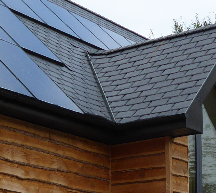

Jeremy Harris Posted March 30, 2018 Share Posted March 30, 2018 We used pre-formed GRP valleys. If using slate, I found that the type with the upstand in the centre look much neater, as the cut edges can be abutted to the upstand, making the valley less obtrusive looking. I still have two grey GRP normal valley sections (i.e. not the ones with the centre upstand) left over, as we had the wrong type supplied, so if anyone wants them they can have them if they collect them. This is what ours look like with the upstand bit in the centre: 1 Link to comment Share on other sites More sharing options...
Jeremy Harris Posted March 30, 2018 Share Posted March 30, 2018 FWIW, the two lengths of GRP valley that I have going spare, if anyone wants them, are exactly the same in @Tin Soldier's first link, but they wouldn't be my first choice for a slate roof, as I think the raised upstand tends to hide the valley a bit better, and doesn't leave the edges of the cut slates on show. Link to comment Share on other sites More sharing options...
