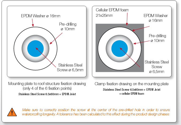

5 hours ago, Barney12 said:
The clamps screw down through the trays and into correctly spaced roofing battens.
What is done to seal around the bolt and the tray?

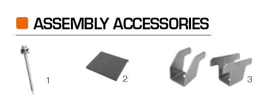

EPDM washer (1) on the screw and EPDM gasket (2). It does look pretty basic TBH.
