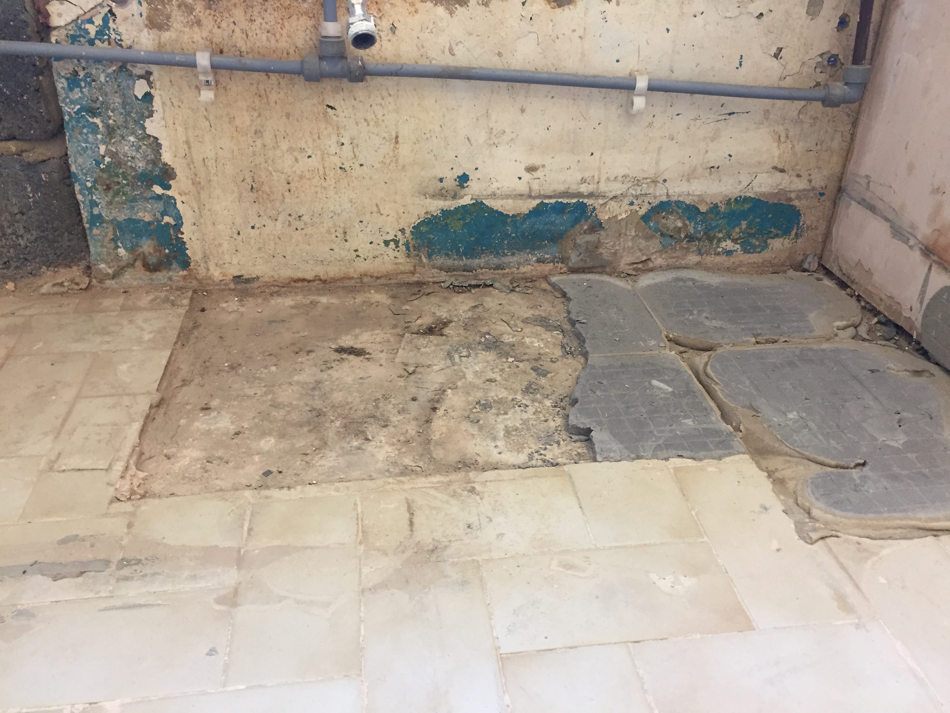

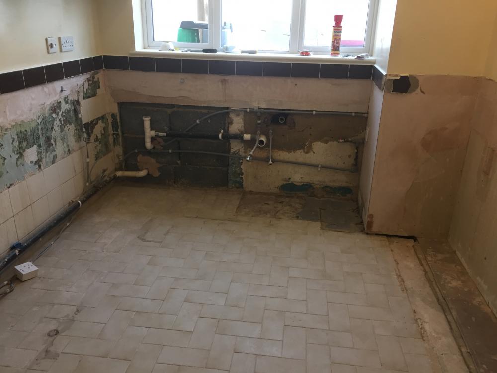

Onoff Posted March 9, 2018 Posted March 9, 2018 (edited) Posting this on behalf of a mate: "Lifted up the newer tiles back to the original ones. Gonna just tile over them like what was done before. What would you do for the back corner? Still need to take up the old adhesive but gonna have about a 15mm deep gap where no original tiles were. The washing machine is going there so don’t know if I’ll be able to get away with adding extra adhesive to raise those tiles or should use something else?" I was thinking bring up to level with existing tiles, a decent self levelling "something"? Or a strong SBR laden screed levelled off. How to prep though? Cheers Edited March 9, 2018 by Onoff
Nickfromwales Posted March 9, 2018 Posted March 9, 2018 2-part self leveller for the deficit. If the old tiles are sound then crack on. If there's any hint of movement then chuck a Ditra mat over it or it's a suicide mission. 1
Onoff Posted March 10, 2018 Author Posted March 10, 2018 8 hours ago, Nickfromwales said: 2-part self leveller for the deficit. If the old tiles are sound then crack on. If there's any hint of movement then chuck a Ditra mat over it or it's a suicide mission. Cheers. Any particular make of compound?
Nickfromwales Posted March 10, 2018 Posted March 10, 2018 Any 2-part TBH, Ultra or Ardex. Ardex is expensive so try and find a BM that stocks the Ultra if you can as it's prob half the price and I can't tell them apart once laid. Ultra 2-part.
Onoff Posted March 10, 2018 Author Posted March 10, 2018 (edited) 11 minutes ago, Nickfromwales said: Any 2-part TBH, Ultra or Ardex. Ardex is expensive so try and find a BM that stocks the Ultra if you can as it's prob half the price and I can't tell them apart once laid. Ultra 2-part. Says only up to 12mm for the Ultra or you have to bulk it out: "Level IT Two can be applied at depths between 2 and 12mm. For deeper sections up to a maximum of 30mm, it is necessary to bulk out with a suitable graded aggregate filler. This can drastically prolong curing times so allowances must be made accordingly". He's worried about the wm going on top. Or just lay to the 12mm max depth and let the tile adhesive take up the rest? (What tile adhesive will be the next question! ) Edited March 10, 2018 by Onoff

Nickfromwales Posted March 10, 2018 Posted March 10, 2018 I prefer to pour something 'pissy' when patching in. A patching screed doesn't creep and key in anywhere near as good without a load of prep and priming etc. £20. Mix - pour - forget. .
Onoff Posted March 10, 2018 Author Posted March 10, 2018 (edited) 12 minutes ago, Nickfromwales said: I prefer to pour something 'pissy' when patching in. A patching screed doesn't creep and key in anywhere near as good without a load of prep and priming etc. £20. Mix - pour - forget. . So the Ultra will be OK above 12mm without bulking out? Says with this Mapei stuff you can add 20 - 30% sand for thicknesses greater than 10mm: latexplan.pdf Edited March 10, 2018 by Onoff
Nickfromwales Posted March 10, 2018 Posted March 10, 2018 Or a bag of dash if there's one handy. Adding sand dries it out.
Onoff Posted March 10, 2018 Author Posted March 10, 2018 (edited) 19 minutes ago, Nickfromwales said: Or a bag of dash if there's one handy. Adding sand dries it out. Would a single layer of 10mm pea shingle first work? To bulk it out and have gaps for the compound to run between and key to the existing substrate? All I could find chippings wise was this: https://www.travisperkins.co.uk/Grano-6mm-Dust-Trade-Pack/p/996251 Edited March 10, 2018 by Onoff
Onoff Posted March 10, 2018 Author Posted March 10, 2018 (edited) 30 minutes ago, Nickfromwales said: Or a bag of dash if there's one handy. Adding sand dries it out. What's "dash"? EDIT: JUST twigged, pebbledash! Same question as before then, how thick a layer in the bottom of the void? And should it be "gappy" to allow the muck to bond to the solid stuff underneath? Ta. Edited March 10, 2018 by Onoff
Onoff Posted March 10, 2018 Author Posted March 10, 2018 This is easiest for him to get! https://www.wickes.co.uk/Wickes-10mm-Gravel-Pea-Shingle-Major-Bag/p/220128
Nickfromwales Posted March 10, 2018 Posted March 10, 2018 10mm is a bit big if he's filling 12mm. Depends on how much tile adhesive is going over it afterwards.
Onoff Posted March 10, 2018 Author Posted March 10, 2018 25 minutes ago, Nickfromwales said: 10mm is a bit big if he's filling 12mm. Depends on how much tile adhesive is going over it afterwards. He reckons he's got 15mm of depth to fill. Dunno where he'd get small bags of 6mm chippings. The TP stuff is 6mm to dust.
Nickfromwales Posted March 10, 2018 Posted March 10, 2018 No dust ! Ordinary dash should be available in small bags, but if filling 15mm then 10mm chippings should be fine.
