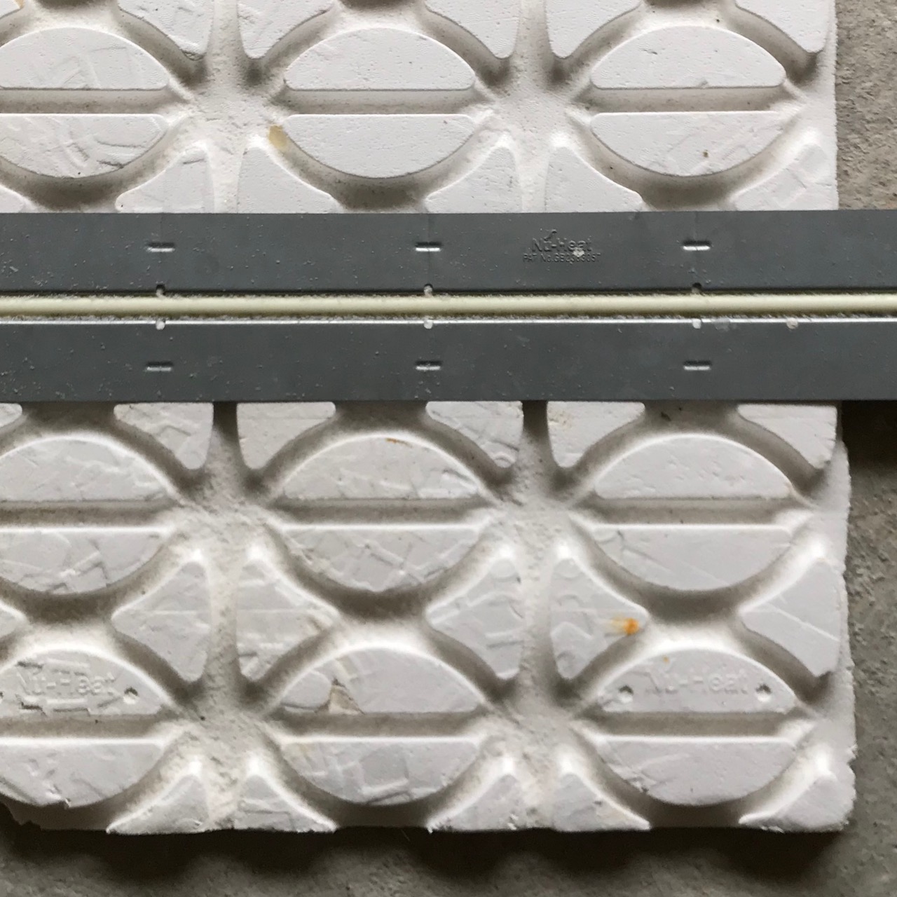

Apologies if this has been asked before but I'm looking to install UFH upstairs on a new build. There seems to be a million dry and screed options. Can anyone recommend the best / cheapest system to go on posi joists?
Have a look at Nu-heat ( https://www.nu-heat.co.uk/underfloor-heating/floor-constructions/joisted/ ) for some UFH options. They do a a clippa plate system which can go between or over joists. I will probably be using the polystyene panel system which sits on top of the floor decking as I have already fitted the deck,  increases the floor depth by 25mm. Lots of systems out there to look at.
Edited by JamesP
Below is my first floor option. Polystyrene with aluminium spreader plate.
poly: alu plate.jpeg
