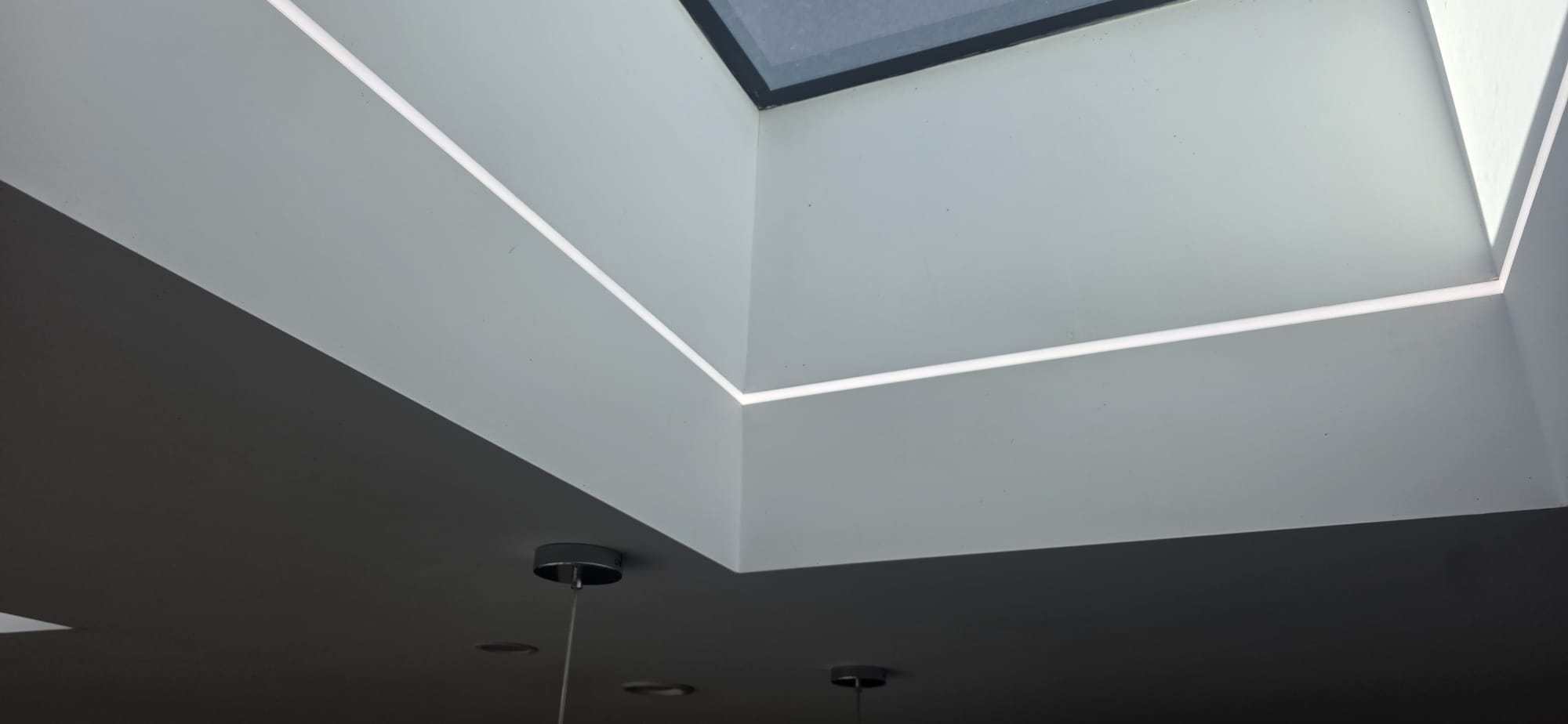

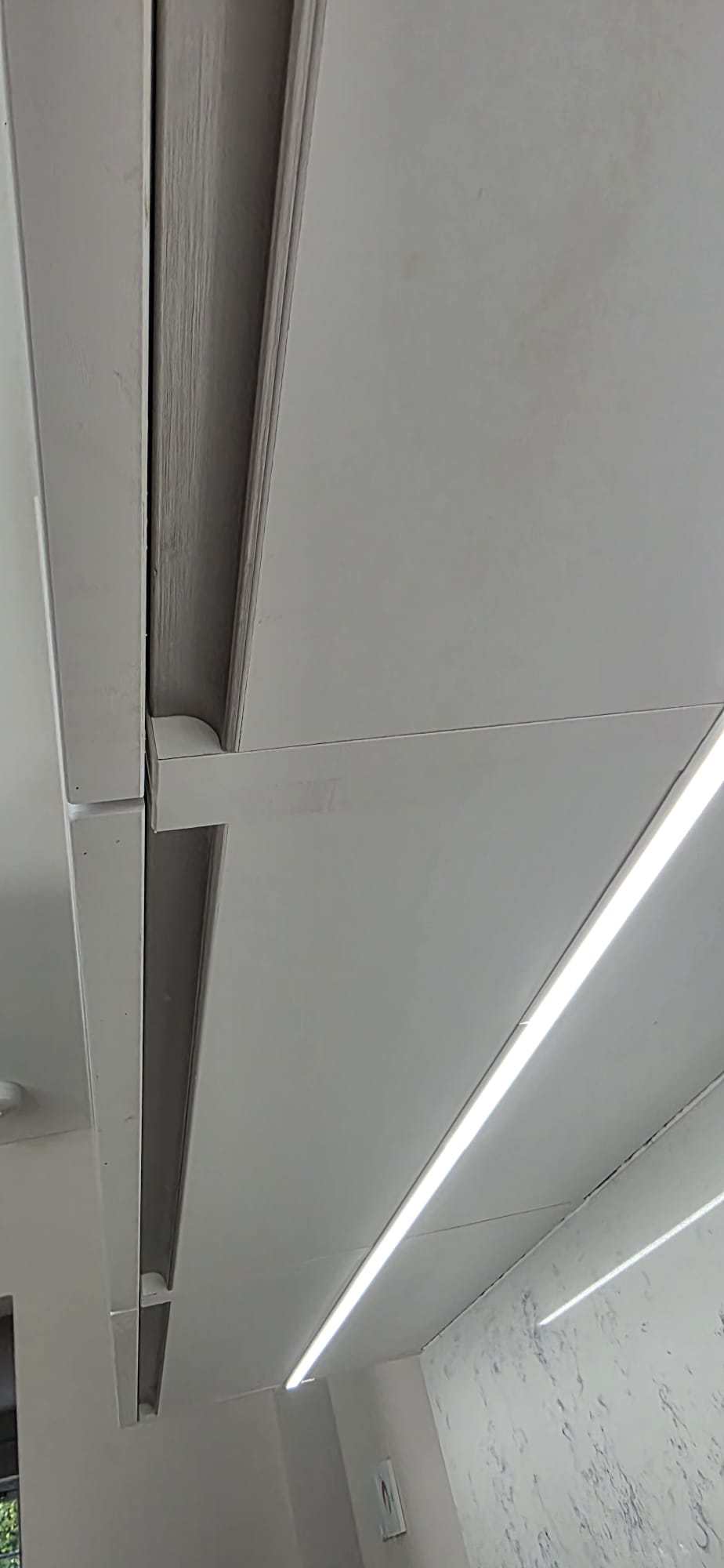

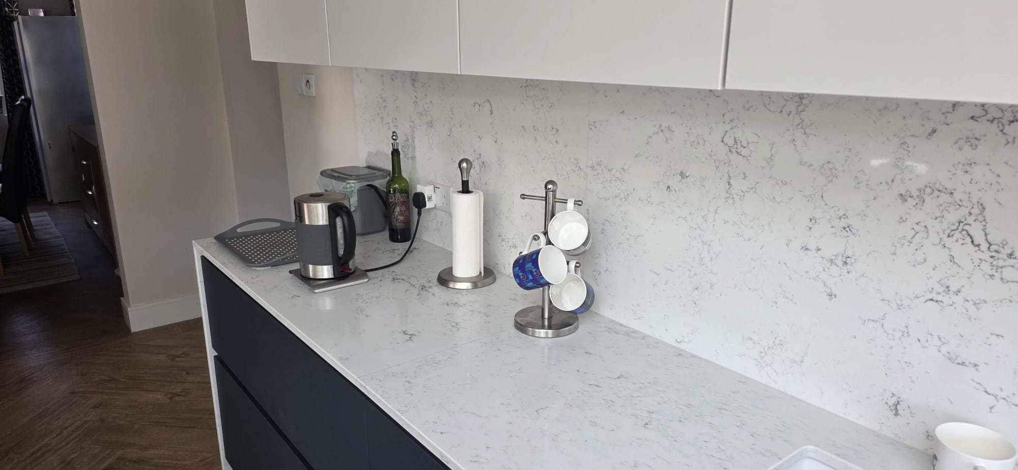

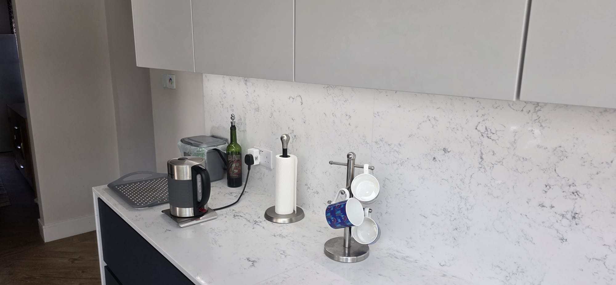

Tetrarch Posted 7 hours ago Posted 7 hours ago In a previous house I had an LED strip right behind the pelmet/cabinet rail. This was old tech and I had "dotty" LED's that went yellow in very short order and the positioning wasn't right. I replaced this with an 45-deg angle bead channel at the very back - this cast a shadow and wasn't good either Roll forward to 2024 and lessons learnt. I (had) routed a channel right in the centre of the cabinet. This positions it a quarter of the way towards the front of a 600mm worktop. You also need to take into account the reflectivity of your splashback as this changes the light considerably. Ours is actually the same as the worktop in white so highly reflective The channel has wings that cover the routed channel edges - definitely a good idea Go for a high-quality as many LED's per m as you can afford as this smoothes out the light I went for a CCT strip that is co-ordinated with the same (but non-winged) channel in the rooflights. This makes mood setting really easy of an evening. It works so well that I felt able to not include the hideous cost of LED cabinet lighting from the manufacturer. Would I change anything? Hmmm - I don't think so. We had three years to plan due to planning so we had a very good idea of what we wanted and Mrs Tet was happy to delegate that part of the kitchen largely to me I attach some pictures below Regards Tet I should really take some proper pictures but that would mean a LOT of tidying up...
