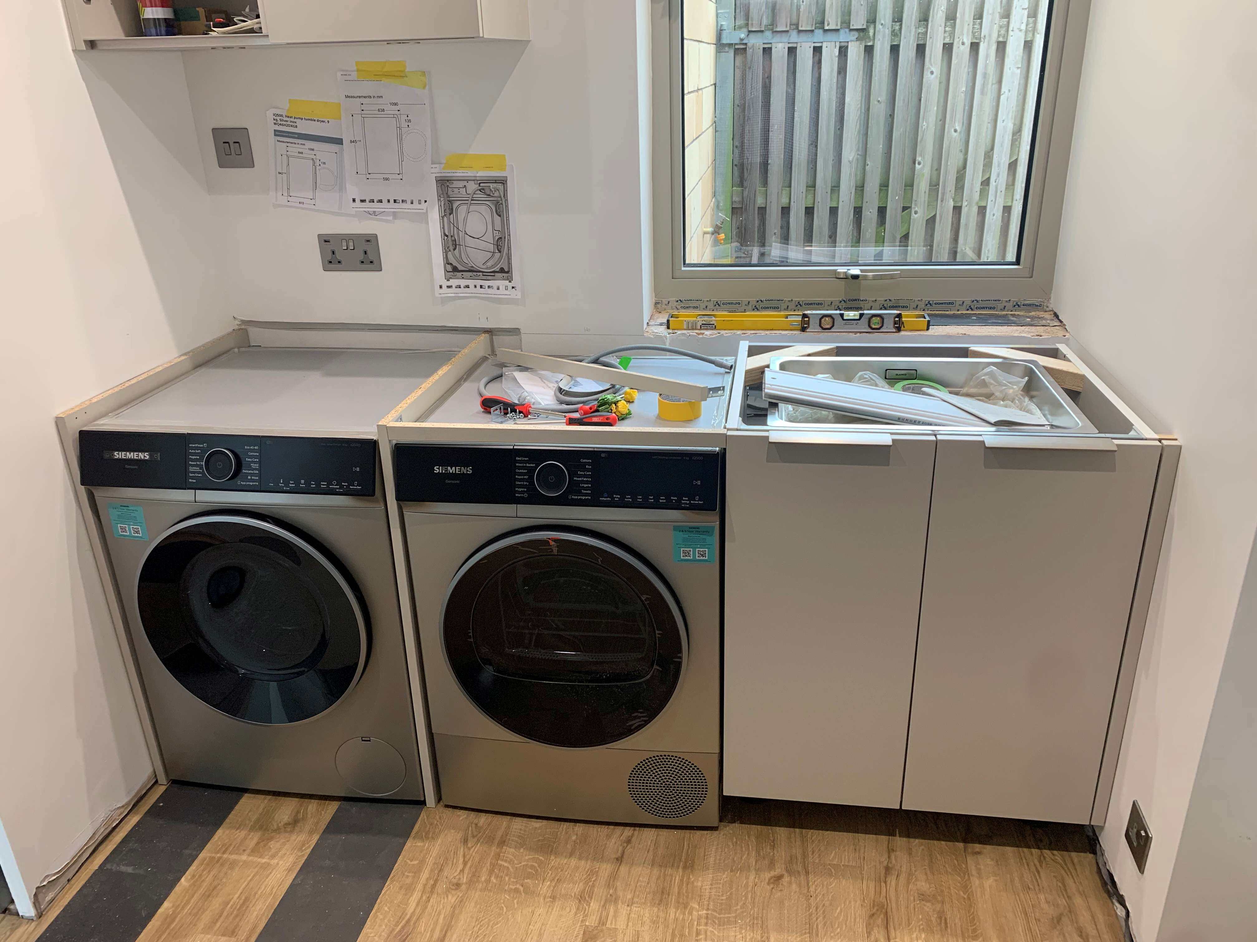

Yesterday someone reinstalled a sink unit & 2 appliance bay side panels for washing machine and dryer.

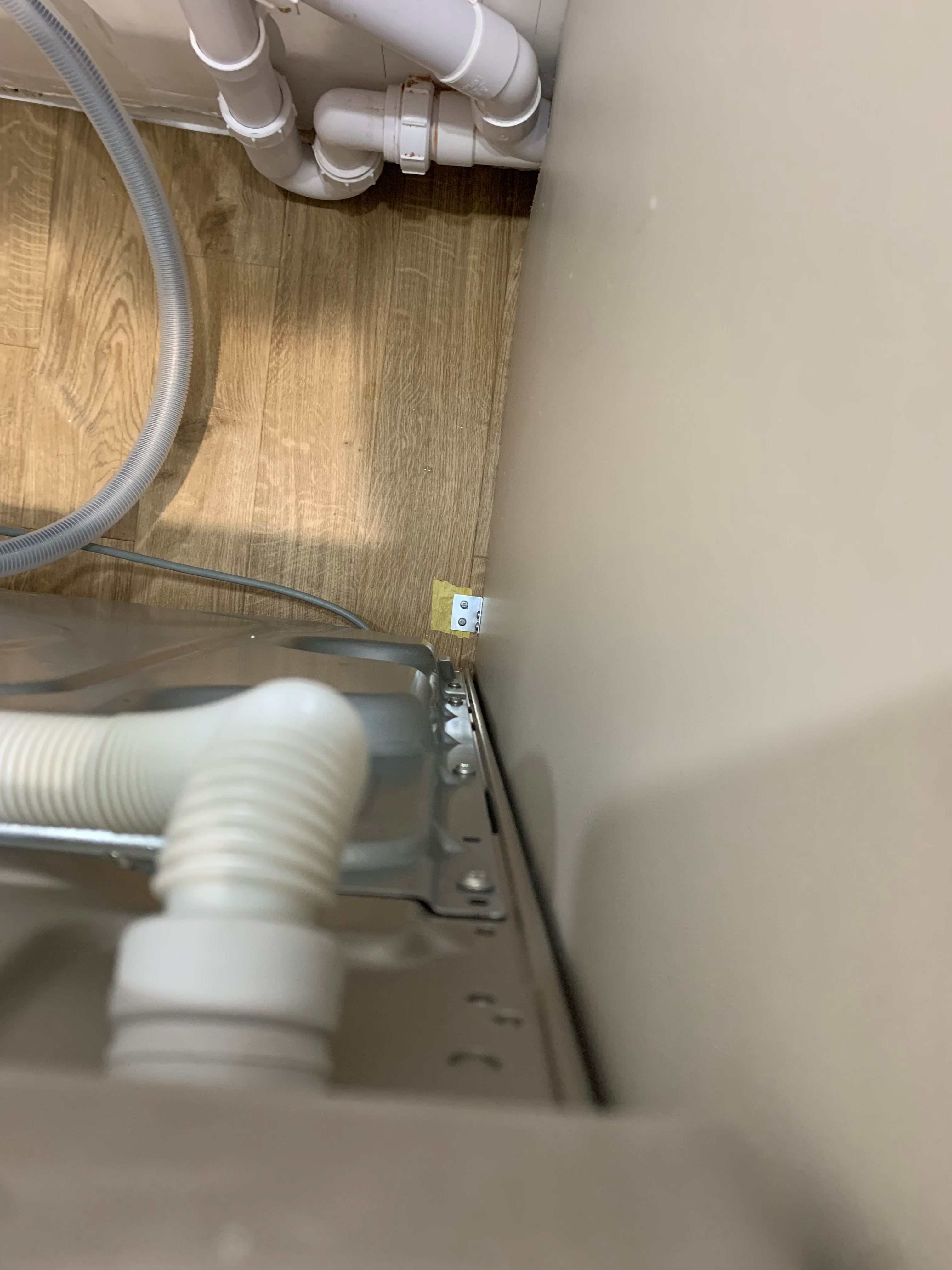

The dividing panels were fixed to the wall at the back end. but still had some angle on them. So the someone put right angle brackets in at floor level between the floor and the panel. Last night I tried to put the washing machine in it's bay. It won't go in and out because the brackets stop the machine legs being pushed in and out. I had to remove them.

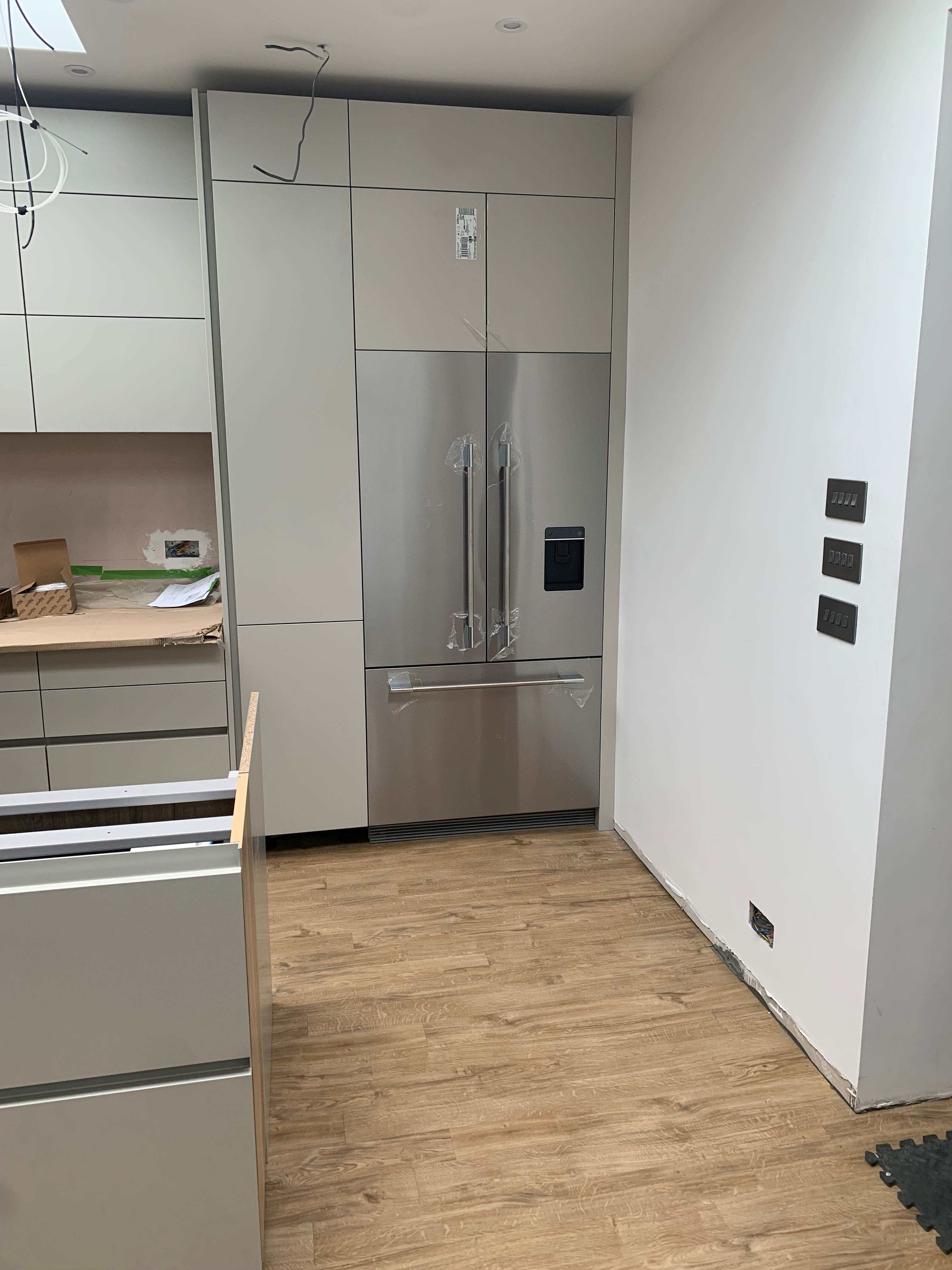

Pics attached including one of my nicely fitted fridge freezer (sadly the wrong handle style ended up on the order, delivered in a box, sat around for months, then installed and error spotted)

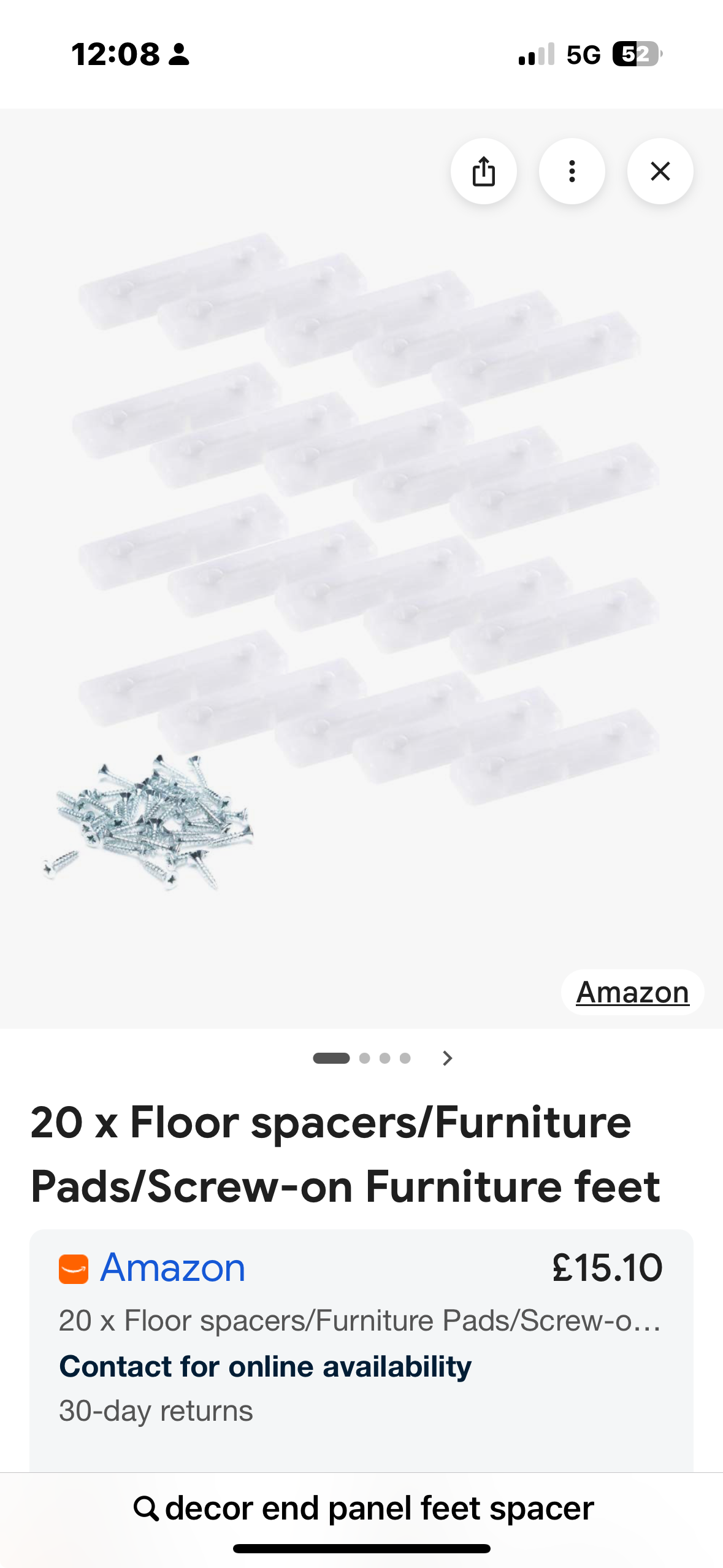

These kind of things are available:
Thanks @Nickfromwales, but I cannot seem to find those on Amazon when I use the same search term or indeeed search on the full item description.
I am not sure we are talking the same thing ? I attach a photo of what the fitter did. He was trying to hold the panel in the correct position at the bottom - not raise it or correct the height. I think if it was better secured at the back against the wall and exactly plumb vertical it should naturally sit correctly ? It potentially needs an invisible fixing under the panel like a dowel or perhaps a cradle shape fixing that would slide tight (and thinly) over the 19mm panel width after being fixed to the floor.
The appliance bays are only 610 wide, so only 5mm each side of the machine.

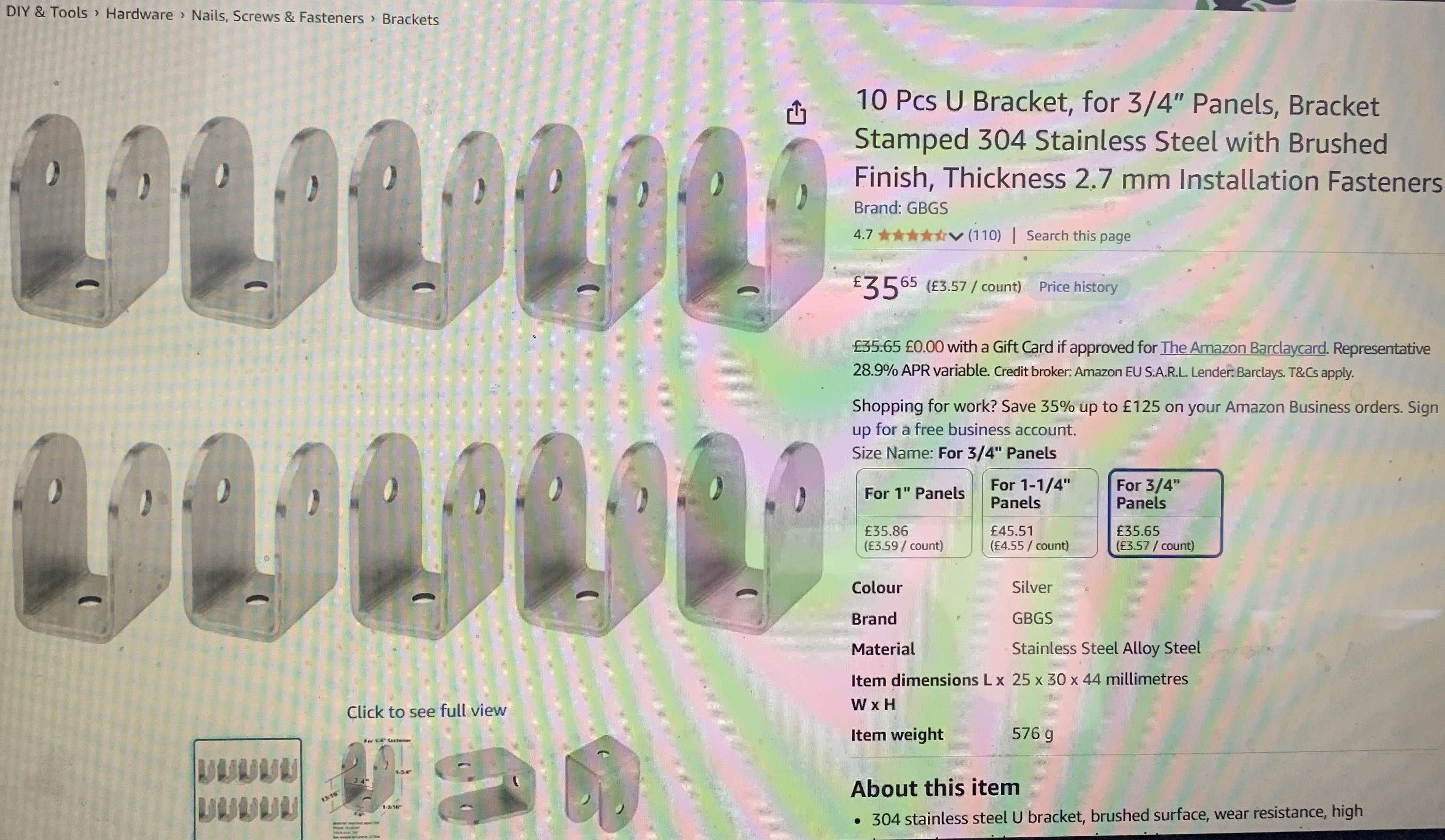

Possibly the attached type U shaped brackets, suggested by ChatGPT. (Nick vs ChatGPT - hmm ?)
Apparently there are similar fixings for holding toilet partition panels ?
However these still protrude 2-3mm each side of the panel, and if they don't take a recessed screw even more. My fitter was using domed round head screws which really doesn't help. But then somewhere else he was screwing into a 19mm panel from both exact opposite sides in the same place using 16mm thread screws 🙄. I have got loads of screws of all sorts of sizes on site - he only had to ask - very short screws always seem to come in handy.

Quite. I agree. Fitter just arrived again this morning, trying to tell me the floor brackets need to go back in. I have said no.
Given the panel must itself be straight not warped, if the front edge is not running plumb vertical then it must mean the back edge is not fixed to the wall plumb vertical. Putting a floor bracket in to forcibly push the front of the panel upright so it is in tension cannot be right. It was all fitted once before the floor went down then removed to put the floor down due to missing parts. In refitting it the floor is therefore now about 5mm higher - 2.5 smoothing compound and 2.5 LVT. However fitter decided to fit the small back wall brackets into the same holes in panel and wall - consequently they are twisted downward by about 5mm now. Just lacks due care and attention.
