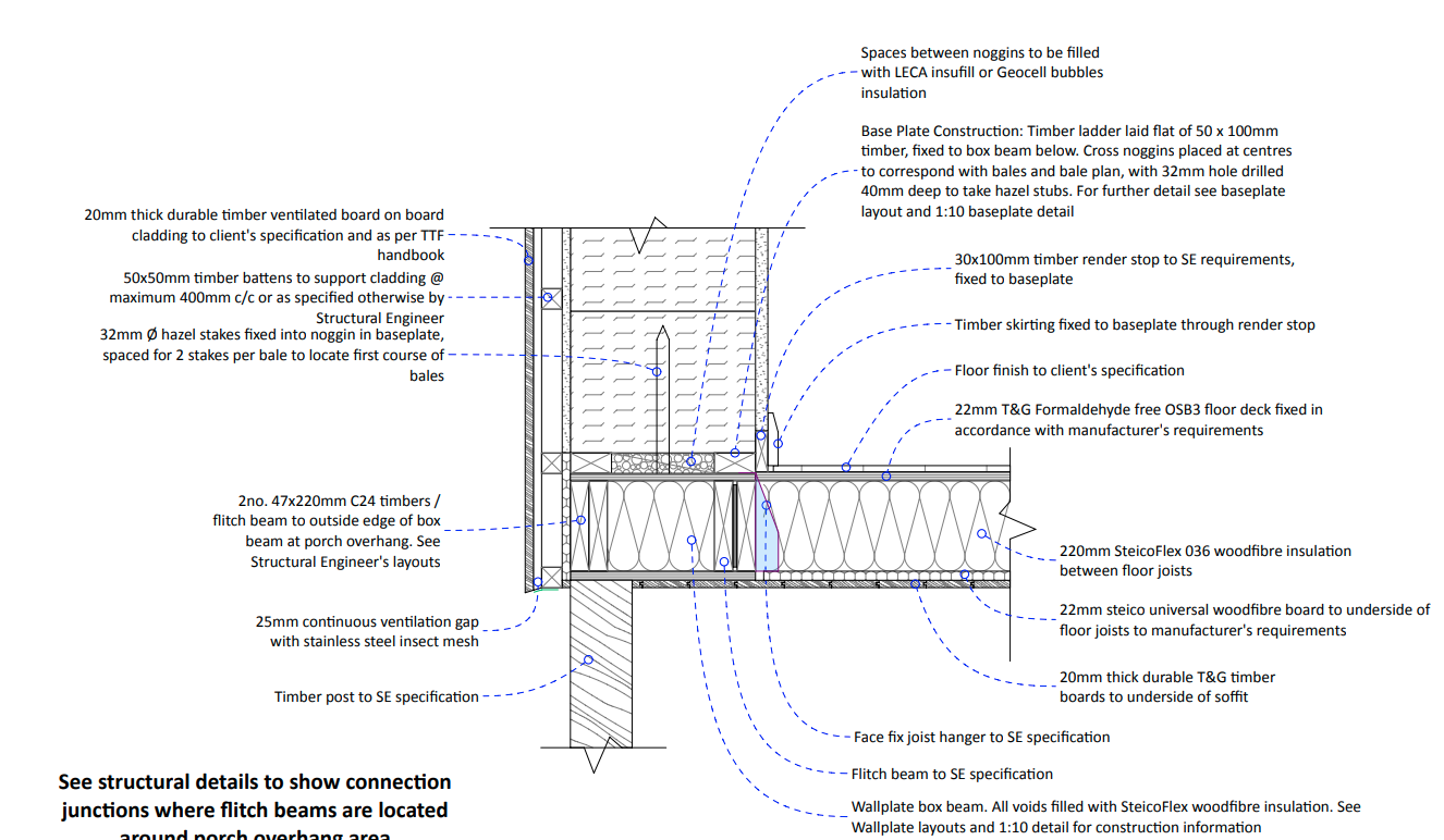

Thanks for allowing me join this self-builder community. I'm building my home, and first project of this scale, in Norfolk with my husband. We are trying to be considerate of sustainability and use local materials when possible within our rather modest budget. Our architect has designed a timber framed structure with straw bale walls. We are doing all the construction work ourselves unless it requires certification, specialists or we get stuck!
Neither of us have formal building experience, so are learning as we go. I'm hoping this forum will be an invaluable source of information and advice. I'd really appreciate anything which helps us get things right first time and avoids costly mistakes!

Welcome! Is this wrap-round or infill? If the latter what are you doing to mitigate the thermal bridge of the posts? Out of nosiness what is the insulation detail for the floor of the oversailing part?

From the plans I would say the foamed glass ball -type insulation is designed to prevent thermal bridging around the timber ring beam structure.

Err... this looks to me like a timber footing/base with load-bearing bales built on it - i.e. no frame. Is that right, or do I just need to see more bits of the dwgs? Have you got any which show the frame? (an un-clad elevation, for example).
There are uprights between the base + wall plates. The bales are not load-bearing but will be ratchetted down during construction to compress them.

Thanks, I understand now. Depending on the size of the uprights it'll be load-bearing or semi-load-bearing then.
