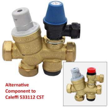

I have a Caleffi 533201 PRV with integrated check valve to protect the upstream mains supply, but interestingly nothing between the outlet for cold and the outlet to the cylinder. When cylinder fills with cold water and is then heated up, could the water not expand back up the cylinder feed and through the Caleffi manifold into the expansion vessel (or cold) branch? If the next tap to be turned on is a cold one that water would get pushed into the cold branch.
