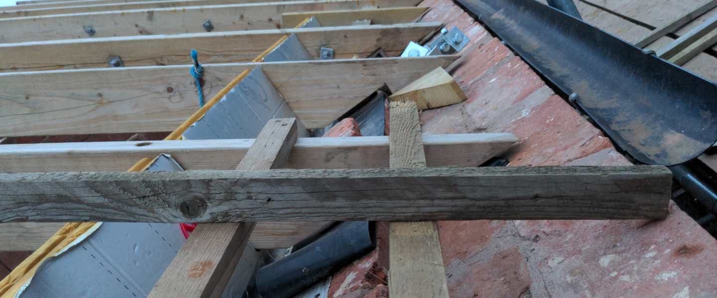

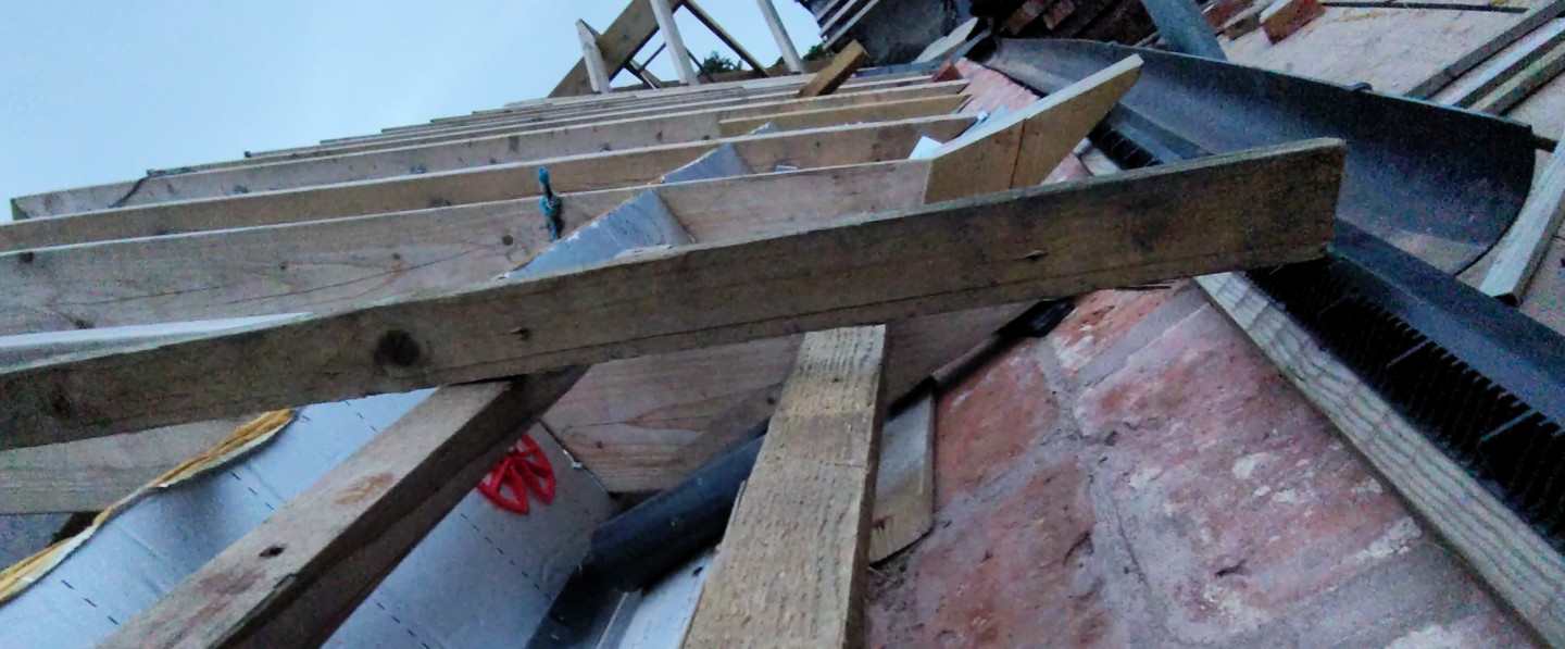

I've managed to get all of the eaves and rafters to play nice with each other. The plane of the battens either meets the edge of the brickwork, or steps in a little. This would work OK for the eaves and first course of plain tiles. A bit late in the game I thought to try and squeeze in an over fascia vent. The vent itself is 25mm tall and if it's fixed to a 19mm batten it creates quite a kick up.  I haven't come up with a way to secure the vent to the brickwork without the timber. The gap in the image caused by the kick up looks huge - it's probably 12-15mm.
How much kick up is too much?
I think you need to put some tiles on there to see how they lay.

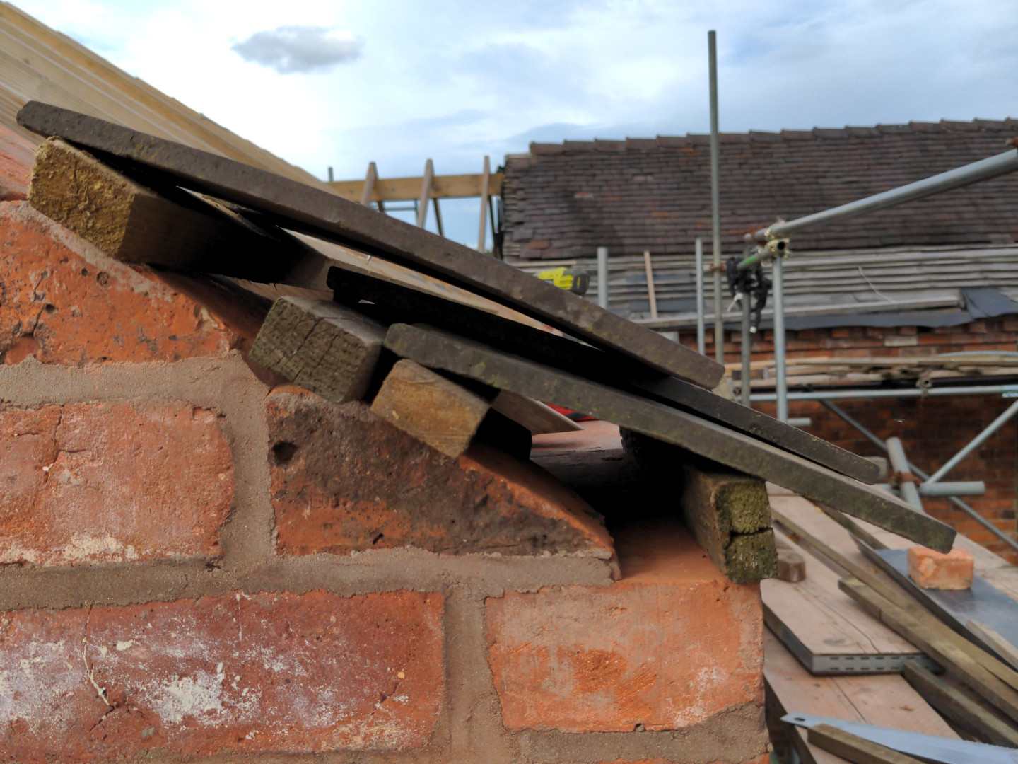

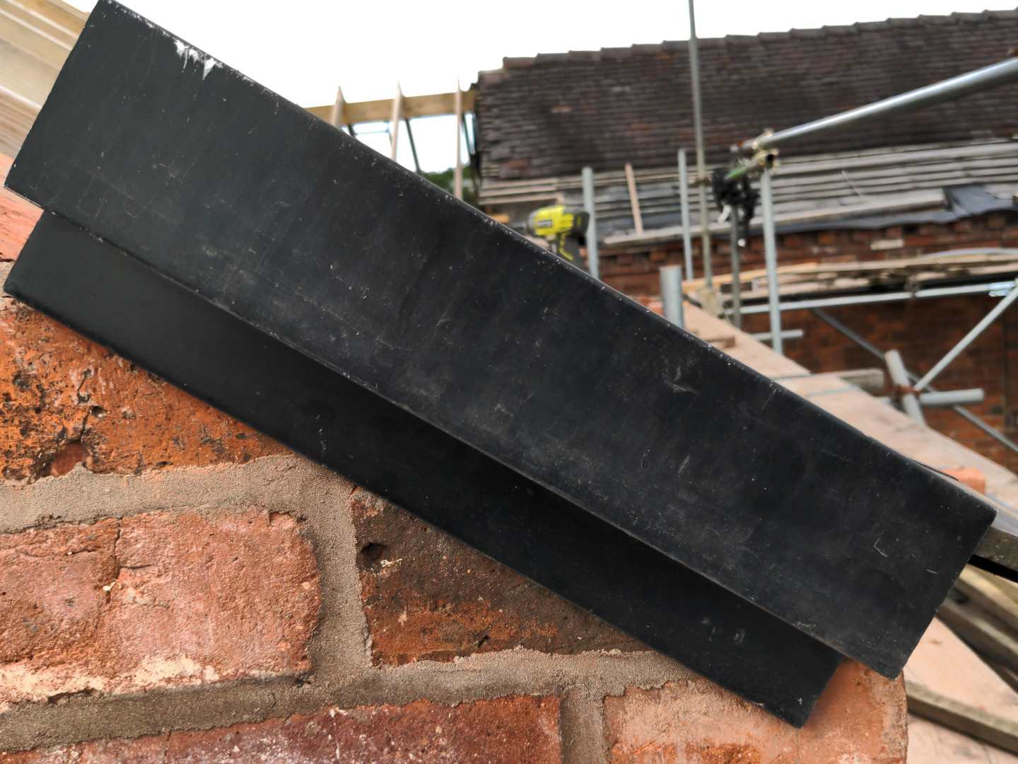

I've put a few rows on at the gable. Vent and batten will kickup ~34mm. It doesn't look wrong with a 38mm kickup from the brickwork.
I hadn't considered that it might upset the verge. It looks like the verge I am planning to use will accommodate.
