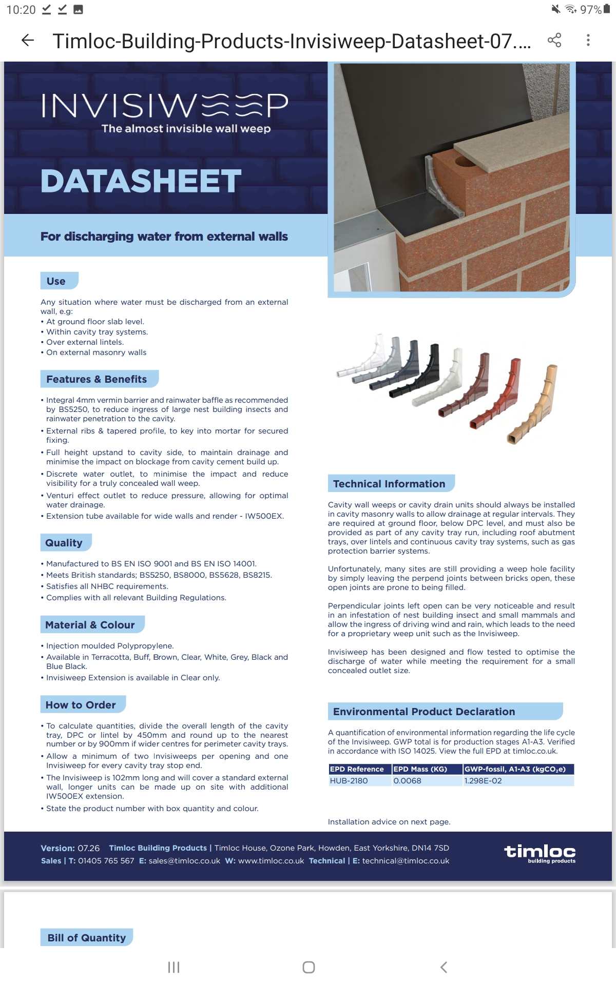

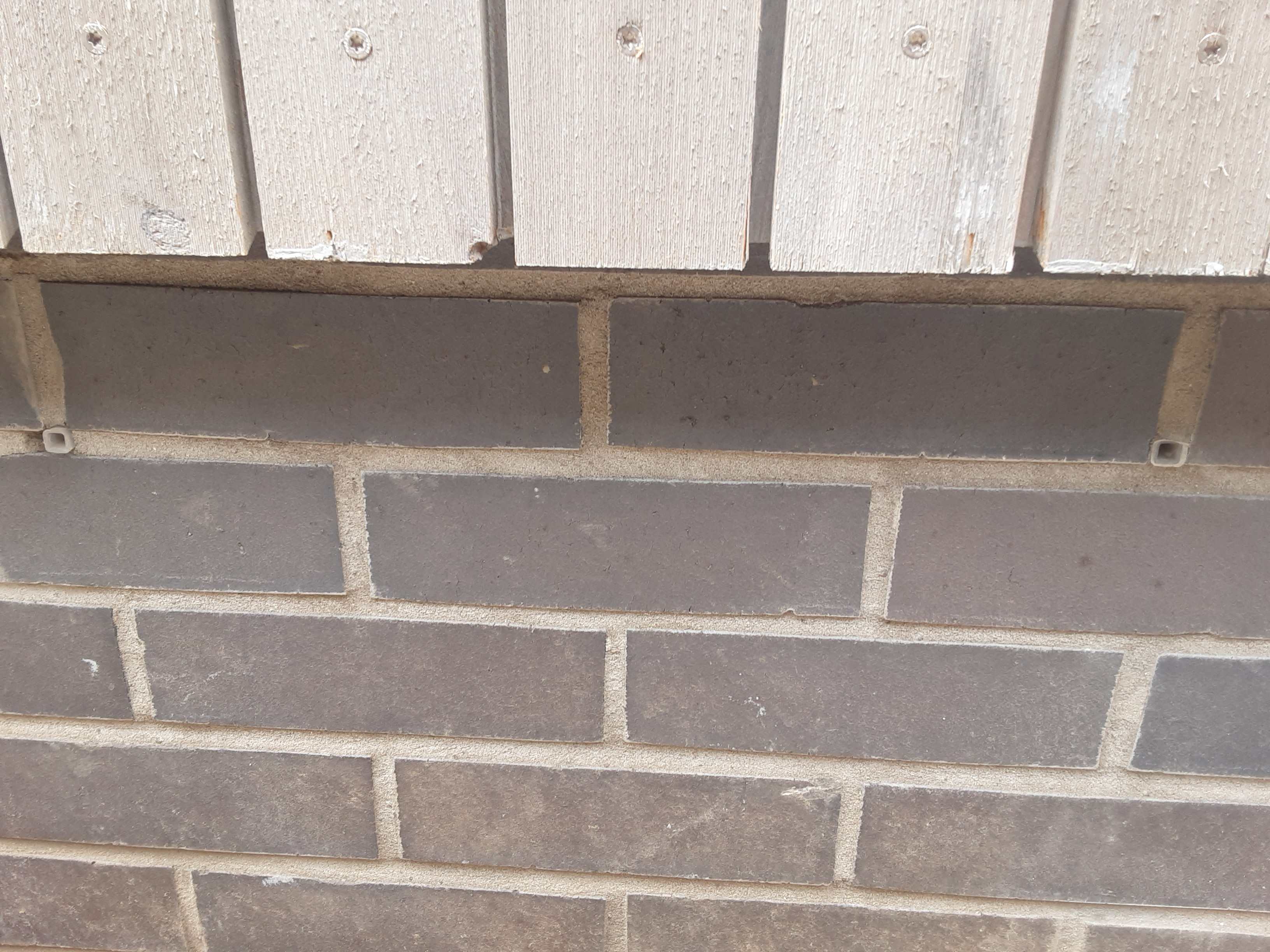

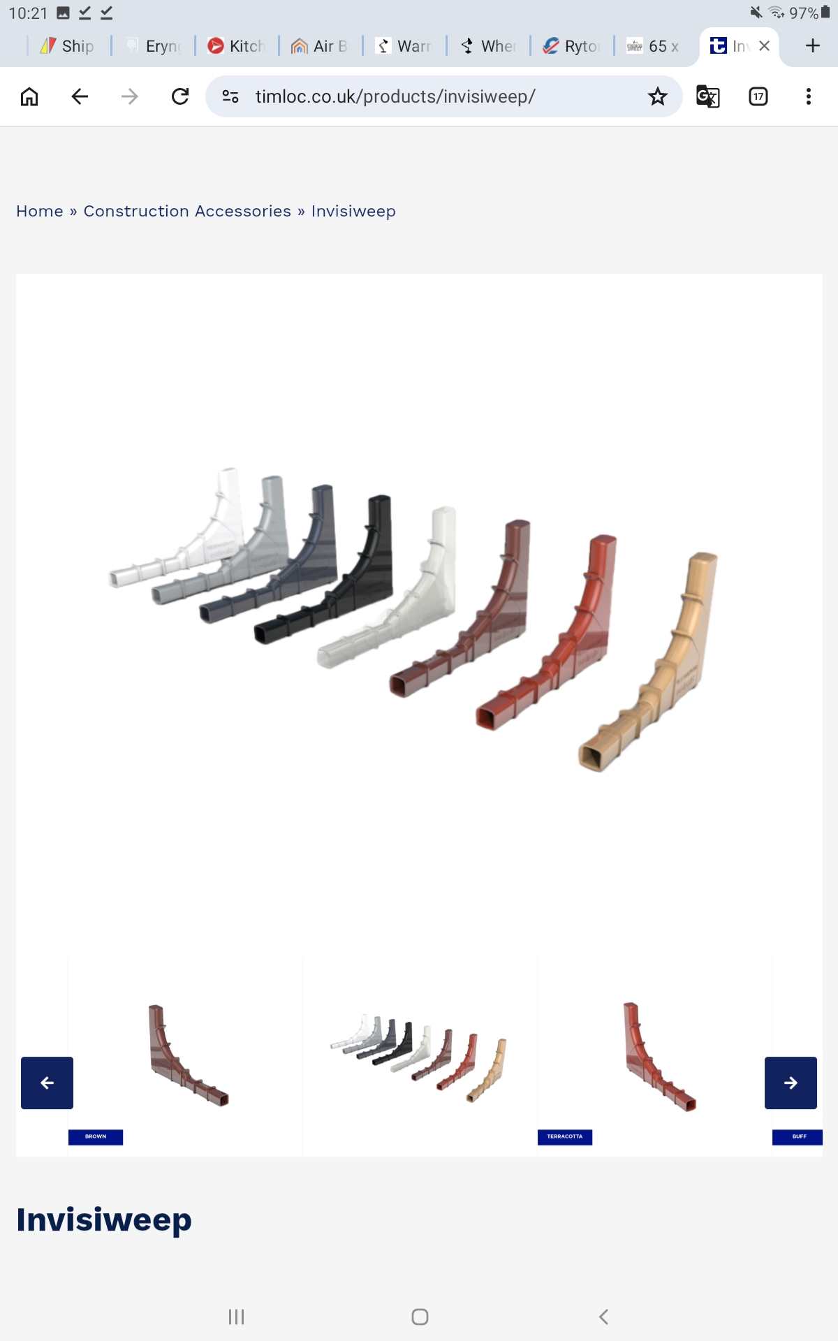

Do you want for looks? We've gone for weep holes, which are much less visible, even though there are lots of them, and vermin proof! (Uninsulated cavity between GF block skin round timber frame).
@Mr Punter - an 11-course brick plinth around the base of our Suffolk-barn-like structure, not load bearing, just for aesthetics - both for us and the planners.
@G and J - that's interesting, do you need to put mesh behind them to stop creepy crawlies?
We used these. Didn't mesh as will "deter" larger insects, not sure would stop determined ants but 🤞

The details supplied by @G and J quite rightly say 'For discharging water from external walls', which is what I have always understood. How many weep-holes would you need to equal the cross-sectional area of just one 'ordinary' air-brick? AI says: For most standard brick veneer or cavity walls, building codes and masonry councils recommend a weep hole cross-sectional area of at least 100 mm² to 250 mm². [1]
