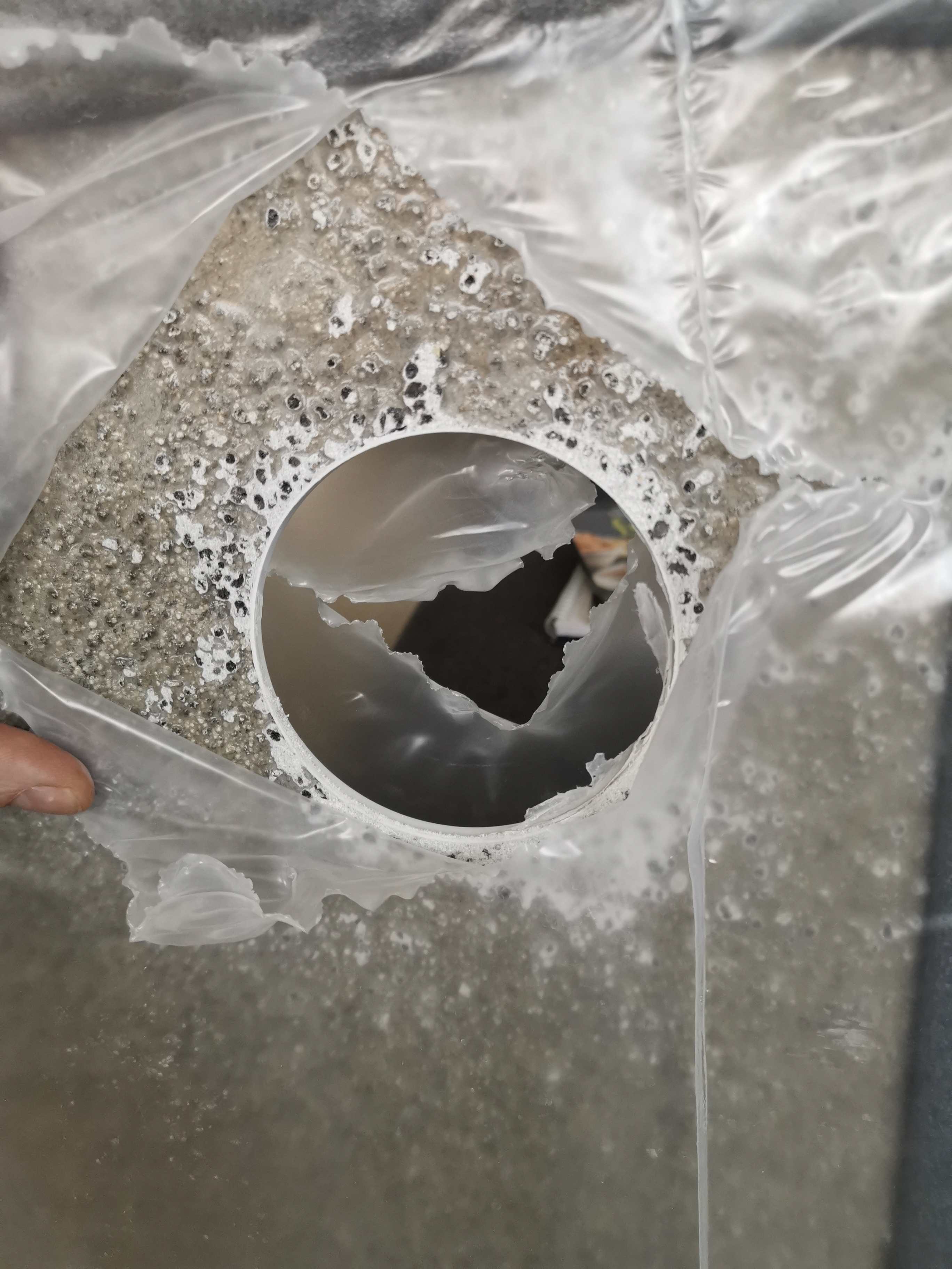

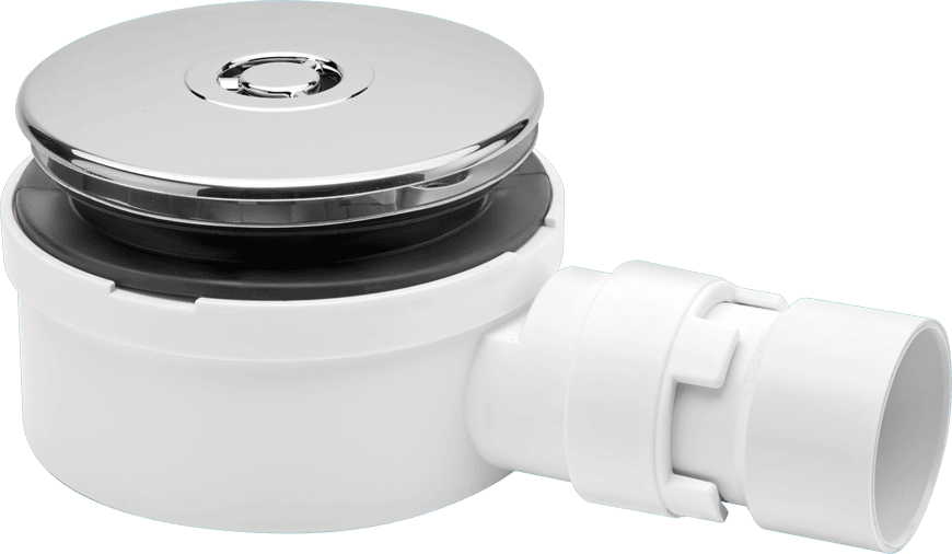

Shower tray from Victoria Plumbing. Under the waste is dog rough, will the seal be ok on this with enough CT1 on the rubber? Trap is McAlpine.
Actually it looks like this "alternative" flange that came with the McAlpine might make the underside a non-issue?
Yes, not an issue. Mine was like that, the waste seals on the top but plumbers put loads of silicone on the underside as well.

CT1 on the trap rim, add the seal, then a bolt load of CT1 on the seal to fill in all that irregularity. Then bring that up to the tray and screw the top clamp ring in bringing the 2 together? There's a top seal as well, not sure that's necessary.
Or use that "all in one" seal which came with it, described as "an alternative seal" that seems to traverse from top to bottom, essentially 2 seals joined together with a middle section, I'm sure you'd have seen them.
The trap is McAlpine low profile.

First off, NEVER use silicone for this, and always use a product such as CT1. Silicone has a very short life expectancy in comparison.
Usually the underside of the tray is ground down to a flat surface, waaaaaay better than that pic shows, but it’s not life or death.
As above the underside isn’t of paramount importance as the primary sealing is done at the top surface, but be sure to apply a smear of CT1 the top of the trap before tightening it up against the black rubber washer.
it seems pretty important in this instance, the trap doesnt have a screw in central funnel from top to bottom but looks more like it relies on the seals. The bottom seal looks like it does the brunt of the work to me? Id ditch the top seal and use CT1 I'd imagine as well, as I'd want it as low as possible in the recess.

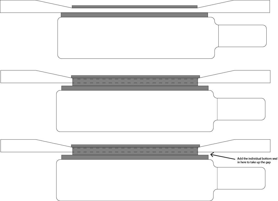

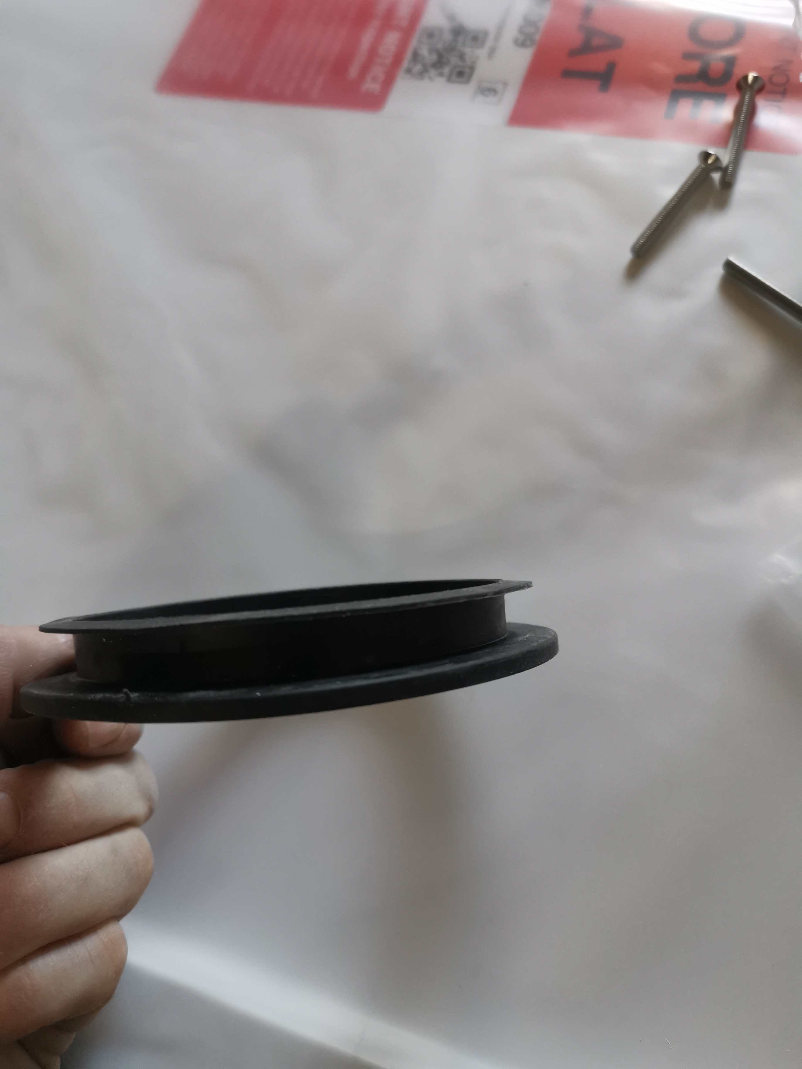

Which one are you fitting? The above is what I commented on, so are you using the two loose seals or the above?

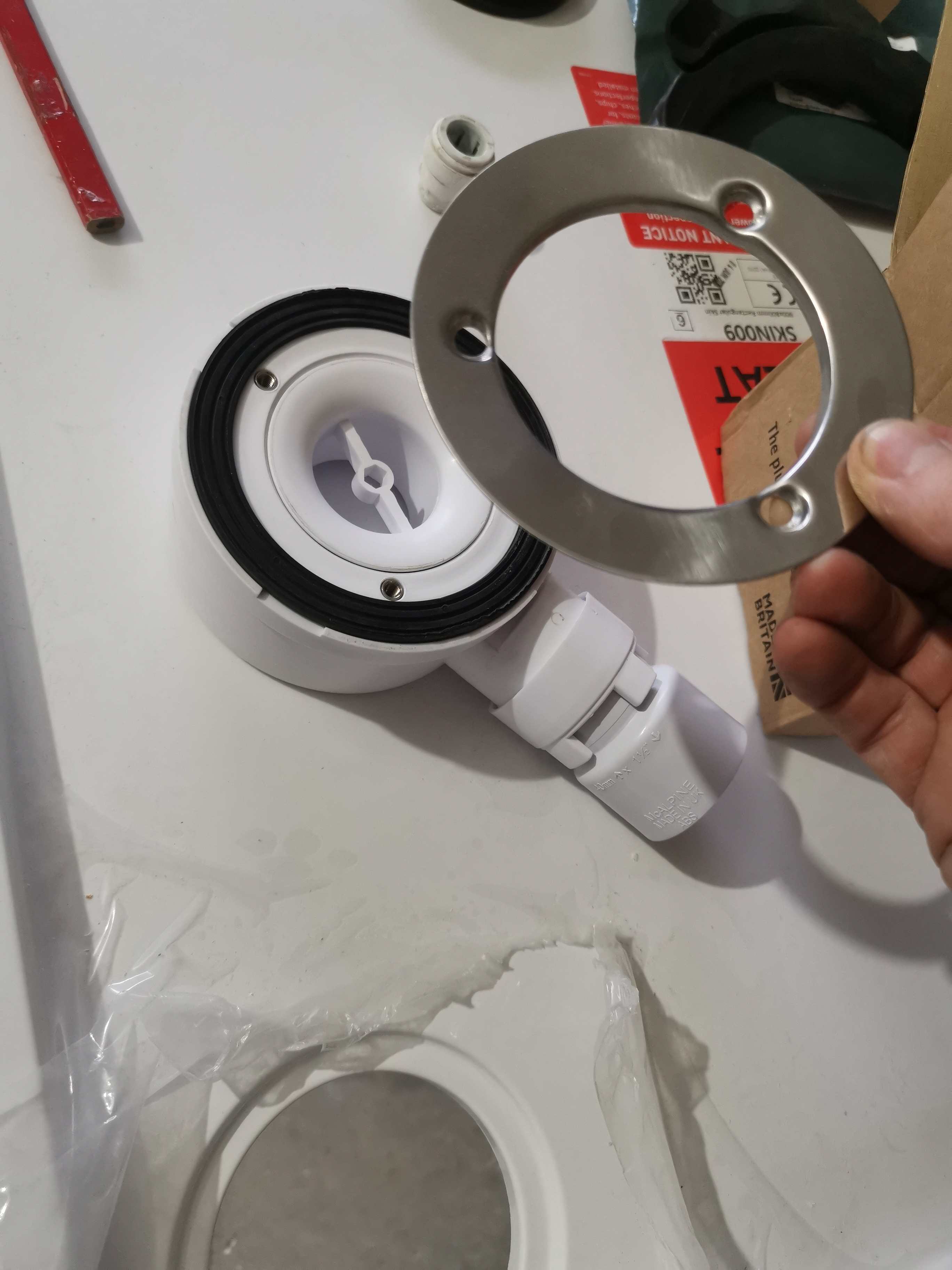

i guess im open to offers on which one... the "top hat" one is quite loose fitting around the middle shaft (too tall for the trays depth) unless i add in one of the additional seals underneath the bottom side it to pad it out.
So it comes with 3 seals, rough image attached.
  • The first 2 are i guess a set of one for the top and one for underneath.
  • The third one is the one in the picture above, the "all in one" described as "alternative seal H".
Bizarrely i cant find any real reference or pictures of the 2 seals, i wonder if they have stopped shipping the trap with the two options now, i got mine from ebay instead of off the shelf, could have been old stock but it is referenced in the paper manual that came with it as "alternative seal H".

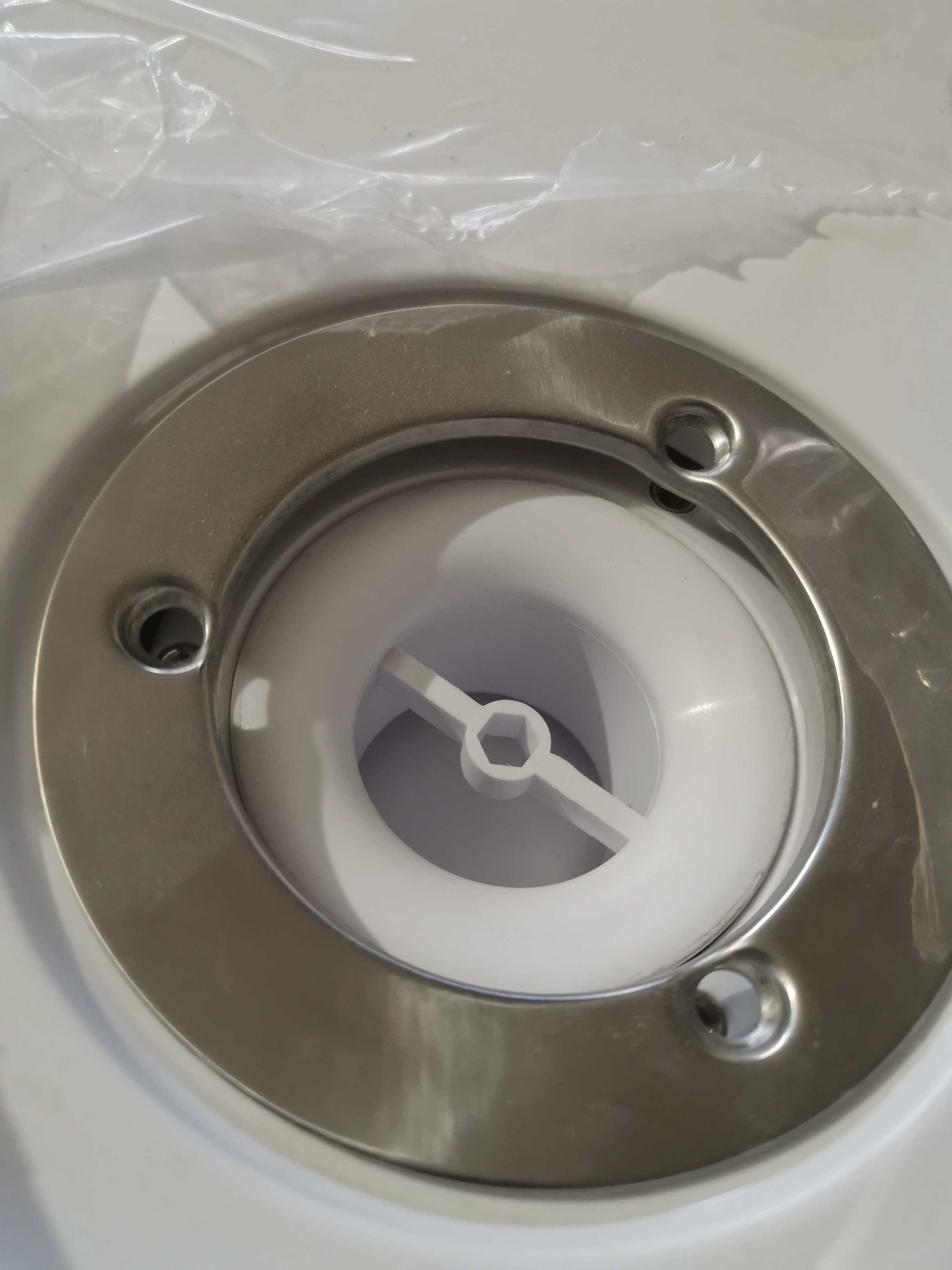

Ideally id not have a top seal at all to keep the flange as flat as possible but if i need it then so be it, being bombproof takes priority for this. To add further issues, the counter-sunk screw holes in the top metal flange obviously direct down over which means it doesnt drop in totally flat. Id have to file the tray away at the points the countersunk sections sit, just a few mm)
Edited by Super_Paulie
countersunk screws in flange fouling on tray mating surface. Use a file to take the tray down in these locations? only a few mm.

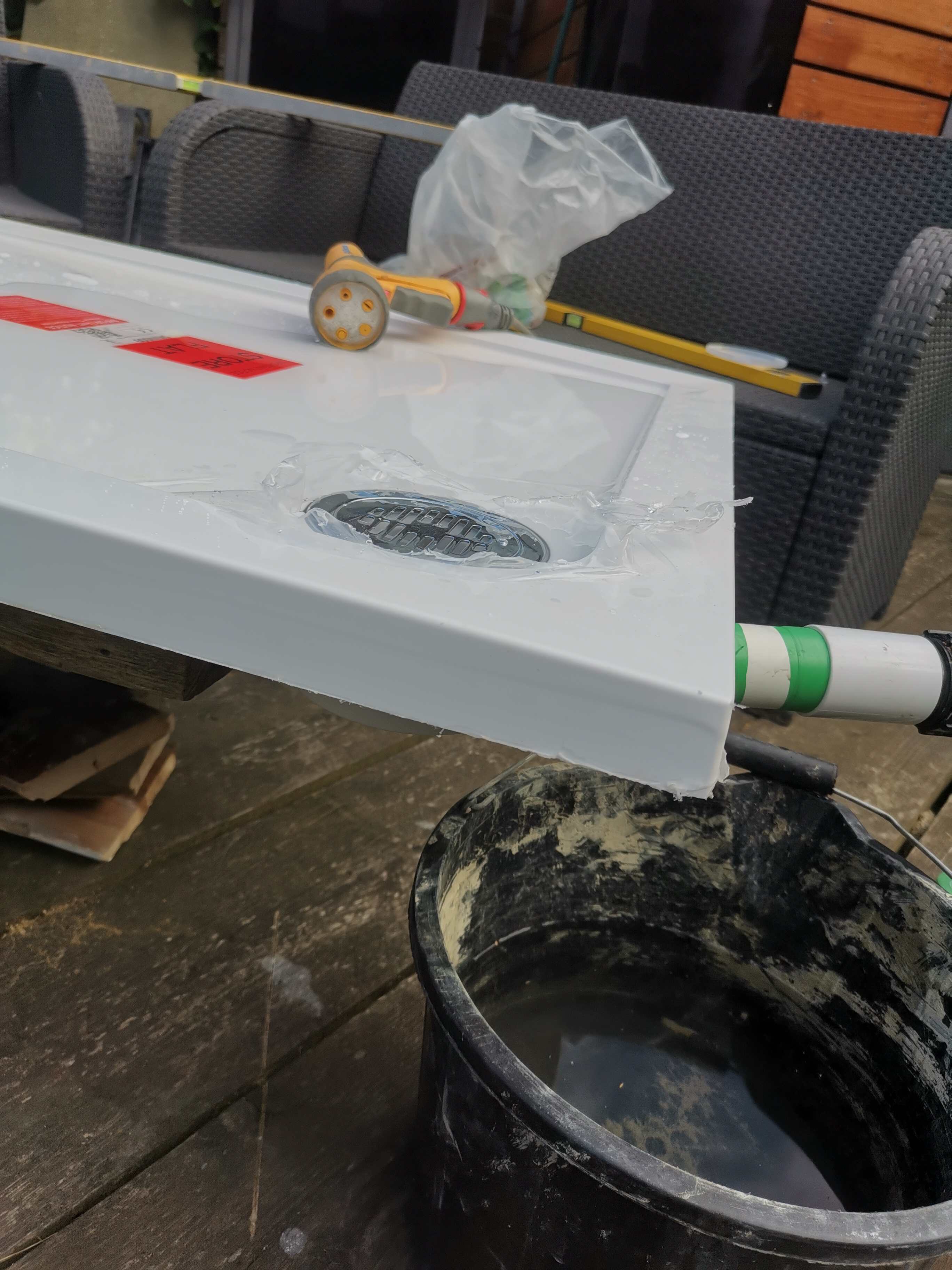

Proof is in the puddin, this thing isn't leaking even though it's under water.
Overthinking things as per.
Crack on and get it fitted boyo. 👍👌
Defo put a smear of CT1 on everything though, cheap insurance. Have cheap baby wipes to hand for clean up.
1 minute ago, Nickfromwales said:
cheap baby wipes
Sainsbury's own good enough for ya?
I smoothed our daughters tray underside, which was awful, with isopon and a piece of plate glass, dead flat, to ensure we had a perfectly flat surface to mate with the trap, seems to have worked - all done dry- no ct1 and no leaks 4 years on.
