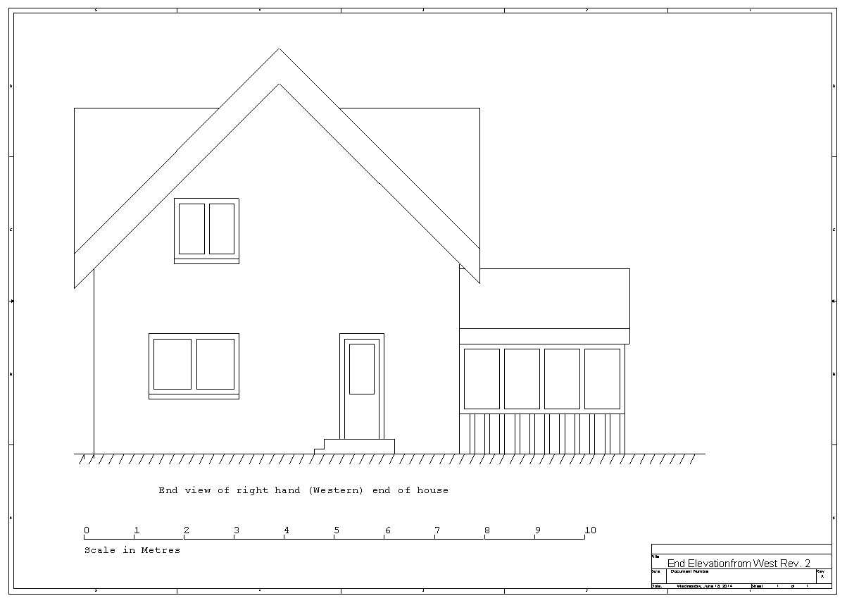

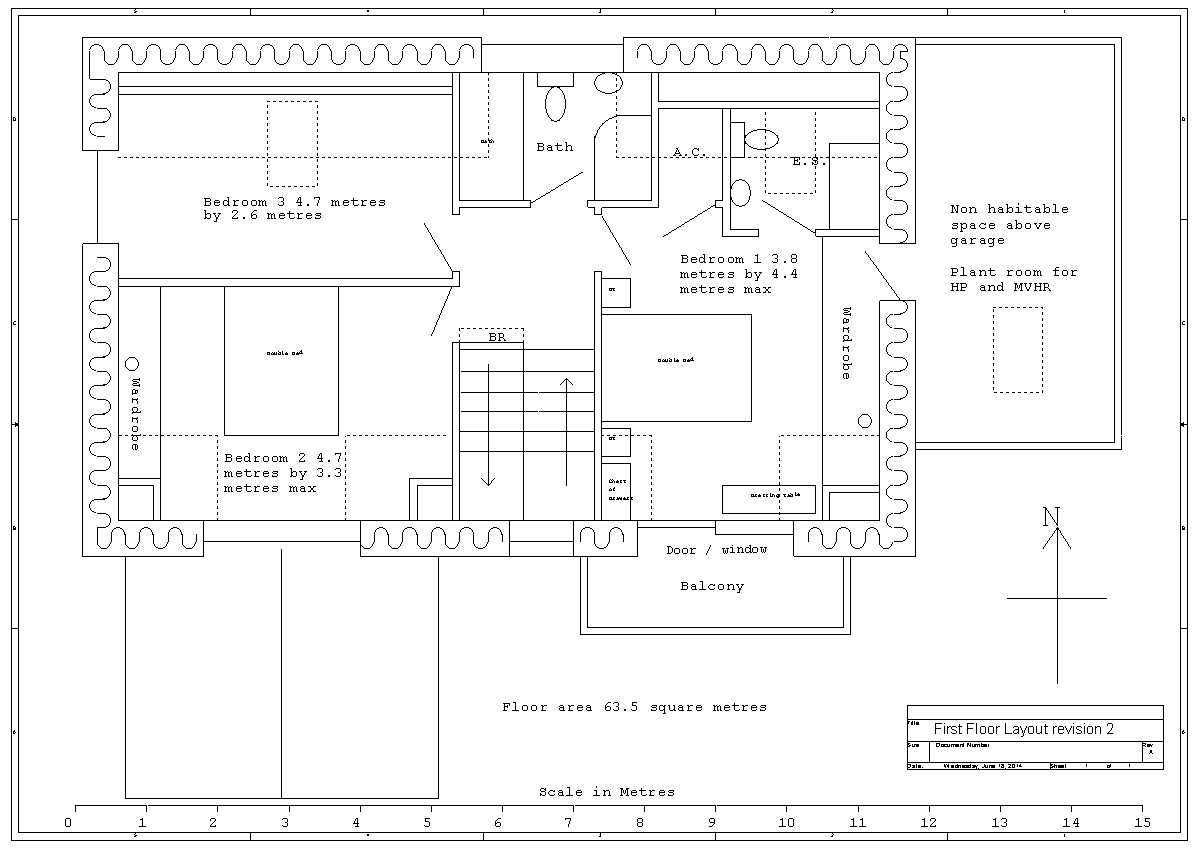

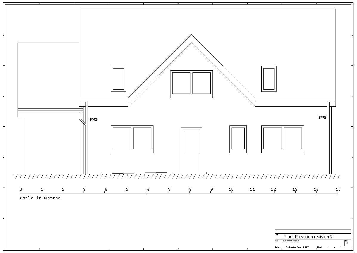

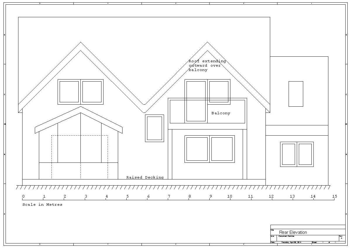

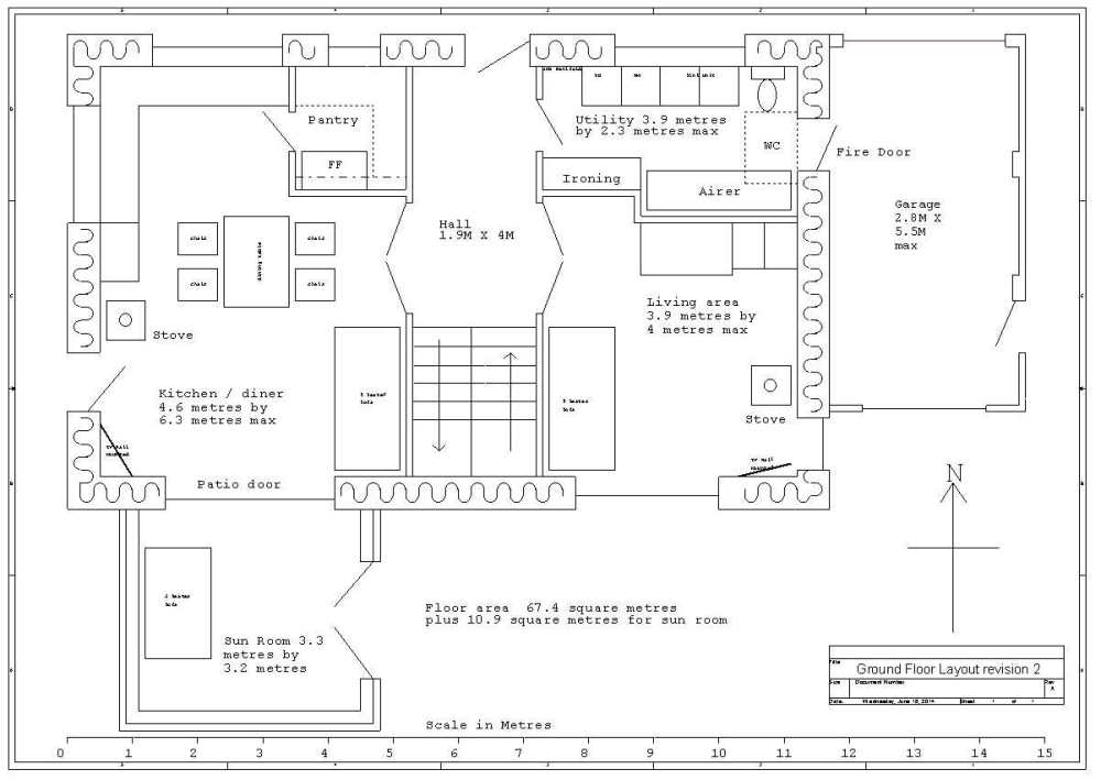

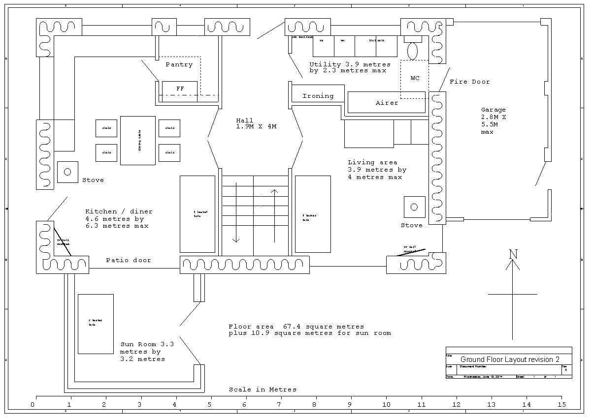

Square Feet Posted 4 hours ago Posted 4 hours ago As the title says @ProDave Do you have a floorplan for your house that you could share? I am looking to build a 150sqm, 1.5 storey house in Scotland so it seemed an obvious choice to have a peek at what you have built. I tried to look it up on your blog but it said the earlier posts weren't available. Asking in here rather than private message so that we can all see - feel free to message me if you don't want it out in public. Cheers
ProDave Posted 3 hours ago Posted 3 hours ago These are early drawings, a few things changed along the way but can't find final versions. 1
Square Feet Posted 3 hours ago Author Posted 3 hours ago @ProDave Brilliant, thank you. I will study them and let you know if I have any questions. Really appreciate it.

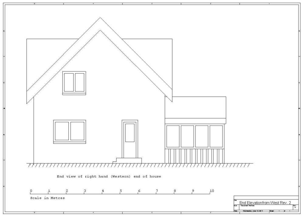

ProDave Posted 3 hours ago Posted 3 hours ago Those were my drawings for planning. A bit basic. A later more professional set were drawn later for the building warrant but I can't find them at the moment. 1
Square Feet Posted 3 hours ago Author Posted 3 hours ago No worries. I'm at the very early 'back of an envelope' stage of my design, so anything you can offer is really helpful. I had reckoned on 11x7m internal so it's very pleasing to see that's exactly what yours seems to be.
